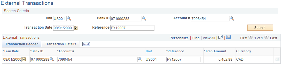

This example illustrates the fields and controls on the External Transactions page. You can find definitions for the fields and controls later on this page.
External Transactions page - Transaction Header tab
Search Criteria
To view a list of external transactions, enter your search criteria and click Search.
The External Transactions grid displays existing transactions that meet your search criteria.
A transaction is unavailable for edit if you have reconciled it.

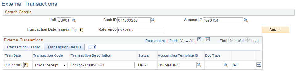

Transaction Details
Select the Transaction Details tab.
This example illustrates the fields and controls on the Transaction Details tab of the External Transactions page. You can find definitions for the fields and controls later on this page.
External Transactions page - Transaction Details tab
Field or Control Description
Tran Code (transaction code)
Indicates the type of transaction, such as fee or interest.
Accounting Template ID
Specify the accounting template that the system uses to generate the correct accounting entries.
VAT
Click to view information on the Treasury VAT Processing page. This link is available only when the transaction meets the following conditions:
  • The business unit is VAT enabled.
  • A VAT-enabled transaction code is defined for the transaction type (currently limited to fee, F).
  • A VAT-enabled accounting template is defined for the accounting template.
