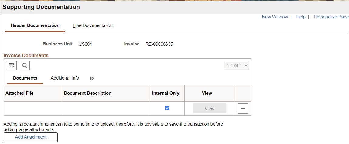

Header Documentation Page
Use the Header Documentation page (BI_HDR_ATTACH) to upload, detach, and view supporting documentation attached to a bill header.
Navigation:
Billing, and then Maintain Bills, and then Supporting Documentation, and then Header Documentation
This example illustrates the fields and controls on the Header Documentation page.
Supporting Documentation - Header Documentation

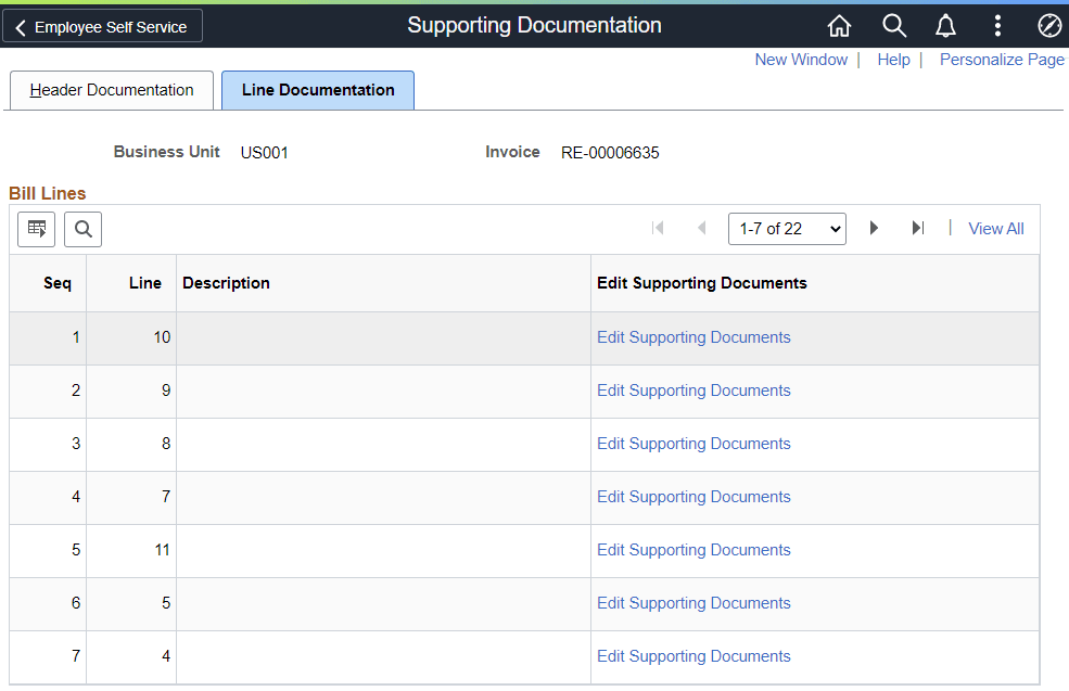

Line Documentation page
Use the Line Documentation page (BI_LINE_ATTACH) to view a list of bill lines.
Click the Edit Supporting Documents link to manage attachments.
Navigation:
Billing, and then Maintain Bills, and then Supporting Documentation, and then Line Documentation
This example illustrates the fields and controls on the Line Documentation page.
Supporting Documentation - Line Documentation
