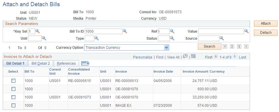

Attach and Detach Bills Page
Use the Attach and Detach Bills page (BI_CONS_ATTACH) to attach bills or detach them from the consolidated bill header.
Navigation:
Billing, and then Maintain Bills, and then Attach and Detach Bills
This example illustrates the fields and controls on the Attach and Detach Bills page. You can find definitions for the fields and controls later on this page.
Bill Search Criteria
Field or Control Description
Key Sel (key selection)
The primary selection criteria. The selection in this field determines the values that are available in the other search fields and the invoices that are returned. For instance, to see all the invoices with the contract number of CON-00020, select Contract from the available options in this field and CON-00020 from the available options in the Bill To ID field.
Search
Click this button, and then select a value from the available options in the Invoices to Attach or Detach group box. Invoices that meet the specified criteria appear in the lower portion of the page.
The other fields on this page enable you to narrow the list of returned invoices. A blank value indicates a wildcard and displays bills with any value in this field. All standard wildcards are supported by PeopleSoft Billing search engines.

The status of the results—that is, the number of rows retrieved by the search—appears on the page. The number of rows is expressed in the following format: X To Y Of Z
Z is the total number of rows that meet the search criteria, and X and Y refer to the rows that appear in the query chunk.
Use the scroll bar to scroll through the rows of bill header data. If you do not find the bill that you want but additional rows exist, click the Get Next Chunk button to obtain the next chunk of data.
Bill Selection
All bills that satisfy the search criteria appear within the scroll area at the bottom of the page. Note that only bills with a transaction currency that matches the transaction currency of the consolidated invoice are selected for this function.
The columns that appear are:
Select
Click to select a bill for attachment or detachment.
Bill To
Displays the bill-to customer number.
Invoice Amount
Displays the pretax invoice amount total.
Bill Detail
Click to access the Bill Header Detail page, where you can view a summary of all the possible field values for each bill.
The open field with a drop-down arrow is a dynamic column containing a series of fields. Select a field and the system returns all the values in that field for each of the bills that are listed. For instance, if you select Media, the system returns the media value for each of the bills. You can change the field selection at any time during the display without having to rerun the query. Select from the available field values:
