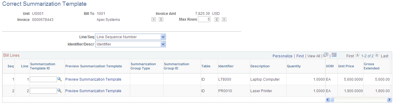

Use the Correct Summarization Template page (BI_SUM_IVC_LN_COR) to add, change, or remove the assignment of summarization templates for lines of bills that have been finalized.

This example illustrates the fields and controls on the Correct Summarization Template page. You can find definitions for the fields and controls later on this page.

Field or Control Description
Max Rows (maximum rows)
Select how many bill lines to display on the Summarize Template Correct page.
Line/Seq (line/sequence)
Select whether to view bill lines by line number or sequence number.
Identifier/Desc (identifier/description)
Select whether to display the Identifier field or the Description field for the bill lines.
Summarization Template ID
Set the desired summarization template for a bill line. Clear the field and leave blank to remove the assignment of a template to a line.
Preview Summarization Template
Click the Preview Summarization Template link to preview the summarization template format. The page does not use actual bill data.
Summarization Group Type
The summarization group type set for the line. This value cannot be changed after finalization.
Summarization Group ID
The summarization group set for the line. This value cannot be changed after finalization.
You can also correct the bill fields that affect the line grouping to achieve the desired summarization on the printed invoice.
