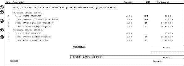

The following figure shows an example of a summarized invoice. A summarized invoice groups activity by purchase order and summarizes activity by item type. All lines related to a purchase order are displayed together, and any lines for the same item within that purchase order group are aggregated as a single invoice line.
An excerpt from a summarized invoice
The circled numbers in the example call out the following summarization template elements:
  1. Summarization note
  2. Summarization group headings
  3. Summarized lines
In the previous example, the PO_REF field was used for grouping, and the IDENTIFIER field was used for summarization. Multiple fields can be combined for both grouping and summarization purposes. Only lines with the same summarization template will be grouped and summarized together.
