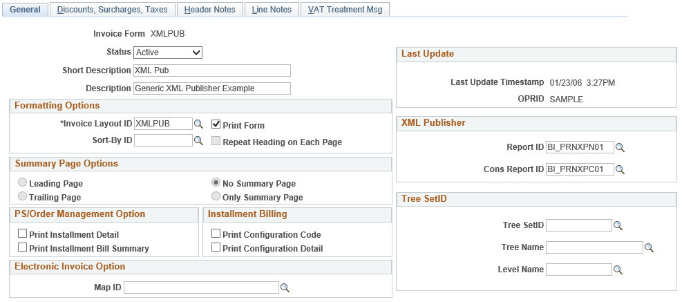

Invoice Formatting Options - General Page
Use the Invoice Formatting Options - General page (BI_FORMAT_GENERAL) to create a new layout format or review existing layout formats.
Navigation:
Set Up Financials/Supply Chain, and then Product Related, and then Billing, and then Setup Invoice Options, and then Invoice Formatting Options, and then General
You can define as many layout formats as you need.
Most of the format options are used only by SQR invoice forms. If the layout format uses a BI Publisher layout ID, only applicable options are enabled. In addition, if the Print Form option is not selected, none of the printing options will be enabled.
This example illustrates the fields and controls on the Invoice Formatting Options - General page. You can find definitions for the fields and controls later on this page.
Last Update
Displays the date and time that the invoice form was last updated, as well as the user ID who performed the update.
Formatting Options
Select the invoice layout ID, whether the format is used in print mode, the sort by identifier, and whether headings are repeated for this invoice form.
Field or Control Description
Invoice Layout ID
Select an invoice layout ID from the following options:
  • Extract - Generic extract layout. Select this option for all bills that require regular or consolidated processing.
  • CA51 - Contract detail layout.
  • GM_103X - PeopleSoft Grants 1034 and 1035 layout.
  • GM_270 - PeopleSoft Grants OMB-270 layout.
  • GM_GEN - PeopleSoft Grants general invoice layout.
  • PSA51 - Layout by project and employee.
  • PSA52 - Layout by project, activity, and employee.
  • PSA53 - Project detail layout.
  • PS_CA - PeopleSoft Contracts layout.
  • SF1080 - Standard federal form 1080.
  • SF1081 - Standard federal form 1081.
  • LANDSCAPE - Landscape orientation layout.
  • MISC - Miscellaneous portrait layout.
  • ORDERMGMT - PeopleSoft Order Management layout. Select this option for a bill containing sales order information.
  • PORTRAIT - Portrait orientation layout.
  • PS_PC - Project Costing with contract totals layout. Select this option for a bill with project and contract-related information.
  • RIGHTSTUB - Right stub layout. Select this option to print full invoice information on the main part of the invoice and summary information on the right side of the invoice. Customers can tear off the stub and return it with their payments.
  • XMLPUB - Select to use the BI Publisher forms, which are determined in the BI Publisher group box.
  • XP_SF103X - Provides a BI Publisher rendering of the standard form 1034/1035 for federal invoices.
Note: To add a new invoice layout ID, you must add supporting logic to one of the printing programs.
Print Form
Select if you want to use the format in Print mode. This option must be selected to enable the other printing options.
Note: If this option is not selected, invoices using this format will not be printed.
Sort-By ID
Select a value for the system to sort by for this format.
BI Publisher
These are required fields if XMLPUB is selected in the Invoice Layout ID field. The XML templates are defined on the PeopleTools Report Definition page.
Report ID
Select the report ID that identifies the template for nonconsolidated invoices.
Cons Report ID (consolidated invoices report ID)
Select the report ID that identifies the template for consolidated invoices.
Summary Page Options
If you select Print Form, also define how you want the summary page to print. Options are:
  • Leading Page
  • Trailing Page
  • No Summary Page
  • Only Summary Page
Tree SetID
If you select either GM_103X or GM_GEN in the Invoice Layout ID field, select a tree SetID, tree name, or level name. You cannot select a level name unless you select a tree that has level names associated with it. Based on the tree level that you select, these options define the level of detail that you display on an invoice.
Using trees, the PeopleSoft Grants process for printing bills enables you to summarize bill line detail.
PS/Order Management Option
If you have PeopleSoft Order Management installed and you want to print configuration codes on invoices, select the Print Configuration Code option. If you want to print configuration details on invoices, select the Print Configuration Detail option.
Installment Billing
Detailed information about the invoice, such as item description and unit of measure, is included on the first of the installment bills. Select Print Installment Detail to include a breakdown of the installment billing invoice amounts on all installment invoices.
Select Print Installment Bill Summary to include an Installment Bill Summary invoice.
Electronic Invoice Option
Map ID
Select a DEIU map ID to generate the electronic invoice. Each invoice form is related to a specific DEIU map ID that defines the details of the electronic invoice file.
Access the Map Definition page (Set Up Financials/ Supply Chain, Common Definitions, Data Export Import Utility, Map Definition) to add DEIU maps. The following sample DEIU maps are delivered: EIVC_UBL2, EIVC_UBL21, EIVC_SPN, EIVC_NLD and EIVC_FRA. You can customize based on your business needs.
