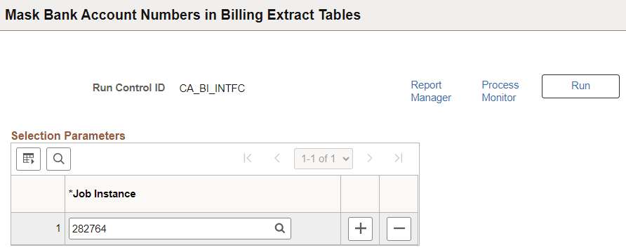

This example illustrates the fields and controls on the Mask Bank Account Number in Billing Extract Tables page.
Mask Bank Account Numbers In Billing Extract Tables
Field or Control Description
Job Instance
Enter the job instance number(s) for non-successful job instances that contain the Invoice Extract process.
