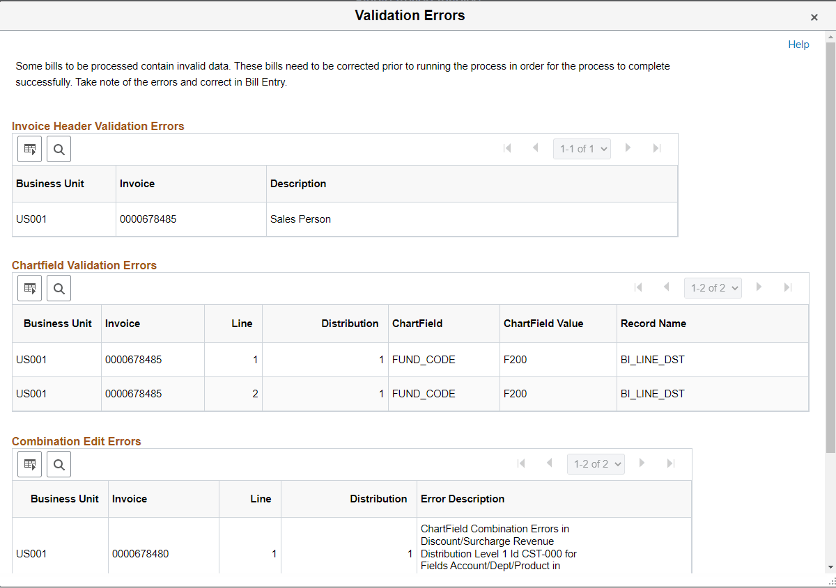

Validation Errors Page (Finalize and Print, and Single Action Invoice)
Use the Validation Errors page (BI_RUN_CTL_VAL_SBP) to verify inactive and invalid data from the bill header and distribution lines as well as combination edit rule errors.
Navigation:
From the Finalize and Print or the Single Action Invoice pages, select the Validate button.
This example illustrates the fields and controls on the Validation Errors page.
Validation Errors (Finalize and Print, and Single Action)
When selecting the Validate button, the Validation process verifies that the header data is valid and that all ChartFields entered are active. If inactive or invalid data is found, the system displays the Validation Errors page.
In addition, combination edits are performed by calling application engine job BICOMBO1. If combination edit errors are found, the system displays them on the Validation errors page.
Validation steps:
  1. When you select the Validate button, but before running the process, the system checks to see how many bills and bill lines are selected.
    • If more than 50 bills, or 100 lines are selected, the system displays a message to allow you to cancel the process. This is due to the amount of time it may take to run the process. If you want to reduce the number or bills or lines, select Cancel and change your run parameters.
    • If less than 50 bills, or 100 lines are selected, the system continues to step 2.
  2. The system runs the Validation process:
    • If validation errors exist, the Validation Errors page appears
      You must go back to the Bill Entry page to correct the invalid data.
    • If all data is valid, the system displays a message saying, "No invalid data was found."
The following grids only appear when an error is found in that area:
  • The Invoice Header Validation Errors grid displays inactive data. See Understanding Validations for the data that is validated on the bill header.
  • The ChartField Validation Errors grid displays invalid ChartField data from Distribution Lines. See Understanding Validations for the ChartFields that are not validated.
  • The Combination Edit Errors grid displays combination edit errors. These errors are actually the combination edit rules that are in error.
    The Error Description column displays the combination edit rule that is in error.

  9. Click the Bills To Be Processed button to access the Bills To Be Processed page, where you can view a summary of the bill or group of bills in the range selection to be processed.
  10. Click Run.
