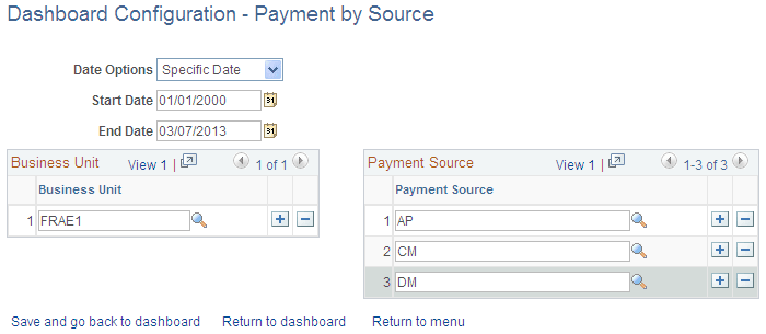

Dashboard Configuration - Payment by Source Page
Use the Dashboard Configuration - Payment by Source page (TR_DASH_02_CFG) to configure the payments charts
Navigation:
Treasury Dashboards
Click the Payments link or, after displaying the charts, click the Update Configuration link on the Treasury Dashboards page.
This example illustrates the fields and controls on the Dashboard Configuration - Payment by Source page.
Field or Control Description
Date Options
Select one of these values.
  • Today
    Payments by source display on the chart based on your system's current date.
  • Specific Date
    Select this option and the Start Date and End Date fields are enabled. Select the start and end dates to which the payment data applies.
Business Unit
Select one or more business units to which the payment data that appears on the dashboard applies.
Leave this field blank and the system will display payment data on the dashboard for all business units in your system.
Payment Source
Select one or more payment sources to which the payment data that appears on the dashboard applies.
Leave this field blank and the system will display payment data on the dashboard for all payment sources.
