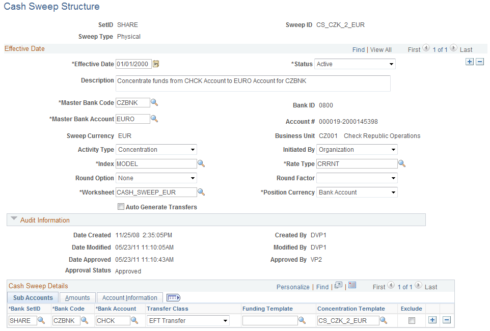

Cash Sweep Structure Page
Use the Cash Sweep Structure page (CSH_SWEEP_DEFN) to define the master bank account, currency, and cash position worksheet for a physical cash sweep.
Set up cash sweep sub-accounts.
Navigation:
Cash Management, and then Cash Sweep, and then Define Cash Sweep Structure, and then Cash Sweep Structure
This example illustrates the fields and controls on the Cash Sweep Structure page. You can find definitions for the fields and controls later on this page.
Field or Control Description
Sweep ID
Select the appropriate SetID and enter a value to identify the cash sweep structure that you are creating on the Cash Sweep Structure search page.
Sweep Type
Accept the system-defined default value, Physical on the Cash Sweep Structure search page. A physical cash sweep indicates movement between external bank accounts selected for this cash sweep structure.
Master Bank Code
Select the bank that has the master bank account that you want to assign to this cash sweep structure. The Bank ID field is updated based on the code you select.
Master Bank Account
Select the bank account that you want to use to transfer funds to subaccounts or to concentrate funds from subaccounts. The Bank Account # (number), Sweep Currency, and Business Unit values associated with the selected bank account appear as defaults on the page and are derived from the account selected as the master bank account. This business unit is used as the anchor business unit when the cash sweep transfers are performed.
Activity Type
Select one of these activity types to move funds for this cash sweep structure. This field is required for both organization and bank initiated cash sweeps.
  • Bi-Directional
    Moves funds into and out of the master bank account depending on the of the calculated transfer amount. If the cash position of the sub-account is negative, Cash Sweep assumes that here is a shortage of funds in the sub-account and moves funds from the master bank account to the sub-account. If the cash position of the sub-account is positive, Cash Sweep assumes that there is a surplus of funds and moves funds from the sub-account to the master bank account. Negative balances in subaccounts are Funded and positive balances in sub-accounts are Concentrated.
  • Concentration
    Moves funds out of subaccounts to the master bank account.
  • Funding
    Moves funds out of the master bank account to the sub bank accounts.
Initiated By
Select one of these values as the initiator of the cash sweep.
  • Organization
    Indicates that your organization will create the bank transfers and EFT requests.
  • Bank
    Indicates that the bank will make the fund movement. The accounting comes from the bank statement. The system only stores the recommended transfer amounts, and does not create the actual EFT requests or bank transfers.
Auto-Generate Transfers
Select this check box to enable the system to automatically generate EFT (electronic file transfer) requests and bank transfers for the recommended transfer amount when you run the Cash Sweep process.
If you deselect this check box, then you must access the Cash Sweep Results page to initiate the creation of EFT requests and bank transfers.
Index
Derived from the selected master bank account . Selecting a market rate from the market rate index assists in identifying the exchange rate to apply to the cash sweep when the cash sweep currency is different from the cash position currency.
Rate Type
Derived from the selected master bank account. Selecting a rate type assists in identifying the exchange rate to apply to the cash sweep when cash sweep currency is different from the cash position currency.
Round Option
Select one of these options to determine how you want to round the transfer amount:
  • Nearest
    Rounds either up or down to the nearest round factor.
  • None
  • Round Down
  • Round Up
Round Factor
Select one of these options to determine how the amount will be rounded.
  • 1
  • 1,000,000
  • 10,000
  • 10
  • 10,000
  • 10,000,000
  • 100
  • 100,000
Note: The Round Factor is required unless the value selected for the Round Option is None.
Worksheet
Select a forecasting worksheet definition to associate with this cash sweep. The selected worksheet definition is used by the cash sweep process to retrieve data from cash position tables.
Note: Use a designated worksheet with only one source set. Multiple source sets are allowed on a worksheet definition, but in the case of cash sweep, worksheets with only one source set should be used.
Position Currency
Select a position currency to apply to this cash sweep.
  • Bank Account: Use this option to select the currency associated with the master bank account.
  • Worksheet: This option indicates that you want to use the default reporting currency shown on the worksheet definition that you selected in the Worksheet field.
Note: You select a market index and rate type to assist in identifying the exchange rate to apply to the cash sweep when the bank account currency is different from the position currency. Make sure that the Exchange Rate tables are updated with the appropriate exchange rates.
Audit Information
The system tracks and displays this information about a selected cash structure:
  • Date Created
    Identifies when the cash sweep structure was created.
  • Created By
    Identifies the user who created the cash sweep structure.
  • Date Modified
    Identifies the last date that the cash sweep structure was modified.
  • Modified By
    Identifies the last person who modified the cash sweep structure
  • Date Approved
    Identifies the date that the cash sweep structure was approved.
  • Approved By
    Identifies the user who approved the cash sweep structure.
  • Approval Status
    Identifies the cash sweep structure as Pending, Approved, or Denied.
Cash Sweep Details – Subaccounts Information
Select the Cash Sweep Details – Sub Accounts tab.
Bank SetID, Bank Code and Bank Account
Select a bank SetID, bank code, and bank account for each subaccount that you set up for this physical cash sweep structure.
Transfer Class
Select one of these values to transfer the physical cash sweep amount.
  • EFT Transfer
  • Bank Transfer
Note: You must select one of these values if you selected Organization as the Initiator of the physical cash sweep on the Cash Sweep Definition page.
Funding Template
Select a funding template if you selected either Funding or Bi-Directional as the Activity Type on the Cash Sweep Definition page. If you selected Bank Transfer as the Transfer Class, the system only displays a list of external bank account funding transfer templates.
Concentration Template
Select a concentration template if you selected either Concentration or Bi-Directional as the Activity Type on the Cash Sweep Definition page. If you selected Bank Transfer as the Transfer Class, the system only displays a list of external bank account transfer templates.
Note: You must select the funding and concentration templates that are set up for the purpose of performing a cash sweep and are appropriate for the cash sweep structure that is being defined, otherwise the system may generate incorrect transfers.
Exclude
Select this check box to exclude the sub-account row for which it is selected from being included in the cash sweep process.
Cash Sweep Details – Amount Information
Select the Cash Sweep Details – Amount tab.
Minimum Transfer Amount
Enter the minimum amount to be transferred during a cash sweep process between the master bank account and a sub-account.
A zero minimum amount indicates that there is no limit to the minimum transfer amount regardless of the activity type selected on the Cash Sweep Definition page.
However if the calculated transfer amount is less than the minimum transfer amount, these rules apply:
  • When the activity type is Funding and the calculated transfer amount is less than the minimum transfer amount, the Cash Sweep process sets the calculated transfer amount to the minimum transfer amount.
  • When the activity type is Concentration and the calculated transfer amount is less than the minimum transfer amount, the Cash Sweep process sets the calculated transfer amount to zero. There are not enough funds in the sub-account to meet the minimum transfer amount and still maintain its target balance, so no amount is set to transfer.
Maximum Transfer Amount
Enter the maximum amount to be transferred during a cash sweep process between the master bank account and the subaccount.
A zero amount indicates that there is no maximum amount limit.
The maximum transfer amount rule is when you select either Funding or Concentration as the activity type on the Cash Sweep Definition page. When you run the Cash Sweep process, if the calculated transfer amount is greater than the maximum transfer amount, then the calculated transfer amount is set to the maximum transfer amount for both activity types.
Sweep Currency
The default currency that appears in this field is derived from the Master Bank Account.
Cash Sweep Details – Account Information
Select the Cash Sweep Details – Account Information tab.
This grid defines the bank account details for each sub-account including the Bank ID, the Bank Account # (bank account number) as well as the bank account's currency, associated business unit, and description.

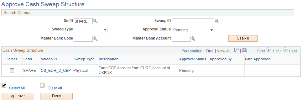

Approve Cash Sweep Structure Page
Use the Approve Cash Sweep Structure page (CSH_SWEEP_APPR) to approve or deny selected cash sweep structures.
Navigation:
Cash Management, and then Cash Sweep, and then Approve Cash Sweep Structure, and then Approve Cash Sweep Structure
This example illustrates the fields and controls on the Approve Cash Sweep Structure page. You can find definitions for the fields and controls later on this page.
Search Criteria
Select values for the search criteria fields as needed. If you only select a SetID and leave all other fields blank, the system will list all of the Cash Sweep Structures that have a status of Pending, Approved, and Denied when you click the Search button. You can also select an approval status of Pending, Approved, or Denied and only cash sweep structures with the selected approval status appear on the list when you click the Search button.
A list of cash sweep structures appears in the Cash Sweep Structure group box based on you selected search criteria. You can select all of the structures in the list or select individual structure check boxes and click the Approve or Deny button to approve or deny the selected cash sweep structures.
Cash Sweep ID
Click the link of an individual cash sweep structure and access the actual cash sweep structure.
Approval Status
These values can appear in this field:
  • Pending
    This value appears for a cash sweep structure that has never been approved or has been modified after approval or denial.
  • Approved
    This value appears when an authorized approver clicks the Approved button on this page.
  • Denied
    This value appears when an authorized approver clicks the Denied button on this page.
