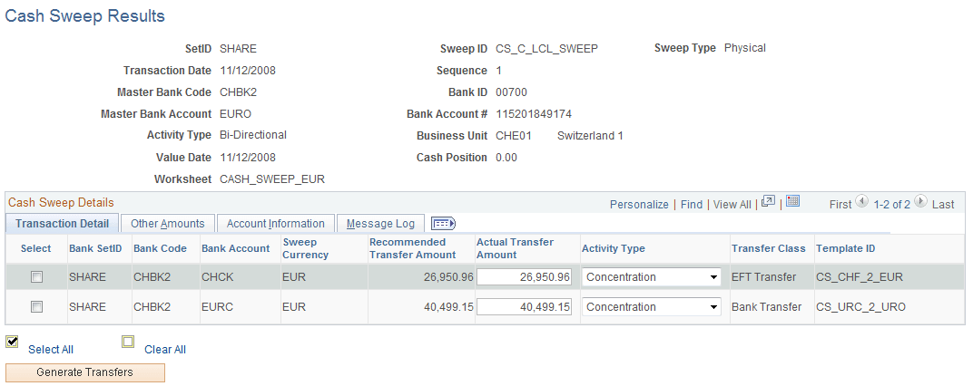

This example illustrates the fields and controls on the Cash Sweep Results page – Transaction Detail tab. You can find definitions for the fields and controls later on this page.

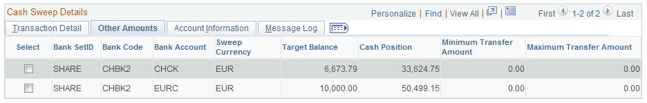

This example illustrates the fields and controls on the Cash Sweep Results page – Other Amounts tab. You can find definitions for the fields and controls later on this page.
Cash Sweep Results page - Other Amounts tab

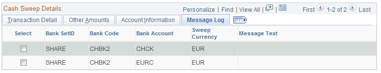

This example illustrates the fields and controls on the Cash Sweep Results page – Message Log tab. You can find definitions for the fields and controls later on this page.
Cash Sweep Results page - Message Log tab

Select
This check box will only appear if the funds transfer still need to be generated, which means that the Auto Generate Transfers check box was not selected on the Cash Sweep Structure page of the associated cash sweep structure.
Generate Transfers
Click this button to generate either a bank transfer or an EFT request for the selected rows. Generating a bank transfer will update the Transfer ID field on the Transaction Detail tab with the Bank Transfer ID, and generating an EFT request will update the Transfer ID field with the EFT Request ID.
Transaction Detail Tab
Field or Control Description
Recommended Transfer Amount
After comparing the minimum and maximum transfer limits, the Cash Sweep Calculations process adjust the transfer amount as necessary, sets this final recommended transfer amount and updates this field.
Actual Transfer Amount
The default value is the amount that appears in the Recommended Transfer Amount field. You can override the this default amount and perform the transfer.
Activity Type
Displays either Funding or Concentration at the grid level for a bidirectional cash sweep structure.
Note: A bidirectional cash sweep structure enables you to override the activity type on the subaccount grid. This provides you with the flexibility to change the direction in the movement of funds and override the actual transfer amount.
Other Amounts Tab
Target Balance
The Cash Sweep Calculations process retrieves the target balance and updates this field.
Cash Position
The Cash Sweep Calculations process retrieves the cash position for each subaccount and updates this field.

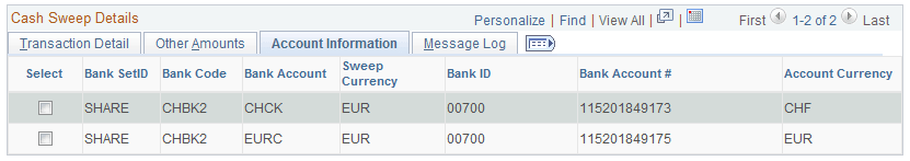

Account Information tab
This tab displays the sub bank account information that was entered on the Cash Sweep Structure – Accounts page.
Message Log tab
Warning icon
A warning or error icon appears before the Select column on each tab, which indicates there is a message on the Message Log tab.
Message Text
If the system issues a warning or error message and displays an icon, the text describing the warning or error appears in this field.
