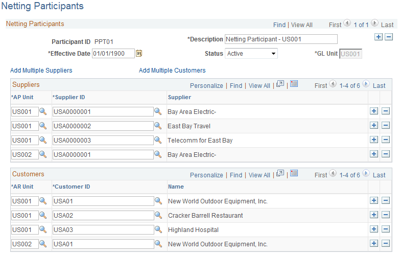

Netting Participants Page
Use the Netting Participants page (NET_PARTICIPANT) to define the supplier and customer relationships involved in netting.
Navigation:
Cash Management, and then Administer Cash, and then Netting Participants
This example illustrates the fields and controls on the Netting Participants page. You can find definitions for the fields and controls later on this page.
Field or Control Description
GL Unit (General Ledger business unit)
For reporting purposes, you must select the unit that is targeted by these transactions, because the transactions affect balances at the general ledger level.
Suppliers
AP Unit (Payables business unit)
Select the unit that houses the suppliers that are entering the netting relationship, and specify the Supplier ID.
Add Multiple Suppliers
Click to access the Add Multiple Suppliers page, and make this relationship a one-to-many or many-to-many relationship (for example, you might want to net the transactions of subsidiaries to a corporation).
Customers
AR Unit (Receivables business unit)
Select the unit that houses the customers that are entering the netting relationship, and specify the Customer ID.
Add Multiple Customers
Click to access the Add Multiple Customers page, and make this relationship a one-to-many or many-to-many relationship (for example, you might want to net the transactions of subsidiaries to a corporation).

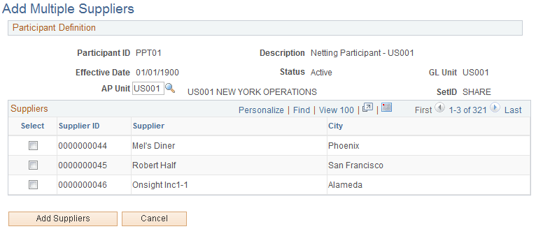

Add Multiple Suppliers Page
Use the Add Multiple Suppliers page (NET_VENDOR_ADD) to search and select multiple suppliers associated with a business unit to add to the netting relationship.
Navigation:
Click Add Multiple Suppliers on the Participant Definition page.
This example illustrates the fields and controls on the Add Multiple Suppliers page. You can find definitions for the fields and controls later on this page.
AP Unit
Specify a business unit from which to select suppliers.
Add Suppliers
Select suppliers and click this button to add them as participants.

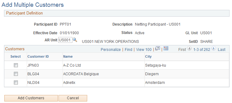

Add Multiple Customers Page
Use the Add Multiple Customers page (NET_CUSTOMER_ADD) to search and select multiple customers associated with a business unit to add to the netting relationship.
Navigation:
Click Add Multiple Customers on the Participant Definition page.
This example illustrates the fields and controls on the Add Multiple Customers page. You can find definitions for the fields and controls later on this page.
AR Unit
Specify a business unit from which to select customers.
Add Customers
Select customers and click this button to add them as participants.

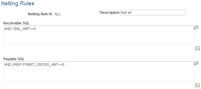

Netting Rules Page
Use the Netting Rules page (NET_NETTING_RULES) to enter a SQL statement that will be included into the Application Engine Netting selection logic.
Navigation:
Cash Management, and then Administer Cash, and then Netting Rules
This example illustrates the fields and controls on the Netting Rules page. You can find definitions for the fields and controls later on this page.
Netting Rules page
Receivable SQL and Payable SQL
Enter the appropriate SQL statements to set up the mechanics of the net, and to further define and/or limit which open items are selected. For example, where I.DEPARTMENT equals 'ABC'.
Comments icon
Click to add comments regarding SQL statements for the respective (Receivable or Payable) edit box.

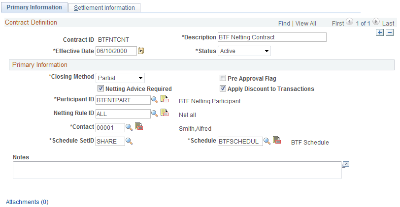

Netting Contracts - Primary Information Page
Use the Netting Contracts - Primary Information page (NET_CONTRACT_PRIM) to enter primary information for netting contracts.
Navigation:
Cash Management, and then Administer Cash, and then Netting Contracts, and then Primary Information
This example illustrates the fields and controls on the Netting Contracts - Primary Information page. You can find definitions for the fields and controls later on this page.
Primary Information
Pre Approval Flag
Select to indicate the netting contract is already approved.
Netting Advice Required
Select to notify a contact when netting is run.
Apply Discount to Transactions
Select to indicate that the system should consider the discount from the payment terms when calculating netted amounts.
Schedules
Specify the netting run schedule for the specified Schedule SetID.
View Participants icon
Click View Participants to view participants of the specified Participant ID.
View Rules icon
Click View Rules to view rules of the specified Netting Rule ID.
View Contacts icon
Click View Contacts to view contact information for the specified Contact ID.
View Schedules icon
Click View Schedules to view schedule information for the specified Schedule.
Click to view/ add attachments. See Application Fundamentals: Installation Options - Multiple Attachments Page to define the maximum attachment upload limit for various products.

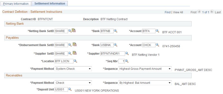

Netting Contracts - Settlement Information Page
Use the Netting Contracts - Settlement Information page (NET_CONTRACT_STL) to define all settlement instruction information for a netting contract.
Navigation:
Cash Management, and then Administer Cash, and then Netting Contracts, and then Settlement Information
This example illustrates the fields and controls on the Netting Contracts - Settlement Information page. You can find definitions for the fields and controls later on this page.
Netting Bank SetID
Assign a netting SetID; then select the Bank and Account for the netting activities. The netting bank is a virtual bank account: no funds are actually paid into or out of the netting account. It is debited and credited by the netted amount of the AP and AR transactions.
Disb Bank SetID (disbursement bank SetID)
Select from the available external banks, and specify the settle through Bank and Account.
Supplier SetID
Assign a supplier SetID. In the Supplier field, designate the supplier involved in the net and assign a Location and Seq Nbr (sequence number). You enter the supplier ID and sequence number to associate the default bank with that supplier (this is required to support certain payment methods).
Payment Method
For the Payables group box, specify if payments are submitted by Automated Clearing House, Direct Debit, EFT, Manual Check, System Check, or Wire Report.
For the Receivables group box, specify if payments are received by Check (Check, EFT, etc.), Direct Debit, or Draft.
Sequence
Select the order in which balances will net, either By Account Date (FIFO) (first in first out), By Accounting Date (LIFO) (last in first out), By Due Date (FIFO), By Due Date (LIFO), By Voucher, Highest Gross Balance, or Smallest Gross Balance.
Deposit Unit
Define which business unit will receive payment after the net.
View Netting Account icon
Click View Netting Account to view detailed information for the specified netting account.
View Disbursement Bank icon
Click View Disbursement Bank to view detailed information for the specified external bank account.
View Supplier Bank icon
Click View Supplier Bank to view detailed information for the supplier location.
