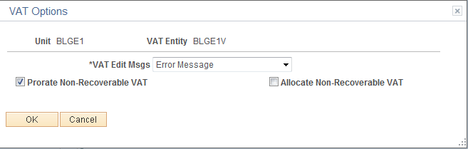

Treasury - VAT Options Page
Use the Treasury - VAT Options page (TRV_BU_UNIT_OPT_TR) to define specific VAT processing options for a Treasury business unit.
Navigation:
Set Up Financials/Supply Chain, and then Business Unit Related, and then Treasury, and then Treasury Options
Click Treasury VAT Options on the Treasury Options page.
This example illustrates the fields and controls on the Treasury - VAT Options page. You can find definitions for the fields and controls later on this page.
Treasury Options - VAT Options page
Field or Control Description
VAT Edit Msgs (VAT edit messages)
VAT edit messages are used to indicate if VAT tolerance messages are errors, warnings, or not displayed. This is a business unit-only default and applies directly to a transaction.
  • Error Message: A message displays, and you must correct the tolerance error to proceed with a transaction.
  • Warning: A message displays indicating a transaction exceeds tolerance settings.
  • None: No message displays.
Prorate Non-Recoverable VAT
Select this check box to record non-recoverable VAT amounts to an expense account.
Allocate Non-Recoverable VAT
Select this check box to allocate non-recoverable VAT using ChartField Inheritance logic.
You can select either to allocate or prorate nonrecoverable VAT transactions, but you cannot select both check boxes.
