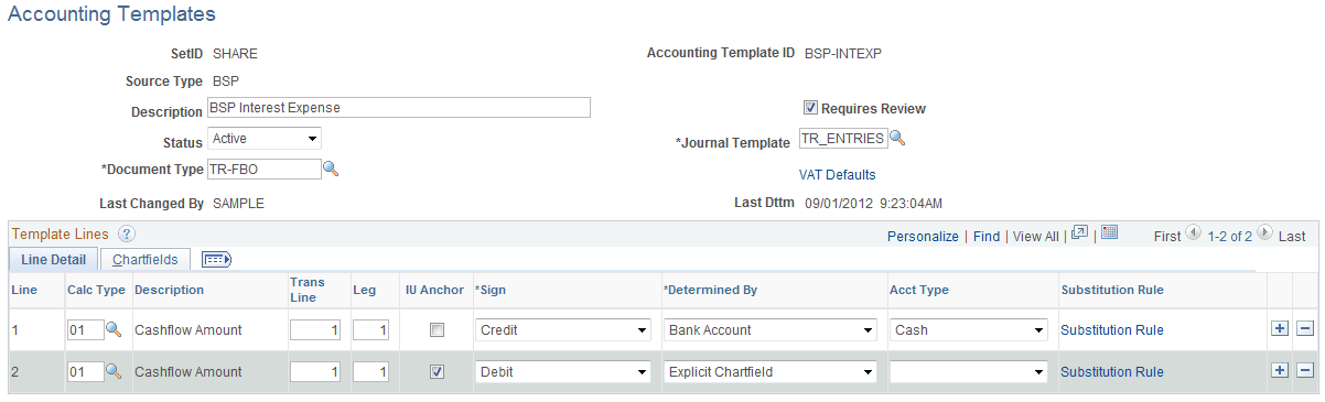

Accounting Templates Page
Use the Accounting Templates page (TRA_TMPL_DETL) to enter general accounting template and template line information.
Navigation:
Cash Management, and then Treasury Accounting, and then Accounting Templates
This example illustrates the fields and controls on the Accounting Templates page. You can find definitions for the fields and controls later on this page.
Field or Control Description
Requires Review
Select to force review of the accounting transactions that use this template.
When you select this check box, the system assigns error-free accounting entries and a status of Provisional. To finalize the provisional entry, use the View/Approve Entries page to review and change the status to Final.
If you do not select this check box, the system assigns error-free accounting entries using this template and a status of Final.

Line Detail Tab
Select the Calc Type (calculation type) to use on each template line—this varies depending on the source type. For deal-related calculation types, you must also specify a transaction line and leg of the deal.
Trans Line (transaction line)
For Deals source type, indicates the line from the deal instrument. All other sources have a default of 1.
Leg
Indicates the deal accounting leg number.
IU Anchor (interunit anchor)
Specify one line of the template as the anchor. This is a required field because the centralized processor uses it to generate interunit entries. The anchor line cannot be a line where the ChartField is determined by bank account.
Sign
Select the numerical sign for a transaction Credit, Debit, Keep Sign, or Rev Sign (reverse sign).
Determined by
Indicate how to inherit ChartField values for the specified template line. Values are:
Bank Account: ChartField values are inherited from the bank account that is specified by the source transaction. Fields on the ChartField tab for this line are then disabled.
Explicit ChartField: You define specific ChartField values on the ChartField tab.
Acct Type (account type)
If the ChartField is determined by bank account, then you must choose the General Ledger account type. For Treasury, select Cash Account.
If the ChartField is determined by Explicit ChartField, then leave this field blank.

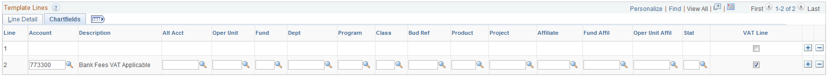

ChartFields Tab
Enter the appropriate ChartField values.
This example illustrates the fields and controls on the Chartfields tab of the Accounting Templates page. You can find definitions for the fields and controls later on this page.
Accounting Templates page - Chartfields tab
Stat (statistic)
Select a statistics code for the specific accounting line. This field can be edited on the accounting entry.
VAT Line (value-added tax line)
Click to specify that VAT is applicable for this accounting line. You can specify VAT options only for accounts with:

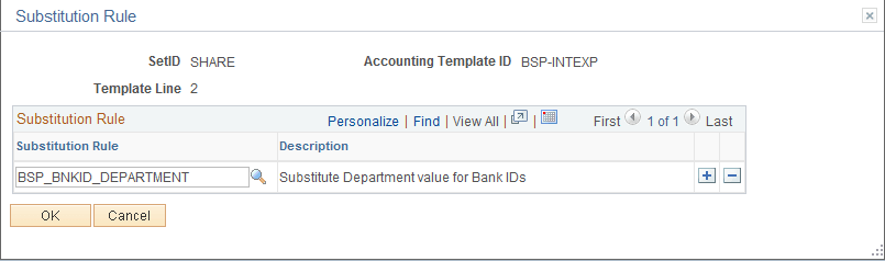

Accounting Templates - Substitution Rule Page
Use the Substitution Rule page (TRA_SUB_RULE) to associate a defined substitution rule with an accounting template line.
Navigation:
Cash Management, and then Treasury Accounting, and then Accounting Templates, and then Substitution Rule
This example illustrates the fields and controls on the Accounting Templates - Substitution Rule page. You can find definitions for the fields and controls later on this page.
Use substitution rule functionality to make minor adjustments to templates without having to rebuild them. For example, you might require that certain departments perform deal accounting on deals by dealers by specifying criteria for each dealer's user ID. The substitution rule that addresses this need is assigned to the applicable accounting template lines here. In this example, the substitution rule ID applied is DEAL_OPERID_TO_DEPT, which was defined on the Substitution Rule Definition page.
Substitution Rule
Enter a predefined substitution rule to apply to the template line. You can have more than one substitute rule per template line. Substitution rules are set up on the Substitution Rule Definition page (Cash Management, and then Treasury Accounting, and then Define Substitution Rules, and then Substitution Rule Definition).
When multiple substitution rules are defined for a template line, the system validates that the Set ChartField value is unique within all of the associated substitution rules.
