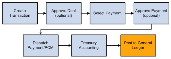

Understanding the Inbound and Outbound Transaction Process Flow
During processing, the program calls the centralized processor to generate interunit and intraunit balancing (IU_PROCESSOR).
These diagrams illustrate the inbound and outbound transaction processes.

Outbound process from creating transaction through payment dispatch and Treasury Accounting to posting to General Ledger
Outbound transaction process

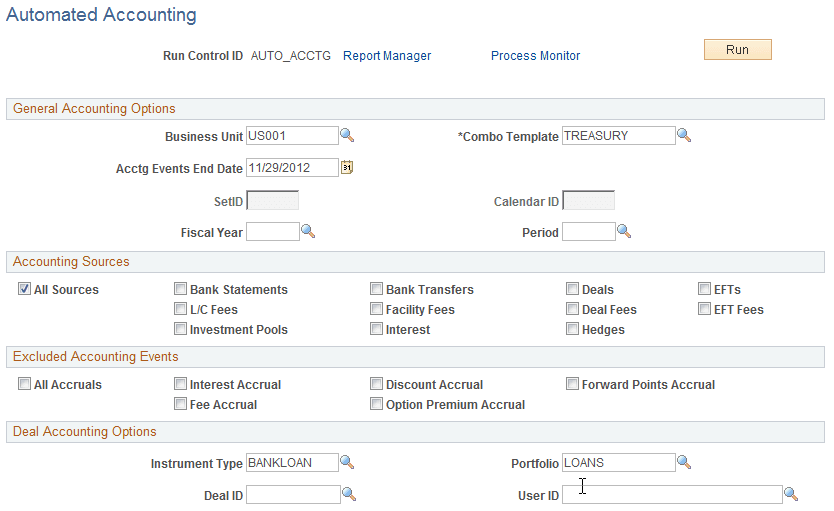

Automated Accounting Page
Use the Automated Accounting page (TRA_ACCTG_REQ) to run the Automated Accounting process, which creates accounting entries and prepares them for the Journal Generator (FSPGJGEN) process.
Navigation:
Cash Management, and then Treasury Accounting, and then Automated Accounting
This example illustrates the fields and controls on the Automated Accounting page. You can find definitions for the fields and controls later on this page.
Field or Control Description
Business Unit
Enter a value to process automated accounting for a specific business unit. You can also leave the Business Unit field blank to set up automated accounting for multiple business units.
If you enter a business unit defined with a calendar ID on the Treasury Options page, the calendar ID appears on the page.
Note: Your system administrator can set up the option to issue a warning instead of an error message (13550, 70) for processing a single business unit using an Accounting Events End Date when the selected Business Unit is defined with a Calendar ID. This table provides an overview of the selections a user can make on the run control page and the accounting entries that the Automated Accounting Engine processes.
Combo Template
Enter a template ID for the combination of business unit and general ledger.
Acctg Events End Date
Enter an accounting events end date. The system processes all associated accounting events on or before the specified date. If a business unit has a calendar associated with it, you must leave this field blank and enter Fiscal Year and Period values.
SetID
Displays the SetID value associated with the Calendar ID that controls the Fiscal Year and Period.
Calendar ID
Displays the Calendar ID value that controls the Fiscal Year and Period. If you enter a business unit associated with a calendar ID on the Treasury Options page, that calendar ID will appear here. If the business unit has a calendar associated with it, you must enter Fiscal Year and Period values and leave the Acctg Events End Date field blank.
Enter the Fiscal Year and Period values that will be used to determine the accounting events to be processed by Automated Accounting process.
The process creates accounting entries even if errors occur. Use the Accounting Entries page to correct any errors, and then change the status from Error to Provisional. Use the View/Approve Entries page to change the status from Provisional to Final. The accounting entries are then ready for General Ledger. You do not have to rerun the Automated Accounting process.
