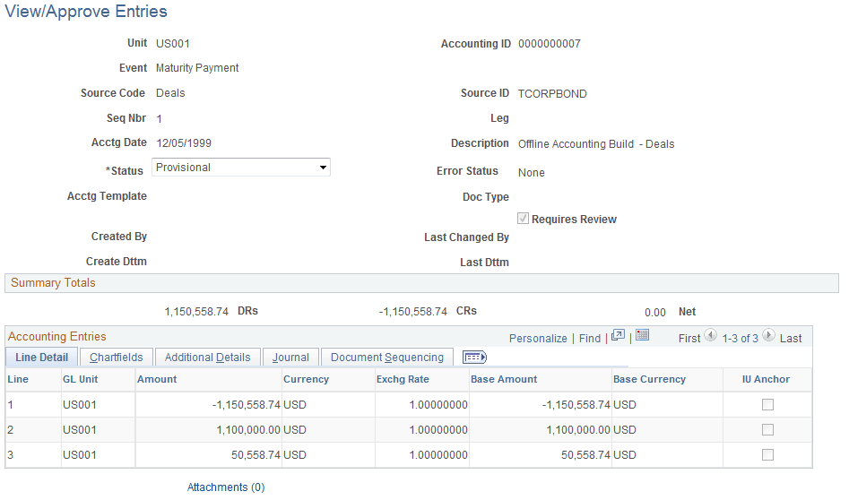

View/Approve Entries Page
TRA_ACCTG_LINE
Approve accounting entries that are awaiting review.

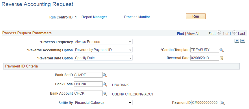

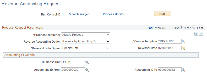

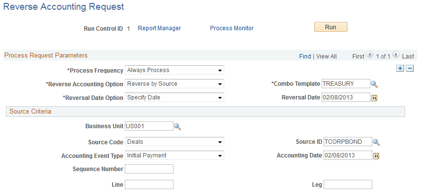

Reverse Accounting Request Page
REV_ACCTG_REQ
Run a process to create reversal accounting entries.
Note: Accounting entries can be reversed only one time.

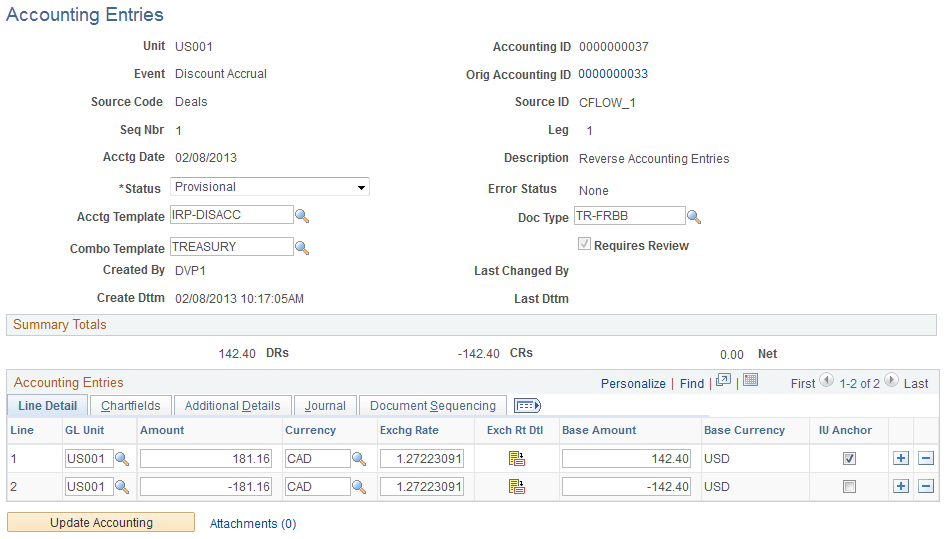

Accounting Entries Page
Use the Accounting Entries page (TRA_ACCTG_LINE) to review and adjust automated accounting entries.
Create manual accounting entries online.
Navigation:
Cash Management, and then Treasury Accounting, and then Accounting Entries
This example illustrates the fields and controls on the Accounting Entries page. You can find definitions for the fields and controls later on this page.
Field or Control Description
Accounting ID
Displays the ID of the accounting entry.
Orig Accounting ID
Indicates the entry is a reversal entry. Click the link to view the original accounting entry in a separate window.
The Description field also identifies whether the entry is a Reversal Accounting Entry.

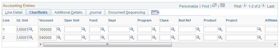

ChartFields Tab
Select the ChartFields tab.
This example illustrates the fields and controls on the Accounting Entries page - Chartfields tab. You can find definitions for the fields and controls later on this page.
Stat (statistic)
If a statistics code is set for this accounting line on the template, the code appears here. You can edit this field. Select a statistics code—the associated unit of measure (UOM) appears for the selected code. You must also enter a statistic amount with which to measure the statistic.
IBAN
Displays the international bank account number (IBAN) in addition to the local, domestic bank account number when the country has been set up to display the IBAN on the PeopleSoft Banks Setup and Processing: IBAN Formats Page.
Important:
If a ChartField combination editing error occurs, an Errors column will appear after the Line # column. An X link will appear next to an transaction line with a ChartField combination error. You click the X link to access an Accounting Entries secondary page, which contains a grid that describes the error message for each transaction. You can click on a transactions Line # link and access the accounting transaction with the ChartField combination error, and fix the problem. See the Accounting Entries subtopic in this section for additional details.
See Application Fundamentals: ChartField Values.

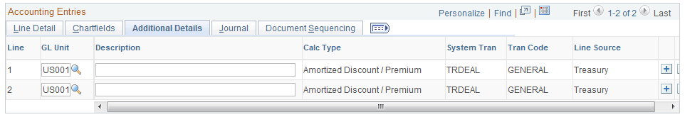

Additional Details Tab
Select the Additional Details tab.
This example illustrates the fields and controls on the Accounting Entries page - Additional Details tab. You can find definitions for the fields and controls later on this page.
Line Source
Displays either Treasury for accounting lines that are generated by the treasury accounting program, or System IU for accounting lines that are generated by the centralized processor.

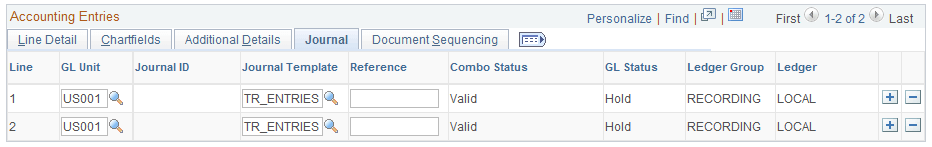

Journal Tab
Select the Journal tab.
This example illustrates the fields and controls on the Accounting Entries page - Journal tab. You can find definitions for the fields and controls later on this page.
Combo Status
Indicates whether the ChartField combination that the system built based on the accounting template is Valid or Invalid.
GL Status (General Ledger status)
Provides information about the posting status of the entry. Possible values include:
  • Distributed: Distributed to a General Ledger journal.
  • Hold: An error condition exists, the entry must be corrected before Journal Generator can process it, or the entry requires review.
  • None: The entry has been created without errors, but has not been processed by the Journal Generator process.
Ledger Group
Indicates the general ledger group that is associated with the General Ledger Unit on the accounting line.
Ledger
Indicates the general ledger that is associated with the General Ledger Unit on the account line.
Creating Ad Hoc Accounting Entries
On the Accounting Entries page, the Source Code, Source ID, Event, and Accounting Template fields are optional.
  • If you complete the Source Code, Source ID, and Event fields, the system can create a link between the manual and the automated accounting results.
  • If you enter entries manually on a recurring basis, you can create and use an accounting template to minimize the data entry process for these entries. Any template that you create appears in the Accounting Template field. When you select an accounting template for this ad hoc entry, the system automatically populates the accounting lines with the template data.
To create ad hoc accounting entries:
  1. Enter the business unit and optionally, an accounting ID. Click Add.
  2. Select an accounting event from the following values:
    • (none)
    • AOCI Adjustment
    • AOCI Reclassify
    • Amortize Adj of Carrying
    • Barrier Rebate Payment
    • Commodity Cash Difference
    • Commodity Settlement
    • Deal Booking
    • Deal Maturity
    • Derecognize Firm Commitment
    • Discount Accrual
    • Fair Value Hedged Item G/L
    • Fee Accrual
    • Firm Commitment to Carrying
    • Forward Points Accrual
    • Generic Cash Flow
    • Initial Payment
    • Interest Accrual
    • Interim Principal Payment
    • Mark to Market
    • Maturity Payment
    • Option Cash Difference
    • Option Exercise
    • Option Premium Accrual
    • Periodic Payment
    • Premium Payment
    • Sell / Buyback
    • Transaction Fee
    • Will Not Occur - AOCI Reclassify
  3. Specify a source code.
  4. Select a specific source ID of the selected source code.
  5. Review the accounting date for accuracy.
  6. Leave the default status for ad hoc entries as Provisional. Do not change this setting.
  7. The Require Review check box is automatically selected for ad hoc entries. You cannot deselect this check box.
  8. (Optional) Enter a description.
  9. Select an accounting template.
  10. Enter at least one debit and one credit line to balance the entry, and select one line as the IU anchor.
  11. Enter an account and any other ChartFields for each line.
  12. Select TR_ENTRIES for the journal template.
  13. Click Update Accounting to run the centralized processor function, which creates any necessary offset entry lines and saves the manual accounting entry.
If the debits and credits do not balance, you receive an error message and the accounting entry is not saved. Make the necessary corrections, and then save the page.
When the Journal Generator processes the entry, the distribution status changes from None to Distributed, and no further changes can be made.
Use the View/Approve Entries page (TRA_ACCTG_LINE) to approve accounting entries that are awaiting review.
Navigation:
Cash Management, and then Treasury Accounting, and then View/Approve Entries
This example illustrates the fields and controls on the View/Approve Entries page. You can find definitions for the fields and controls later on this page.
Status
Initially displays the status of accounting entries that are displayed in the Accounting Entries grid. Values are:
  • Error: Accounting entries are in error and must be corrected before they can be posted to the general ledger. Possible causes of errors include unbalanced entries, currency exchange rate cannot be found, accounting template cannot be found, interunit errors, and so forth. Error status can be set only by the Automated Accounting process.
  • Needs Correction: Accounting entries are in error. Needs Correction status can only be set manually.
  • Provisional: Accounting entries passed system verifications, but require visual inspection. You can review the entry and save it with a new status of Final or Needs Correction.
  • Final: Accounting entries are ready to be posted to the general ledger.
Use PeopleSoft Security functionality to identify which users have access and approval privileges to provisional accounting entries. You can define permission lists and accessible pages for a specific userID. See the product documentation for PeopleTools: Security Administration.

Understanding Reverse Accounting
Accounting entries that need to be reversed can be identified using various identifiers, such as Accounting ID, Source, and Payment ID. The Reverse Accounting Entries Application Engine process (TR_RVSL_DRVR) does the following:
  • Selects the accounting data (header, lines, and VAT).
    The reversal accounting entry is not linked to a fiscal period.
  • Reverses the amounts and reset certain statuses and fields (for example, Journal Generator links).
  • Assigns a new accounting ID to each selected header, lines, and VAT.
    The process does not reset the accounting event status associated to the original accounting entry.
  • Calls document sequencing and ChartField combination editing, when applicable.
  • Populates the accounting tables with the new data (header, lines, and VAT).
  • Checks for errors (for example, combination edit, unbalanced entries) and updates the accounting header.
  • Logs messages summarizing the entries (including type of errors, number of entries created).
When deactivating a deal, you can automatically reverse the accounting entries on the Undo Deal Utility page. When you select the Reverse Accounting check box, you can use additional options to specify the Reversal Date Option and Combo Edit Template. The TRX_UNDO_DEAL Application Engine process uses the entered parameters and calls the Reverse Accounting process. When you create cumulative MTM accounting entries for deals, the Treasury Accounting Application Engine program (TR_ACCTG) processes cumulative fair value adjustments then initiates reverse accounting to reverse previous fair value adjustment accounting entries. For more information, see the documentation for the Deal Analytics page.
When an already accounted external transaction is unreconciled using semi-manual reconciliation, the system triggers the TR_RVSL_DRVR process to reverse the accounting entries. The external transaction status is set as Void to ensure that there is only one valid BSP transaction corresponding to the source Bank Statement transaction.
Use the Reverse Accounting Request page (REV_ACCTG_REQ) to run a process to create reversal accounting entries.
Navigation:
Cash Management, and then Treasury Accounting, and then Reverse Accounting Request, and then Reverse Accounting Request
This example illustrates the fields and controls on the Reverse Accounting Request page.
Reverse Accounting Request page to reverse by Accounting ID
Reverse Accounting Option
Select from these values:
  • Reverse by Accounting ID
  • Reverse by Payment ID
  • Reverse by Source
The page will render differently depending on the selected Reverse Accounting Option. Each option has different criteria for identifying the accounting entries to be reversed.
Combo Template
Specify a combination editing template.
See Application Fundamentals: Setting Up Combination Editing.

Accounting ID Criteria
This section appears when you select Reverse by Accounting ID in the Reverse Accounting Options field.
This example illustrates the fields and controls on the Reverse Accounting Request page to reverse by Accounting ID.
Business Unit
Enter a business unit. This is a required field.
Accounting ID From and Accounting ID To
Identify one or more accounting IDs to be reversed. Accounting entries for the accounting ID range will be reversed. Accounting ID From is a required field.

This section appears when you select Reverse by Payment ID in the Reverse Accounting Options field.
This example illustrates the fields and controls on the Reverse Accounting Request page to reverse by Payment ID.
The following fields are required:
Bank SetID
Enter the bank SetID.
Bank Code
Enter the bank code.
Bank Account
Enter the bank account.
Settle By
  • Financial Gateway
  • Pay Cycle
Payment ID
Enter the ID for the payment to be reversed.
Source Criteria
This section appears when you select Reverse by Source in the Reverse Accounting Options field.
Accounting entries created for a source for a specific accounting date can be reversed.
This example illustrates the fields and controls on the Reverse Accounting Request page to reverse by source values. You can find definitions for the fields and controls later on this page.
Reverse Accounting Request page to reverse by Source values
Business Unit, Source Code, and Source ID are required fields for all sources.
Business Unit
Source Code
Select from the values that appear in the following table.
Source Code Values Criteria Used Identify Accounting Entries
Bank Transfers
EFT Requests
Hedges
Interest
Source ID
Accounting Event Type
Accounting Date
Deal Fees
EFT Fees
Facility Fees
Investment Pools
LC Fees
Source ID
Accounting Date
Sequence Number
Deals
Source ID
Accounting Date
Sequence Number
Line
Leg
Source ID
Enter the source ID.
Select an accounting event type from the list. The values available in the Accounting Event Type list depend on the Source Code selected.
Accounting Date
Enter the accounting date.
Sequence Number
Enter a sequence number.
The Sequence Number value is for multiple like events on the same date (that is, same Business Unit, Source Code, Source ID, Accounting Event Type, and Accounting Date).  For example, two Deal Interim Principal Payments or two Deal Fees.
Line
Enter a deal line to be reversed, if desired.
Leg
Enter a deal leg, if desired.
