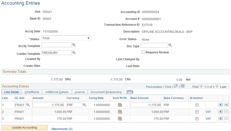

Reviewing VAT Accounting Entries
Use the Accounting Entries page (TRA_ACCTG_LINE_1) to review and possibly adjust automated accounting entries, or create manual accounting entries online.

Click VAT on the Accounting Entries tab.
This example illustrates the fields and controls on the Line Detail tab - Treasury Accounting Entries page. You can find definitions for the fields and controls later on this page.
Accounting Entries page - Line Detail tab
When the Automated Accounting process is complete, you can review the created accounting entries and VAT transactions. The VAT link displays on the Accounting Entries page when the accounting line has VAT information.
Field or Control Description
Line
As the example above shows, the Automated Accounting process created three accounting entries. Line 3 is the VAT amount. Click a Line link to access the Accounting Entries page and review the VAT transaction detail.
The number of VAT accounting lines created varies, depending on the accounting scenario.
The number and types of accounting entries depends on the VAT Treatment and whether or not any of the VAT is recoverable or subject to rebate.
The system obtains the ChartFields used to create each accounting entry from the VAT accounting template (which is defined by VAT Code, VAT Transaction Type, and optionally the General Ledger business unit). Additionally, for nonrecoverable VAT, the ChartFields used are also dependent upon whether or not the nonrecoverable amount is being prorated or allocated to the associated expense account. If the nonrecoverable amount is not prorated or allocated to the associated expense account, the system obtains the non-account ChartFields from the VAT accounting template.
In situations when the VAT accounting entries have two different business units—one for the Transaction General Ledger business unit (Unit field in the Accounting Entries page header), and one for the Distribution General Ledger business unit (GL Unit field in Accounting Entries - Line Detail tab), you can direct the system to inherit either business unit. You specify this option during implementation on the VAT Business Unit Option page (VAT_BU_OPT). During the Automated Accounting process, if the system registers two different business units in use, it refers to the options specified on this page. The system then enters the correct inherited business unit into the GL Unit field of each entered distribution line of the system generated VAT accounting entries.
Accounting entries that the Automated Accounting process creates and distributes to General Ledger are display only and you cannot adjust them on this page. You must adjust VAT accounting through the General Ledger journal.

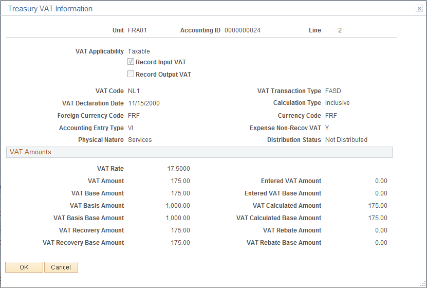

Treasury VAT Information Page
Use the Treasury VAT Information page (TRV_ACCTG_LINE_VAT) to use the Treasury VAT Information page to view VAT information for a specific accounting line.
Navigation:
Click VAT on the Accounting Entries − Accounting Entries tab.
This example illustrates the fields and controls on the Treasury VAT Information page. You can find definitions for the fields and controls later on this page.
Treasury Management VAT functionality is currently limited to VAT on bank fees and other fees, recording only input VAT or the combination of input and output VAT. As such, it is unlikely that you will be using either the VO or VONT types for your VAT transactions.
VAT Applicability
Displays the default value derived from the accounting template.
Record Input VAT
This field is based on the defined VAT treatment. This check box is selected by default.
Record Output VAT
This check box is selected by default if the defined VAT treatment is EU Services Purchases or Self-Assessed Services Imports.
VAT Code
Displays the default value derived from the appropriate VAT defaulting hierarchy—this is also dependent on the VAT Treatment and/or VAT Applicability.
VAT Calculation Type
Displays Inclusive or Exclusive.
VAT Declaration Date
Displays the default value derived from the transaction date.
Accounting Entry Type
Displays the VAT accounting entry type.
VAT distribution account types define the different types of VAT accounting entries that may be required. Treasury Management only uses the following VAT distribution account types:
  • VI: VAT Input
  • VIR: VAT Input Recoverable
  • VIN: VAT Input Non-Recoverable
  • VIB: VAT Input Rebate
  • VINT: VAT Input Non-Taxable
  • VOP: VAT Output on Purchase
  • VO: VAT Output
  • VONT: VAT Output Non-Taxable.
Expense Non-Recov VAT (expense nonrecoverable VAT)
Displays one of the following values:
  • Y (yes): Indicates the system expenses nonrecoverable VAT to the expense account.
  • N (no): Indicates the system separates nonrecoverable VAT.
Distribution Status
Indicates if the transaction has been loaded to the VAT Transaction Loader. Displays one of the following values:
  • DISTRIBUTED: Indicates the transaction has been loaded.
  • IGNORE: Indicates the system is not to load the transaction.
  • NOT DISTRIBUTED: Indicates the transaction is eligible to be loaded, but has not yet been loaded.
  • UNDEFINED: Indicates the transaction requires additional processing before the system transfers it to the loader.
VAT Rate
Displays the VAT percentage that is applied to the transaction.
VAT Amount
Displays the VAT amount in the transaction currency.
VAT Base Amount
Displays the VAT amount in the base currency.
VAT Basis Amount
Displays the VAT basis amount in transaction currency.
VAT Basis Base Amount
Displays the VAT basis amount in the base currency.
VAT Recovery Amount
Displays the VAT recovery amount in the transaction currency.
VAT Recovery Base Amount
Displays the VAT recovery amount in the base currency.
Entered VAT Amount
The default value is zero (0). If either the VAT calculation type is Inclusive, or both Record Input VAT and Record Output VAT check boxes are selected, this field is set to zero and unavailable. You can override this default value by selecting Exclusive for the calculation type.
This is the actual VAT amount in transaction currency that prints on the external document. If it is not equal to the calculated VAT amount (and not equal to zero), tolerance checking is performed.
Entered VAT Base Amount
Displays the entered VAT amount in base currency. The system uses the transaction currency for the entered VAT amount, based on the exchange rate that is applicable to the transaction.
VAT Calculated Amount
Displays the calculated VAT amount in the transaction currency.
VAT Calculated Base Amount
Displays the calculated VAT amount in the base currency.
VAT Rebate Amount
Displays the calculated VAT rebate amount in the transaction currency.
VAT Rebate Base Amount
Displays the calculated VAT rebate amount in the base currency.
This page is display-only. Once the Automated Accounting process creates the VAT accounting entries and distributes them to General Ledger, you cannot adjust the entries on a Treasury application page. You must use the General Ledger Journal Entry page to adjust VAT accounting entries.
