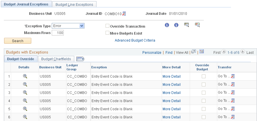

Budget Journal Exceptions Page
Use the Budget Journal Exceptions page (KK_XCP_HDR_GL2) to Edit and budget checking errors at the header level are displayed on this page.
Commitment control security errors, balancing errors when an unbalanced transfer is saved, and combination editing errors are displayed on the Budget Errors page of the journal entry component.

This example illustrates the fields and controls on the Budget Journal Exceptions page. You can find definitions for the fields and controls later on this page.

Access Original Budget Journal
Click this button that is located next to the journal ID to access the original budget journal.
Exception Type
You can limit information returned for this budget journal to either errors or warnings and when you click the Search button the system populates the scroll up to the number of rows that you specify in the Maximum Rows field.
Override Transactions
If you have been given the super user level of security, and if the nature of the transaction type and budget setup permits it, you can select this check box and rerun the budget process from this page to budget check a budget journal that is in error.
This check box is not available if the journal is valid, if you do not have the necessary security permission, if the source transaction definition does not permit an error override, or if one or more journal lines has an error that cannot be overridden.
This check box is also not available for warning exceptions because it is not necessary to override warnings.
Maximum Rows
Enter the maximum number of budget journals lines with exceptions that you want to retrieve to the budgets with exceptions grid at the bottom of the page. The default value is 100.
If the number of rows retrieved by the system exceeds the default value or the number of rows that you specify for the Maximum Rows field when you click the Search button, you are prompted by a message to increase the number to display the additional rows. However, you can also click the OK button on the message to continue to display less than the total rows retrieved and the More Budgets Exist check box is selected by the system.
More Budgets Exist
The system selects this field when the Maximum Rows field value is less than the total number of budget rows retrieved by the system.
Field or Control Description
Budget Check Doc
Click the Budget Check Document button after overriding errors to budget check the budget journal again.
Advanced Budget Criteria
Click this link to access the Refine Inquiry Criteria page where you can change the budget criteria to limit the rows you see.
Budgets with Exceptions
View Budget Journal Drilldown
Click to view the Budget Journal Drill Down page for a budget journal row where you can view the line identifiers, source information, and transaction line detail.
Override Budget
If you have the security designation of super user, you can override errors for individual budget journal rows. The check box is not available if you are not a super user, and if an override is not allowed.

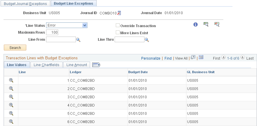

Budget Journal Line Exceptions Page
Use the Budget Journal Line Exceptions page (KK_XCP_LN_GL2) to edit and budget checking errors at the journal line level are displayed on this page.
Navigation:
Commitment Control, and then Review Budget Check Exceptions, and then General Ledger, and then Review Budget Journals, and then Budget Journal Line Exceptions
This example illustrates the fields and controls on the Budget Journal Line Exceptions page. You can find definitions for the fields and controls later on this page.
Budget Line Exceptions page
Many of the page element and the descriptions on this page are the same as those for the Budget Journal Line Exceptions page. Those that are different are described here.
Line From and Line Thru
Enter a consecutive block of line numbers and click the Search button to display those rows within the maximum rows constraints.
If the number of rows populating the Transactions Lines with Budget Exceptions grid is less than the number retrieved given you criteria, the system will issue a message that more lines exist and you can either increase the lines or click the OK button on the message to display the block of numbers that you originally selected.
Maximum Rows
Enter the maximum number of budget journal transaction lines with budget exceptions that you want to retrieve to the Transaction Lines with Budget Exceptions grid at the bottom of the page. The default value is 100.
If the number of transaction lines retrieved by the system exceeds the default value or the number of rows that you specify for the Maximum Rows field when you click the Search button, you are prompted by a message to increase the number to display the additional rows. However, you can also click the OK button on the message to continue to display less than the total transaction lines retrieved and the More Lines Exist check box is selected by the system.
More Lines Exist
The system selects this field when the Maximum Rows field value is less than the total number of transaction lines with budget exceptions retrieved by the system.

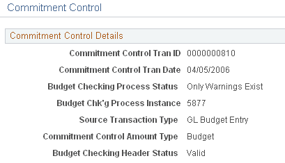

Commitment Control Details Page
Use the Commitment Control Details page (KK_XCP_TRAN_SEC) to shows budget check details (such as process instance, errors exist, or only warnings ).
Navigation:
Click the Budget Check Details button on the Budget Journal Exceptions page to access the Commitment Control Details page.
This example illustrates the fields and controls on the Commitment Control Details page. You can find definitions for the fields and controls later on this page.
This page is accessed from the Budget Journal Exceptions page. It displays the details of the budget journal associated with the budget line exception.

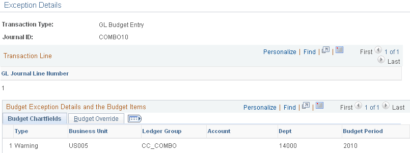

Exception Details Page
Access the Exception Details page (click the magnifying glass with the plus sign for a particular line on the Budget Journal Line Exceptions page).
This example illustrates the fields and controls on the Exceptions Details page.
Accessed from the Budget Journal Line Exceptions page, this page displays the exceptions associated with a particular journal line and the associated exceptions with the budget ChartFields and any budget overrides applied.
