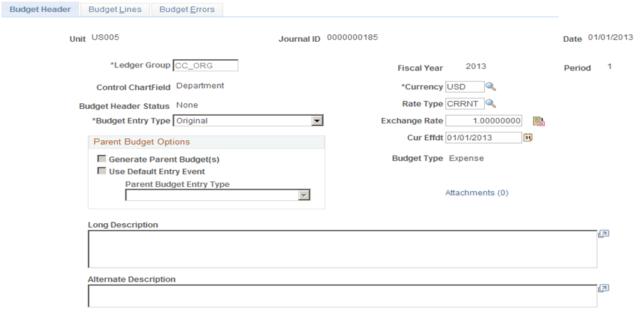

Budget Header Page
KK_BD_ENTRY1
Enter budget header information, such as the business unit, journal ID, journal date, Commitment Control ledger group, budget entry type, and currency. Also attach supporting documents to the control budget journal.
Although this page is the same (except for budget entry type labels) whether you access it through the Enter Budget Journals or Enter Budget Transfer components, the security access is different.
Different commitment control security events are used to enforce entry and adjustments on budget journal than are used for budget transfers. In addition, because they are different components, the general tools security can be used to limit access.

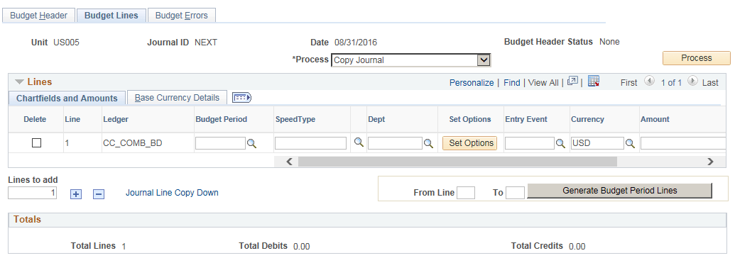

Budget Lines Page
KK_BD_ENTRY
Enter the transaction lines making up the journal, which include the monetary and statistical amounts and the ChartField values for each transaction.
Once you enter the header and lines, you can request journal processing on this page.

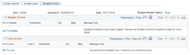

Budget Errors Page
KK_BD_ENTRY_ERR
Exceptions are displayed on this page for commitment control security errors, balancing errors when an unbalanced transfer is saved, and for combination editing errors. Edit and budget checking errors are not displayed on this page. They are logged on the commitment control exception table and are viewed by clicking the Budget Header Status value of Error, which becomes a link giving access to the Budget Journal Exceptions page.
The system saves a recycled journal, but it does not post the journal until you correct the errors.
Although this page is the same whether you access it through the Enter Budget Journals or Enter Budget Transfer components, the security access is different.

Budget Header Page
Use the Budget Header page (KK_BD_ENTRY1) to enter budget header information, such as the business unit, journal ID, journal date, Commitment Control ledger group, budget entry type, and currency. Also attach supporting documents to the control budget journal. Although this page is the same (except for budget entry type labels) whether you access it through the Enter Budget Journals or Enter Budget Transfer components, the security access is different. Different Commitment Control security events are used to enforce entry and adjustments on budget journal than are used for budget transfers. In addition, because they are different components, the general tools security can be used to limit access.
Navigation:
Commitment Control, and then Budget Journals, and then Enter Budget Journals, and then Budget Header
Commitment Control, and then Budget Journals, and then Enter Budget Transfer, and then Budget Header
This example illustrates the fields and controls on the Budget Header page. You can find definitions for the fields and controls later on this page.
Budget Header page
Field or Control Description
Ledger Group
When adding a new journal, a lookup is available to select the ledger group for the budget ledger to which this entry is directed.
Currency
This field inherits the base currency for the primary ledger of the General Ledger group to which this budget is attached.
Select a new currency if you wish to override the default. Control budget amounts can be entered in any currency, but the Budget Processor and Budget Posting process converts them into base currency amounts for validating budget amounts and verifying the availability of funds when you process source transactions.
The currency code entered here is used as the default currency for the budget journal lines.
Rate Type
If you are not using the base currency, enter a rate type for the amount conversion.
The system automatically displays the exchange rate based on the rate type you select.
Exchange Rate Detail
Click the Exchange Rate Detail button to open the Exchange Rate Detail page, which displays exchange rate detail information.
See PeopleSoft Global Options and Reports: Defining Market Rates.
Cur Effdt (currency effective date)
Defaults from the journal date. Enter a new date to override it. The current effective date is used to determine the exchange rate.
Budget Entry Type
For budget entries using the Enter Budget Journals page these values are available:
  • Select Original if this is an original budget entry being made for the first time.
  • Select Adjustment if this is an adjustment to an original budget amount.
For budget transfers using the Enter Budget Transfer page these values are available:
  • Select Transfer Original if this is a transfer of an original budget amount.
  • Select Transfer Adjustment if this is a subsequent transfer of an adjustment to an original budget amount.
Note: If you do not activate security for the Budget Entry or Adjustment event and for the Budget Transfer event, anyone who has general security access to the page is able to enter, adjust, and transfer budget amounts.
Attachments (link)
Select to accesses the Attachments page where you can add one or more supporting documents to the budget journal and select an option to display attachments to approvers. The system displays and error message if you try to load more than the number of attachments specified on the Application Fundamentals: Installation Options - Multiple Attachments Page for the General Ledger product.
Approvals
The Approval link appears if the budget journal has been submitted for approval using Approval Workflow from the Budget Lines page. This link accesses the Manage Control Budget Journal page.
See Approving Control Budget Journals Using Approval Framework.
Alternate Description
This additional description field is 150 characters long to accommodate increased reporting requirements for control-based budget activity. You can configure the label through the message catalogue (18021, 2740).
Parent Budget Options
Use these options to automatically create parent level budget and budget transfer impacts for a budget hierarchy no matter how many child to parent budget layers there might be.
The Generate Parent Budget(s), Use Default Entry Event, and Parent Budget Entry Type check boxes are available only under certain setup and security options. Details of setup and use of the feature are documented in separate sections dealing with the automatic generation of parent budget journals from child budget journals; the links to which follow.
See Generating Parent Budgets, Budget Adjustments and Budget Transfers Automatically.
Budget Lines Page
Use the Budget Lines page (KK_BD_ENTRY) to enter the transaction lines making up the journal, which include the monetary and statistical amounts and the ChartField values for each transaction. Once you enter the header and lines, you can request journal processing on this page. Although this page is the same whether you access it through the Enter Budget Journals or Enter Budget Transfer components, the security access is different.
Navigation:
Commitment Control, and then Budget Journals, and then Enter Budget Journals, and then Budget Lines
Commitment Control, and then Budget Journals, and then Enter Budget Transfer, and then Budget Lines
This example illustrates the fields and controls on the Budget Lines page. You can find definitions for the fields and controls later on this page.
Budget Lines page
Processing Options
Errors Only
Select to display only transaction lines that are in error.
Process
Select one of the following processing options and initiate the process by clicking the Process button:
  • Budget Pre-Check: Performs the usual budget checking and edits when a budget or transaction is posted, but it does so without committing changes to the Ledger_KK record, and other such records. A "check-only" of budget entries is especially useful in the work-in-progress stage of your budget development. You can also process actuals transactions using the budget pre-check option. This option is available only when the budget pre-check option for budget journals is enabled on the Installation Options - Commitment Control page.
    SeeApplication Fundamentals: Installation Options - Commitment Control Page.
    Note: Budget status for a budget entry or transaction might only be valid for a short time if others have concurrent access to affect the budget and to process transactions. For example, if two individuals do a budget check-only on a transaction for 1,000 USD and there is a budget of 1,000 USD, both transactions will pass because there is no commitment or posting in the budget pre-check process that reverses the budget for either amount. Because of the transient nature of the check only feature, it is best used online, even though it is available as a batch process as well.
  • Copy Journal: Copies the original journal values. When you click the Process button, the Budget Journal Copy page opens to make changes to Dates, Budget Entry Type, and Parent Budget Entry Type. You can select the option to save the original journal and copy. The values for the ChartField and Amounts are copied from the original journal.
  • Delete Journal: Deletes the current journal. You cannot delete a posted or unposted journal.
  • Edit Chartfields: Edits to determine if the budget journal passes ChartField validation and combination editing rules prior to posting. You can do combination editing directly, without calling the posting process.
    Any errors found are reported on the Budget Errors page. The budget lines status reflects lines that failed combination editing; however, the header status is not updated. With proper security the posting process can later be run and the edits are performed again even if the preliminary Edit Chartfields is run.
  • Post Journal: Initiates the Commitment Control Posting process (FS_BP). The process edits the journal and, if the journal is valid, posts it.
    Note: For reasons of efficiency, you can edit and post budget entry journals in the background, using the Budget Posting Request page.
    If Online Mode is not selected on the Application Fundamentals: Installation Options - Commitment Control Page and you run the Post Journal process, the system displays a pop-up message asking whether you want to wait for the process to complete:
    • If you select Yes, the page will hold until the process is complete.
    • If you select No, the page will clear and you can continue to work.
  • Refresh Journal: Refreshes the data on the page with data from the database. You lose unsaved changes if you do a refresh.
Submit for Approval
Select this check box to submit a budget journal for approval upon saving the page. This check box is disabled if the journal has already been submitted for approval. If budget journal approval is enabled, journal posting for a journal is not allowed before final approvals are received for the budget journal and any validation errors are resolved.
Entering Budget Journal Lines
The following elements enable you to manipulate the way you enter journal lines:
Insert Journal Lines
To add additional journal lines to the scroll, enter the number of lines you wish to add in the Lines to add field and click the Insert Journal Lines button.
You can also just click the Insert Journal Lines and Delete Selected Journal Lines buttons to add or delete lines.
All fields from the previous line are copied to the new line or lines. You can limit the fields that are copied by clicking the Journal Line Copy Down link to access the Journal Entry Copy Down Option page, where you can select fields for copying.
Delete Journal Lines
To delete specific lines from the journal, select the Delete check box for the lines and click the Delete Selected Journal Lines button.
Refresh
Click the Refreshbutton to update the journal Totals and process the deferred PeopleCode (for example, prompt table edits).
Generate Budget Period Lines
If you have enabled cumulative budget checking for the budget definition (on the Control Budget Options page), use this button to generate budget journal lines for each budget period within the valid date range of the budget. Do the following:
  1. Enter a row of ChartField values and the beginning budget period for each cumulative date range that you want the system to divide into separate journal lines by budget period.
  2. If you did not select Derive Dates and a cumulative calendar on the budget definition (Control Budget Options page), enter the cumulative begin date and end date on the Base Currency Details tab.
  3. In the From Line and To fields, enter the range of rows (line numbers) for which the system should generate separate journal lines for each budget period in the cumulative date range.
  4. Click Generate Budget Period Lines.
    The system generates a journal line for each budget period in the cumulative date range.
  5. Distribute the budget amount among the budget periods, or enter the entire amount into the first period for each cumulative budget.
See Budget Period Calendars and Cumulative Budgeting.
Base Amount
The system-populated monetary amount in base currency.
Statistics Code
User-defined value that identifies the type of unit you are tracking. Appears only for budget definitions with statistical budgeting enabled.
Statistic Amount
Number of statistical units.
Ref (reference)
This is a free-form entry field.
Journal Class
User-defined value used to categorize budget journals.
See Application Fundamentals: Journal Class Page.

Budget Errors Page
Use the Budget Errors page (KK_BD_ENTRY_ERR) to view exceptions for commitment control security errors, balancing errors when an unbalanced transfer is saved, and for combination editing errors.
Edit and budget checking errors are not displayed on this page. They are logged on the commitment control exception table and are viewed by clicking the Budget Header Status value of Error, which becomes a link giving access to the Budget Journal Exceptions page. The system saves a recycled journal, but it does not post the journal until you correct the errors. Although this page is the same whether you access it through the Enter Budget Journals or Enter Budget Transfer components, the security access is different.
Navigation:
Commitment Control, and then Budget Journals, and then Enter Budget Journals, and then Budget Errors
Commitment Control, and then Budget Journals, and then Enter Budget Transfer, and then Budget Errors
This example illustrates the fields and controls on the Budget Errors page. You can find definitions for the fields and controls later on this page.
Budget Errors page
Go To Header and Go To Line
Click the Go To Header link in the Header Errors scroll area to open the Budget Header page, where you can correct budget header journal errors.
Click the Go To Line link in the Line Errors scroll area to open the Budget Lines page and correct errors.
Field Name
Displays the ChartField in error.
Set
Displays the message set that contains the error message.
Msg (message)
Displays the message number.
Exceptions are displayed on this page for commitment control security errors, balancing errors when an unbalanced transfer is saved, and for combination editing errors. Edit and budget checking errors are not displayed on this page. They are logged on the commitment control exception table and are viewed by clicking the Budget Header Status value of Error, which is a link that accesses the Budget Journal Exceptions page.
See Handling Budget Journal Exceptions.
