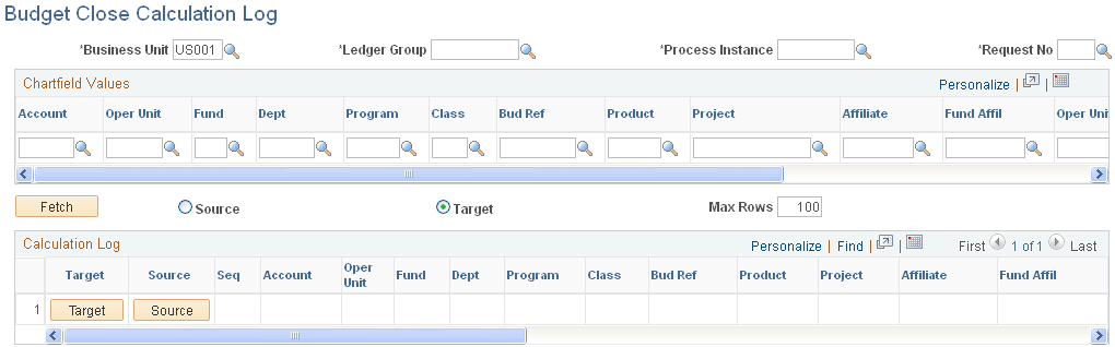

Budget Close Calculation Log Page
Use the Budget Close Calculation Log page (KK_INQ_CLOSE) to view the Calculation Log, which records the results of the Budget Close process.
Navigation:
Commitment Control, Close Budget, Review Calculation Log, Budget Close Calculation Log
This example illustrates the fields and controls on the Review Calculation Log page.
The Source option and the Target option are used to access the associated source or target rows in the calculation log. For example, when you click the Fetch button and you have selected the Target, the scroll is populated with the roll forward (target) amounts in the calculation log. You can then click one of the Source buttons that appears to access a secondary page to see the associated source budget rows stored in the calculation log and determine from where the target amount is coming. The same applies if you elect to display the source amounts first.
