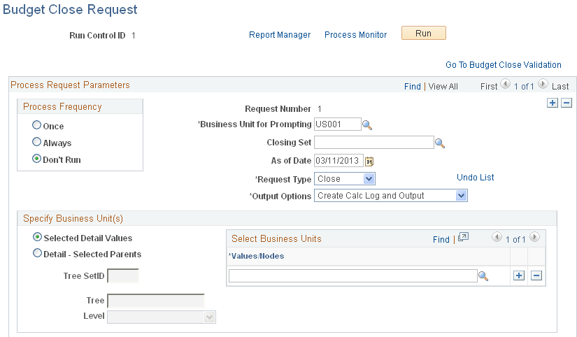

Budget Close Request Page
Use the Budget Close Request page (KK_CLOSE_REQUEST) to request the Budget Close COBOL process (FSPYCLOS) to close or unclose budgets.
Navigation:
Commitment Control, Close Budget, Process Budget Close, Budget Close Request
This example illustrates the fields and controls on the Budget Close Request page. You can find definitions for the fields and controls later on this page.
You cannot run the Budget Close or reduction process until you have run an error-free Closing Run Control Validation process (GLS1211) for the run control ID. The report (GLS1211) validates that no parents or children are missing from a run control, that parents roll forward if children do, and that children roll forward if parents do. You can select whether or not to require that these conditions be met.
Field or Control Description
Go to Budget Close Validation
Click this link to open the Validate Budget Close Run Control page, where you can request a run of the Closing Run Control Validation process for the run control ID.
Business Unit for Prompting
Select a business unit that determines which closing set you can select based on your TableSet control setup.
Closing Set
Select the budget closing set that you want to process.
The description of the closing set functions as a link to the Budget Closing Set page, where you can view the closing set definition.
Note: Take care that your budget closing sets meet your parent-child requirements. Usually, if you close a parent budget, you must close its children. Therefore you must ensure that the closing sets that you create cover all parents and children. Although you can close and roll forward a parent while only closing its children, you must roll forward a parent if its children are set to roll forward. Some parents include children from more than one Commitment Control ledger group (control budget definition). If you require that all parents and children be closed together, be sure that your closing sets either singly or together cover all child Commitment Control ledger groups for all parents. Be sure also that, if children are set to roll forward, parents are as well.
See Validate Budget Close Run Control Page.
See Parent and Child Budgets.
Request Type
Specify whether you are running a close or an undo close. An undo close reopens closed budgets or it can also reinstates reduced budgets.
See Reopening Closed or Reinstating Reduced Commitment Control Budgets.
Undo List
Click to access the Mark for Undo page where you can select the process instance to undo, either a close or reduction.
Output Options
Select one of these options:
  • Create Calc Log − No Output (create calculation log − no output): This option creates the calculation log but does not actually close the budget ledger or create closing journals. Use this option to perform a provisional close, enabling you to see what the closing results would be without actually producing those results.
  • Create Calc Log and Output (create calculation log and output): This option creates the calculation log, closes the budget ledger, and creates the closing journals.
The journals created also depend on whether you chose to roll forward remaining available budget amounts.
Note: Access the calculation log on the Review Calculation Log page.
See Inquiring and Reporting on Budget Closing Results.
Selected Detail Values
Select this option to enter specific business units for closing in the Values/Nodes field.
Detail - Selected Parents
Select this option to specify a business unit tree from which to select the business units. The closing includes all business units for the tree setID, tree, and level that you specify. Select specific tree nodes in the Values/Nodes field.
