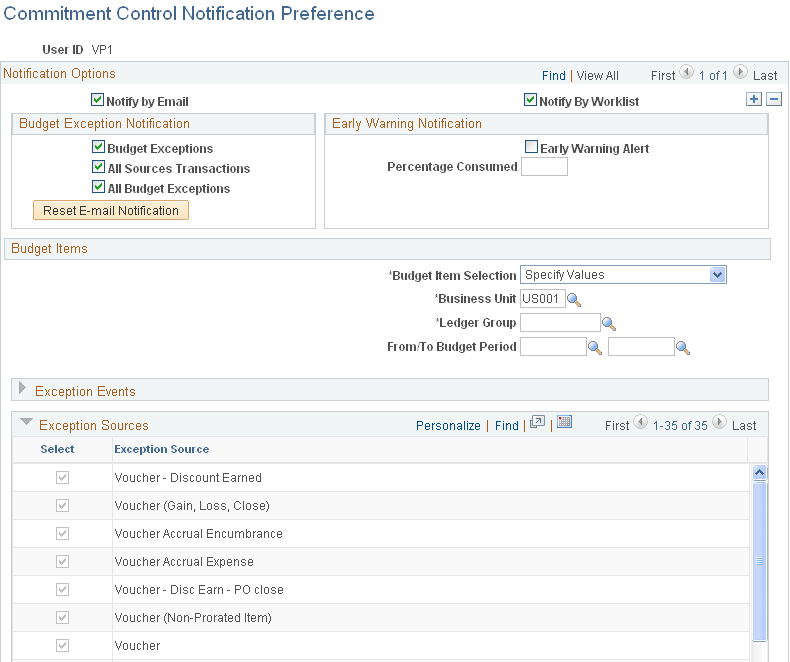

Commitment Control Notification Preference Page
Use the Commitment Control Notification Preference page (KK_NOTIFY_PREFS) to identify early warnings and exceptions for which you want to be notified.
Navigation:
Commitment Control, and then Define Budget Security, and then Define KK Notification Prefs
This example illustrates the fields and controls on the Commitment Control Notification Preference page. You can find definitions for the fields and controls later on this page.
Notification Options
Field or Control Description
Budget Exceptions
Select this check box; then identify the budgets for which you want to receive exception notifications in the Budget Items group box.
Note: You must select either Budget Execution or Early Warning to receive notification. You can select both.
All Sources Transactions
Select to receive exception notification for all transaction sources—vouchers, purchase orders, and so on. Alternatively, you can specify sources in the Exception Sources group box.
All Budget Exceptions
Select to be notified of all exception types. Alternatively, you can specify exception events in the Exception Events group box.
Reset E-mail Notification
Click this button after making changes to your budgets. This clears out the message log and you receive future notifications. A user is notified once through email per budget or exception combination. For example, if budget A has run out of spending authority, then the system issues one message indicating that fact. This prevents a users email from overflowing with the same message every time a transaction fails against budget A. When additional funds have been put into budget A for example, the user then clicks the Reset E-mail Notification button to clear out the log and enable the user to receive future budget exceptions for budget A.
Early Warnings and Percentage Consumed
Select the check box and enter the percentage of the available budget that must be committed or spent before the system triggers an early warning. Then identify the budgets for which you want to receive early warnings in the Budget Items group box.
Note: An early warning notification is re-sent for a given budget combination if the early warning percentage on the preferences page is changed or if the budget amount has changed since the previous notification was sent and the new percentage or amount is at a level that now triggers a notification.
Budget Items
Use the Budget Items group box to identify the ChartFields and Commitment Control budgets to which these notification preferences apply.
Budget Item Selection, Business Unit, and Ledger Group
Specify the ChartField values for which you want budget exception notification:
  • Specify Bus Unit/Ledger Group: Select to receive notification for all ChartField combinations for which you have security within a specific business unit and Commitment Control ledger group combination. Enter the Business Unit and Ledger Group.
  • Specify Business Unit: Select to receive notification for all budgets in all ledger groups for a specific business unit for which you have security. Select a specific business unit in the Business Unit field.
  • Specify Values: Select to specify ChartField values for a specific business unit and Commitment Control ledger group combination.
    You must enter a specific business unit and Commitment Control ledger group. Entry fields for each key ChartField attached to the Commitment Control ledger group appear.
Note: You must have security for the ChartField values you specify.
From/To Budget Period
You can also specify budget periods to further refine your notification preferences.
Exception Events
Exception Event
Select the types of exceptions for which you want notification if you have not selected the All Budget Exceptions check box. You must also select at least one exception source to receive notification.
See Errors and Warnings.
Exception Sources
Exception Source
Select the source transaction types for which you want notification if you have not selected the All Sources Transactions check box. You must also select at least one exception event to receive notification.
When you save your selections, the system validates your choices against the security rules. In addition, the Commitment Control Notify process rechecks security each time it runs.
