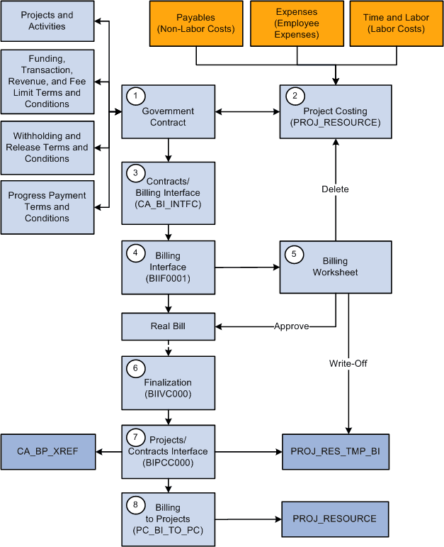

Contracts Billing Process Flow for Government Contracts
After your contract is defined and set up to include all required parameters for the customer, you can begin processing transactions against the contract and billing the customer.
This process flow diagram depicts the billing process flow for government contracts. The numbered steps correspond to the numbers in the diagram:
Contracts billing process flow for government contracts
The PeopleSoft Contracts for Government Contracting bill processing flow includes the following steps:
  1. When defining your contract, depending on the terms and conditions identified by your customer, you may need to enter additional terms and conditions for withholding, fee processing, progress payment processing, limits, and project and activity tracking.
    After you define your contract and complete all of your set up, including defining and assigning all of your contract lines to billing plans and activating the contract, you can begin billing for your contract cost transactions.
  2. Process cost transactions for rate-based contract lines and rate-based contract lines associated with fee types (cost-plus) into PeopleSoft Project Costing.
    This process calls the Pricing Engine, which in turn also calls Limit Processing, evaluating and applying any funded, transaction or revenue limits that are defined for the rate-based contract lines.
  3. Run the Contracts/Billing Interface process.
    This process selects and passes the following data to the Billing Interface:
    • Contract lines and cost transaction rows that are assigned to a billing plan (and events if defined) that are in Ready status.
    • Billing Fee amounts for rate-based contract lines assigned to fee types (cost-plus) processed by the Fee Limit Process, as reviewed and accepted or overridden by the user on the billing fee worksheet page or as calculated by the Fee engine.
      You can optionally review and accept or override the proposed fee amount on the contract line's billing fee worksheet and then submit the fee for processing before the fee amount is included on the contract line's invoice.
      When you manually submit the billing fee worksheet for processing, the system calls the Fee Limit Processor and determines if the fee amount is eligible for processing, and then passes the billing fee amount to the Project Costing Project Transaction tables (PROJ_RESOURCE) where it is selected for processing by the Contracts/Billing Interface.
    • Automatically calls the Withholding process to calculate withholding amounts and generates withholding, withholding release, and withholding write-off rows .
    • Progress payment request rows.
    • Automatically calls the Progress Payment Liquidation process to evaluate and liquidate any outstanding progress payments.
  4. Run the Billing Interface process (BIIF0001) in PeopleSoft Billing.
    The Billing Interface process generates real or temporary bills. Temporary bills are passed to the billing worksheet for evaluation and approval or deletion by the Billing Administrator.
  5. Approve the billing worksheet.
    When you approve a billing worksheet with the billing option of bill, the system creates a real bill with an assigned invoice number and updates PeopleSoft Contracts accordingly. This includes withholding (WTH) and withholding release (WRL) rows. Approved withholding write-off rows (WWO rows where the billing option is write-off) are passed to PeopleSoft Project Costing with a corresponding update to the PeopleSoft Contracts withholding release record. Any rows that are deleted in the billing worksheet are reset in PeopleSoft Contracts and PeopleSoft Project Costing respectively, to be processed the next time the Contracts/Billing Interface process is run.
  6. Run the Finalization process (BIIVC000). Run the Finalization process on the real bill rows created.
    The Finalization process performs a variety of tasks, including calculating taxes (on regular bill rows), setting the invoice date, and calculating the due date.
  7. Run the Projects/Contracts Interface process (BIPCC000). After you run the Finalization process, you run the Projects/Contracts Interface process.
    This process updates PeopleSoft Contracts and PeopleSoft Project Costing with the following data from PeopleSoft Billing:
    • Finalized bill information.
    • Withholding release data.
    • Finalized progress payment request data.
    • Progress payment committed amounts and liquidated amounts.
    • Billing plan statuses are updated to Complete.
  8. Run the Billing to Projects process (PC_BI_TO_PC). Run the Billing to Projects process for rate-based contract lines to update PeopleSoft Project Costing tables with billing, withholding, withholding release, billing and withholding adjustments, and withholding write-off data.
