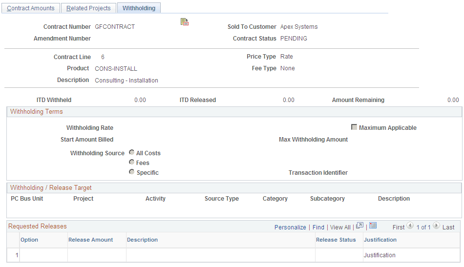

Withholding Page
Use the Withholding page (CA_WTH_TERMS) to define the withholding and release terms for a rate-based contract line.
Navigation:
  • Customer Contracts, and then Determine Price and Terms, and then Contract Terms, and then Withholding
  • Click the Contract Terms link on the Detail tab of the Contract – Lines page. Then, select Withholding.
This example illustrates the fields and controls on the Withholding page. You can find definitions for the fields and controls later on this page.
Withholding page
Entering data on this page and clicking Save indicates that this contract line is withholding applicable and is considered for withholding processing.
After you have indicated that a contract line is withholding applicable, if you do not want the contract line to have withholding processed against it, you can either delete the contract line or enter withholding data for the contract line such that no withholding can be calculated. For example, to enter withholding data that does not trigger withholding calculations, you can enter a withholding rate of zero, a maximum withholding amount of zero, or a very large withholding start amount that would never be reached for the contract line.
Field or Control Description
Product
Displays the product to which the withholding and release terms apply.
Fee Type
Displays the fee type associated with the contract line. Contract lines associated with cost-plus functionality display a fee type of Award, Fixed, Incentive, or Other. Rate-based contract lines that are not associated with cost-plus functionality display a fee type of None.
ITD Withheld (inception to date withheld)
Upon opening the page, displays the amount withheld from billing for the contract line, from the inception date of the contract to the current date . This amount is based on transaction data stored in the Project Transaction table.
ITD Released (inception to date released)
Upon opening the page displays the previous withholding amount released to PeopleSoft Billing for the contract line, from the inception date of the contract to the current date. This amount is based on transaction data stored in the Project Transaction table.
Amount Remaining
Displays the calculated difference between the amount withheld to date and the amount released to date upon opening the page.
Withholding Terms
Withholding Rate
Enter the percentage rate used to calculate withholding amounts on billed and billable project transactions.
Maximum Applicable
Select the Maximum Applicable check box to indicate that there is a maximum amount that can be withheld.
Start Amount Billed
Enter the actual amount that must be processed through to PeopleSoft Billing for the contract line before the system can apply the withholding terms. Leave this field blank for the system to apply the withholding terms for all applicable transactions that occur for this contract line.
Max Withholding Amount (maximum withholding amount)
Enter a maximum amount that can be withheld from the contract line amount. This field can only be populated when the Maximum Applicable check box is selected.
Withholding Source
Select the type of project transactions that are eligible for withholding calculations. Select from:
  • All Costs: Select this option to include every cost associated with the contract line in the withholding calculations.
  • Fees: Select this option to include only fee transaction types associated with the contract line in the withholding calculations.
  • Specific: Select this option to specify the transaction types associated with the contract line to include in the withholding calculations. This option works in conjunction with the Transaction Identifier field.
Select the transaction identifier that the system uses to determine which transactions to include in the withholding calculations for the contract line. Transaction identifiers must first be defined in PeopleSoft Project Costing and enable you to predefine groupings of valid project ChartFields used to identify specific transactions.
Note: You can only specify a transaction identifier if you have selected the Specific withholding source option.
Withholding/Release Target
PC Bus Unit (PeopleSoft Project Costing business unit)
Displays the PeopleSoft Project Costing business unit associated with the rate-based contract line on the Related Projects page.
Project
Select the project identifier that displays on the withholding and release summary lines passed to PeopleSoft Billing from PeopleSoft Contracts and to PeopleSoft Project Costing from PeopleSoft Billing. Select from the projects associated with the contract line on the Related Projects page.
Activity
Select the activity identifier that displays on the withholding and release summary lines passed to PeopleSoft Billing from PeopleSoft Contracts and to PeopleSoft Project Costing from PeopleSoft Billing. Select from the activities associated with the contract line on the Related Projects page.
Source Type
Select the Source Type project ChartField value that displays on the withholding and release summary lines passed to PeopleSoft Billing from PeopleSoft Contracts and to PeopleSoft Project Costing from PeopleSoft Billing. Source types are defined in PeopleSoft Project Costing and enable you to define a value that identifies a transaction's purpose. Source types can be used to track, analyze and report on transactions.
Note: This field is required if the Input Control for Source Type is set to Required on the Project Costing Business Unit-Project Costing Options page.
Category
Select the Category project ChartField value that displays on the withholding and release summary lines passed to PeopleSoft Billing from PeopleSoft Contracts and to PeopleSoft Project Costing from PeopleSoft Billing. Categories are defined in PeopleSoft Project Costing and enable you to further define source types to better track the types of costs occurring against your project and activities.
Note: This field is required if the Input Control for Category is set to Required on the Project Costing Business Unit-Project Costing Options page.
Subcategory
Select the Subcategory project ChartField value that displays on the withholding and release summary lines passed to PeopleSoft Billing from PeopleSoft Contracts and to PeopleSoft Project Costing from PeopleSoft Billing. Subcategories are defined in PeopleSoft Project Costing and enable you to further define source types to better track the types of costs occurring against your project and activities.
Note: This field is required if the Input Control for Subcategory is set to Required on the Project Costing Business Unit-Project Costing Options page.
Description
Enter the description that appears on the billing invoice to describe the withholding invoice line.
Requested Releases
Option
Select the release option for the release amount row. Select from the following options:
  • Bill: Select this option to pass the release row billing data to PeopleSoft Billing and add the release row amount to the invoice as a billable amount.
  • Write-Off: Select this option to write off the release row amount and pass the write off data to PeopleSoft Billing and PeopleSoft Project Costing.
Release Amount
Enter the amount that is released and billed to the customer or written off. This amount must be less than or equal to the remaining amount withheld to date for the contract line.
Description
Enter the description that appears on the billing invoice to describe the released amount invoice line.
Release Status
Displays the processing phase for the release row during release processing. The release row may be set to, or display, one of the following statuses:
  • Pending: Set by the user as a default status. Release rows with a status of Pending are selected and processed by the withholding process.
    Note: You can have only one release row in Pending status for a contract line. No additional rows may be added until the pending row displays a status of Complete.
  • Ready: Set by the user to indicate that the release row is available for processing. The withholding process does not select release rows for processing unless they are set to Ready status.
    Note: You can only have one release row in Ready status for a contract line. No additional rows may be added until the ready row displays a status of Complete.
  • In Process: Set by the system after the withholding process is initiated by the system. Release rows with a status of In Process are display only and cannot be deleted.
    Note: You cannot add any additional release rows if the previous release row has a status of In Process.
  • Complete: Set by the system after the PeopleSoft Billing to Projects/Contacts interface process is run. Additional release rows can only be added after the previous release row has a status of Complete.
