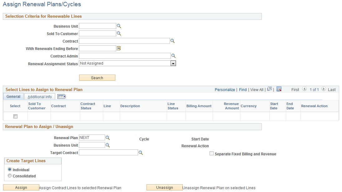

Assign Renewal Plans/Cycles Page
Use the Assign Renewal Plans/Cycles page (CA_RNW_MGMT) to assign renewable contract lines to renewal plans/cycles.
Navigation:
Customer Contracts, and then Define Renewals, and then Assign Cycles
This example illustrates the fields and controls on the Assign Renewal Plans/Cycles Page. You can find definitions for the fields and controls later on this page.
Assign Renewal Plans Cycles Page
When assigning renewable contract lines to a renewal plan, you can assign one or multiple renewal contract lines to one cycle in that renewal plan.
Selection Criteria for Renewable Lines
If you accessed this page by clicking a link on the Contract - General, Contract - Lines, or Define Renewal Plan pages, the system populates these fields based on the information on the precursory page.
Filter search results by PeopleSoft Contracts business unit, sold to customer, contract, or renewal period end date. If you leave all fields deselected, the search retrieves all active, pending, and cancelled renewable contract lines matching the selected renewal assignment status in your system.
Field or Control Description
Renewal Assignment Status
Enables you to filter search results by the following criteria:

Select Lines to Assign to Renewal Plan - General Tab
The system creates a line in the search results scroll area for each contract line that matches your search criteria.
Select
Select the check box in this column for the contract lines that you want to assign to a particular renewal plan. You can select a contract line that is already assigned to a renewal plan; when you click Assign, the contract line is unassigned from the existing plan and then assigned to the value that you select in the Renewal Plan field.

Renewal Plan to Assign / Unassign
Use the fields in the Renewal Plan to Assign/Unassign region to assign the renewable contract lines that you selected in the Select Lines to Assign to Renewal Plan scroll area to an existing renewal plan or a new plan, or to remove them from a renewal plan to which they were assigned.
Renewal Plan
Link contract lines to an existing renewal plan, or select NEXT to link the selected lines to a new renewal plan.

Separate Fixed Billing and Revenue
Displays whether fixed billing and revenue are separated on the targeted contract.
Create Target Lines
Select a value to indicate how the renewals process generates new contract lines. The system uses Individual as the default value for this field. The system copies the value that you select here onto all of the cycles of the renewal plan that is created from this page. Values include:
  • Individual: Select for the renewals process to generate a new contract line for each renewable contract line that is linked to the renewal cycle.
  • Consolidated: Select for the renewals process to generate one new contract line for one or multiple renewable contract lines that are linked to the same renewal cycle.
    Note: You cannot select the Consolidated value for the Create Target Lines option if any of the contract lines being assigned to the renewal plan have billing and/or revenue discounts or surcharges with the Apply at Renewal option selected.
Note: This option is available for entry only if the Renewal Plan field has a value of NEXT. This option is not available when assigning contract lines to an existing renewal plan.
Assign
Click to assign contract lines to the selected renewal plan. The system assigns the renewable contract line to the current cycle of a new renewal plan or to the current cycle of an existing renewal plan.
If the Separate Fixed Billing and Revenue check box is not selected for the target contract and some of the contract lines being assigned to the renewal plan have different billing and revenue amounts, then a warning message will be displayed and the revenue amounts for those lines will be ignored at the time of renewal.
Note: If the renewal action of the selected renewable contract line is different from the renewal action of the renewal cycle, the system warns you that the renewal action of the renewable contract line will be changed to the renewal action of the renewal cycle.
Unassign
Click to remove contract lines from a renewal plan to which they were previously assigned.
