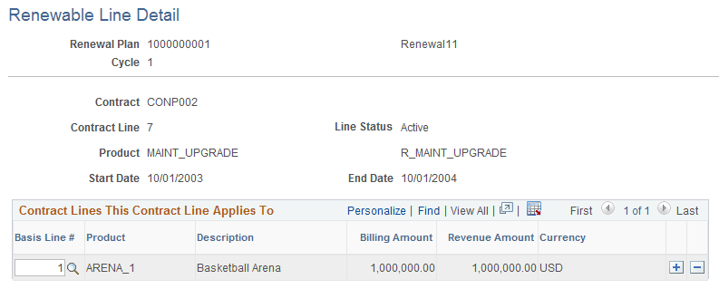

Renewable Line Detail Page
CA_RNW_LINE
Define and update the renewal details of a contract line. For percent-based contract lines, review and edit the list of contract lines to which this contract line applies—for example, a percent-based contract line for a warranty that originally applied to two contract line items but is being renewed for a single contract line item.

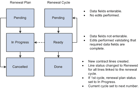

Renewal Statuses
Status values exist at the renewal plan and renewal cycle levels. This diagram shows the flow between the status values and the functionality related to the renewal plan cycle status:
Renewal plan and cycle status flows
Renewal plan status values are:
Term Definition
Pending
When you create a renewal plan, the system sets the status to Pending. The system does not edit-check Pending renewal plans when they are saved.
In Progress
The system sets the renewal plan to In Progress once you approve the first cycle.
Cancelled
You can close the renewal plan manually if you determine that the product or services associated with this renewal plan will not be renewed in the future, or if the product or services are to be assigned to a different renewal plan.
Renewal cycle status values are:
Term Definition
Pending
When you create a renewal plan, the system generates a renewal cycle for that renewal plan. The default status is Pending. You can save your new renewal plan cycles without having to meet the edit-checking requirements that the system enforces on renewal plan cycles with a Ready status. You can only assign contract lines to cycles in Pending status.
Ready
Once you enter data into a renewal plan cycle and assign contract lines to it, you can manually change the status to Ready. The system edit-checks the data. To make changes to a renewal plan cycle in Ready status, reset the status back to Pending. Once you complete the changes, change the status back to Ready (at which point edit-checking validates any updates). Once you save the page in Ready status, the Approve button appears.
Note: The Approve button is available only for renewals with a renewal action of Manual.
Done
The system updates the cycle status to Done when you click the Approve button. Clicking this button indicates that the products specific to the renewal plan cycle were accepted or approved by the customer for the renewal period. Upon completion of the cycle, the system sets the status of the original contract line to Renewed and generates a new, active line for the renewal period specified by the renewal cycle.

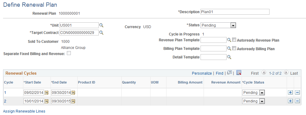

Define Renewal Plan Page
Use the Define Renewal Plan page (CA_RNW_PKG_PNL) to create a new renewal plan or update an existing renewal plan if it has not been associated with a contract (that is, the status of the renewal plan is Pending).
Navigation:
  • Customer Contracts, and then Define Renewals, and then Define Renewal Plan
  • Click the Create Plan button on the Renewals tab of the Contract - Lines page.
This example illustrates the fields and controls on the Define Renewal Plan Page. You can find definitions for the fields and controls later on this page.
Field or Control Description
Unit
Select the PeopleSoft Contracts business unit to which this renewal plan applies.
Target Contract
The contract on which the new renewable contract line is created when the renewal cycle is approved.
Status
Displays the plan status, which controls the updates that can be made to a renewal plan and the processing that can occur against a renewal plan.
Revenue Plan Template
Select a revenue plan template to associate with this renewal plan. If you previously selected a revenue plan template on the associated renewal plan template, that revenue plan template appears. This field is optional.
Autoready Revenue Plan
Select to have the system automatically set the status of the associated revenue plan to Ready upon renewal cycle approval.
This field displays the value that was entered as a default on the renewal plan template for automatic creation of the renewal plan and renewal cycle. You can override the default value here. If you select this check box, the system automatically sets the status of the associated revenue plan to Ready upon renewal cycle approval. If you do not select this check box, the system creates the revenue plan in Pending status.
Note: This option applies only if you selected a revenue plan template.
Bill Plan Template
Select a bill plan template to associate with this renewal plan. If you previously selected a bill plan template on the associated renewal plan template, that revenue plan template appears. This field is optional.
Autoready Billing Plan
Select to have the system automatically set the status of the associated billing plan to Ready upon renewal cycle approval.
This field displays the value that was entered as a default on the renewal plan template for automatic creation of the renewal plan and renewal cycle. You can override the default value here. If you select this check box, the system automatically set the status of the associated billing plan to Ready upon renewal cycle approval. If you do not select this check box, the system creates the billing plan in Pending status.
Note: This option applies only if you selected a billing plan template.
Detail Template
Select a billing plan detail template to associate with this renewal plan. If you previously selected a billing plan detail template on the associated renewal plan template, that revenue plan template appears. This field is optional.
Separate Fixed Billing and Revenue
Identifies whether billing and revenue are separately defined on the target contract.
Renewal Cycles
In the Renewal Cycles grid, define the products and product attributes specific to this renewal plan.

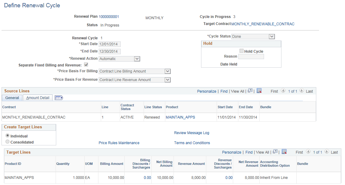

Define Renewal Cycle page
Use the Define Renewal Cycle page (CA_RNW_CYCLE2_PNL) to define the parameters for a renewal cycle and ready and approve the renewal cycle status.
You can also view all contract lines associated with this renewal cycle.
Navigation:
Customer Contracts, and then Define Renewals, and then Define Renewal Cycle
This example illustrates the fields and controls on the Define Renewal Cycle page. You can find definitions for the fields and controls later on this page.
The Target Lines section of this page appears differently depending on whether you selected Individual or Consolidated for the Create Target Lines option.
Renewal Plan
Click to view and manage the details of all renewal cycles associated with the renewal plan.
Target Contract
Click to view and manage the header level details for this contract.
Renewal Action
Appears by default from the value specified on the associated contract line for automatic creation of renewal plans and cycles. For renewal plans and cycles not yet assigned to a contract line, Automatic appears by default in this field. Possible values include Automatic and Manual.
The renewal action drives the behavior of the renewal plan tied to the contract line. With automatic renewals, the system processes the renewal when specified criteria are met.
Note: If you change the value in this field, the system updates the renewal action of the cycle and all renewable contract lines that are linked to the renewal cycle with the new renewal action that you selected.
Price Basis For Billing
Appears by default from the value specified on the associated renewal plan template for automatic creation of renewal plans and cycles. For manual creation of renewal plans and cycles, Contract Line Billing Amount appears by default in this field. The renewals process and reprice functionality use the value in this field to determine the amount to pass to PeopleSoft Enterprise Pricer as the base price for billing for the new contract line. You can accept or override the default value. Possible values include:
  • Contract Line Billing Amount: The system passes the contract line billing amount for each renewable contract line to PeopleSoft Enterprise Pricer.
  • Contract Line List Price: The system passes the contract line list price for each renewable contract line to PeopleSoft Enterprise Pricer.
  • Contract Line Net Billing Amount: The system passes the contract line net billing amount for each renewable contract line to PeopleSoft Enterprise Pricer.
  • Then Current List Price: The system does not pass any amount to PeopleSoft Enterprise Pricer.
    The system uses the list price in PeopleSoft Enterprise Pricer or the product's list price based on the start date of the cycle.
  • User-entered Amount: The system passes the billing amount that you entered in the Target Line group box to PeopleSoft Enterprise Pricer if you selected Consolidated for the Create Target Lines option.
    However, if you selected Individual for the Create Target Lines option, the system passes the billing amount that you entered for each line in the Target Lines grid to PeopleSoft Enterprise Pricer.

Hold Cycle
Select to place the renewal cycle on hold. Selecting this check box enables you to enter a hold reason in the Reason field. The system populates the Date Held field with the current date.
Reason
Select a hold reason code for putting the renewal cycle on hold. This field is accessible only if you selected the Hold Cycle check box.
Date Held
Displays the date that the renewal cycle was put on hold. A value appears in this field only if you selected the Hold Cycle check box.
Source Lines — General
Contract
Displays the contract number of the contract line assigned to this renewal cycle. This contract number may not match the target contract number, depending upon whether you want to create the renewal line on the original contract or create the renewal line on a new contract.
Line
Displays the contract line number assigned to this renewal cycle.
Contract Status
Displays the contract status.
Line Status
Displays the contract line status.
Bundle
Displays the bundle ID.
Source Lines — Amount Detail
Quantity
Displays the quantity for the product on the contract line assigned to this renewal cycle.
UOM (unit of measure)
Displays the unit of measure for the product on the contract line assigned to this renewal cycle.
Billing Amount
Displays the contract line billing amount. You can compare the original contract line billing amount to the billing amount specified for the renewal cycle.
Net Billing Amount
Displays the contract line net billing amount.
Revenue Amount
Displays the contract line revenue amount. You can compare the original contract line revenue amount to the revenue amount specified for the renewal cycle.
Net Revenue Amount
Displays the contract line net revenue amount.
Create Target Lines
Select a value to indicate how the renewals process generates new contract lines. Values include:
Individual
Select for the renewals process to generate a new contract line for each renewable contract line that is linked to the renewal cycle. You can setup details for one or more renewal lines in the Target Lines grid.
Note: The Apply at Renewal revenue discounts will be applied only if renewal cycle type is Individual and the Separate Fixed Billing and Revenue check box is selected for the target contract . If the Separate Fixed Billing and Revenue check box is not selected for the target contract but is selected for the source contract line, then the Apply at Renewal revenue discounts for the source contract lines will not be used.
Consolidated
Select for the renewals process to generate one new contract line for one or multiple renewable contract lines that are linked to the same renewal cycle. You can setup details for one renewal line in the Target Line grid.
Note: You cannot select the Consolidated value for the Create Target Lines option if any of the renewable lines assigned to the renewal cycle have billing and/or revenue discounts or surcharges with the Apply at Renewal option selected.
Price Rules Maintenance
Select to access the Price Rules Maintenance page in PeopleSoft Enterprise Pricer, where you can enter the percent increase or decrease for the renewal cycle.
Review Message Log
Click the link to review messages logged during processing of renewals.
Terms and Conditions
Select to access the Renewal Terms Notes page where you can enter internal contract notes for your renewal plan.
Approve
Click to initiate the manual Renewals process. The system calls the Renewals process to create the data for the new contract line. The renewal process initiated from this page processes Manual renewals only. This button appears on the page only if the Renewal Action is Manual and the Cycle Status is Ready.
When you click the Approve button, the system validates all discounts and surcharges. If any discounts or surcharges are in error, Invalid will appear in the Status column on the Discounts/Surcharges for Individual Target Line page or the Discounts/Surcharges for Consolidated Target Line page. Access those pages to view invalid discounts and drill down further into the discount or surcharge to correct any errors.
Note: You must first click the Reprice button to price the renewable contract lines before running the manual Renewals process.
Reprice
Click to reprice the cycle. On clicking this button, the system passes all price-by fields to PeopleSoft Enterprise Pricer to retrieve the current price. The amount passed to PeopleSoft Enterprise Pricer varies based on the price basis for billing and price basis for revenue options for the associated renewal cycle. PeopleSoft Enterprise Pricer uses the amount passed from PeopleSoft Contracts to calculate the new billing price and revenue price.
Note: At least one renewable contract line must be linked a renewal cycle in order to use the reprice functionality.
Target Lines
The Target Lines section of the page appears differently depending on whether you have selected Individual or Consolidated for the Create Target Lines option.
When you select Consolidated for the Create Target Lines option, this section of the page is titled Target Line instead of Target Lines.
Product ID
Appears by default from the value in the Product ID field in the Source Lines grid if Individual was selected for the Create Target Lines option for the cycle. If Consolidated was selected for the Create Target Lines option, then the value for this field populates with the product ID of the first source line linked to this cycle. The value in this field becomes the product ID on the new contract line generated by the renewals process.
If you change the associated product and the new product has a unit of measure (UOM) default associated with it, the system populates the Unit of Measure field in the grid with this value. If you change the product ID and the product does not have a UOM associated with it, no value appears in the Unit of Measure field in the grid.
Quantity
Displays the quantity for the Product ID of the target line.
Note: If you change the value in this field, click the Reprice button for the system to update the value in the Billing Amount field.
Displays the unit of measure for the Product ID of the target line.
Accounting Distribution Option
Select the accounting distribution option for the renewals process to use to determine whether the accounting distribution for the target line and its discounts and surcharges comes from the default or the source renewable contract line. Values include:
  • Default: Select to associate the accounting distribution for the target line and its discounts and surcharges with the default.
  • Inherit from Line: Select to associate the accounting distribution for the target line and its discounts and surcharges with the source renewable contract line.
Note: For discounts and surcharges, if you select the Inherit from Line accounting distribution option and the same discount or surcharge has been specified for both the target line and the source renewable line, then the system uses the accounting distribution specified for the discount or surcharge of the source renewable line to create the accounting distribution for the discount or surcharge of the renewal line. In all other cases, the system uses the default accounting distribution.
Note: If you want to use the discount accounting distribution specified for the source renewable line, you must specify a valid accounting distribution for the discount of the source renewable line. Otherwise, the system cannot approve the cycle.
Note: This field is available for entry if Individual was selected for the Create Target Lines option for the cycle. If Consolidated was selected for the Create Target Lines option, this field is available for entry only if there is one source renewable line linked to the cycle. If there are multiple source renewable lines linked to the cycle, then Default appears in this field and this value cannot be changed.
Bundle
Specify the bundle for the target line.
The prompt values for this field will vary depending on whether the contract business unit is sharing bundling attributes or not sharing bundling attributes. If bundling attributes are shared, then the prompt will include values created on the Bundling Attributes page ( Set Up Financials /Supply Chain > Product Related > Contracts > General Options > Bundling Attributes). If bundling attributes are not shared then the prompt includes bundling attributes already created on the target contract.
Billing Amount
Displays the billing amount of the target line.
Note: This field is available for entry only if the price basis is User-entered Amount.
Revenue Amount
Displays the revenue amount of the target line.
If the Price Basis for Revenue is User-entered Amount and the Separate Fixed Billing and Revenue check box is selected for the target contract, then this field is available for entry. If the Price Basis for Revenue is not User-entered Amount and the Separate Fixed Billing and Revenue check box is selected for the target contract, then this field is not available for entry and the revenue amounts will be calculated based on the price basis for revenue that is specified for the cycle. If the Separate Fixed Billing and Revenue check box is not selected, then this field will be display only and the value will equal the Billing Amount.
Billing Discounts/Surcharges
Displays the sum of the discounts and surcharges for the target renewal line. Click this link to access either the Billing Discounts/Surcharges for Individual Target Line page or the Billing Discounts/Surcharges for Consolidated Target Line page, where you can enter discounts or surcharges for cycles with a pending status. If the renewal cycle has a ready or done status, the system opens the Billing Discounts/Surcharges for Individual Target Line page or the Billing Discounts/Surcharges for Consolidated Target Line page in display-only mode.
Revenue Discounts/Surcharges
Displays the sum of the discounts and surcharges for the target renewal line. Click this link to access either the Revenue Discounts/Surcharges for Individual Target Line page or the Revenue Discounts/Surcharges for Consolidated Target Line page, where you can enter discounts or surcharges for cycles with a pending status. If the renewal cycle has a ready or done status, the system opens the Revenue Discounts/Surcharges for Individual Target Line page or the Revenue Discounts/Surcharges for Consolidated Target Line page in display-only mode. If the Separate Fixed Billing and Revenue check box is not selected on the target contract then this page will be display only and the amounts will equal Billing Discounts/Surcharges.
Net Billing Amount
Displays the net billing amount of the new contract line. This field is display-only.
The system calculates the net billing amount by applying the discounts and surcharges to the value in the Billing Amount field.
Net Revenue Amount
Displays the net revenue amount of the new contract line. This field is display-only.
The system calculates the net revenue amount by applying the discounts and surcharges to the value in the Revenue Amount field.
If the Separate Fixed Billing and Revenue check box is not selected for the target contract, this amount will equal the Net Billing Amount.
Use the Renewable Line Detail page (CA_RNW_LINE) to define and update the renewal details of a contract line.
Navigation:
Customer Contracts, and then Define Renewals, and then Define Contract Line Renewals
This example illustrates the fields and controls on the Renewable Line Detail Page. You can find definitions for the fields and controls later on this page.
Basis Line # (basis line number)
For percent-based renewable products, select the contract lines to which the renewable product applies. For example, you might renew a contract line that originally provided a warranty for two contract lines, but the renewed warranty applies to a single contract line.
Billing Amount
Displays the billing amount for the selected basis line number.
Revenue Amount
Displays the revenue amount for the selected basis line number.
