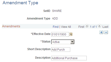

This example illustrates the fields and controls on the Amendment Type page. You can find definitions for the fields and controls later on this page.
Amendment Type page

Amendment Type
Assign a high-level classification to the amendment. Amendment types are dictated by your internal amendment policies. For example, amendment types might be Add, Change Order, New Purchase Order, RMA, Internal Change, and so on.
Note: A predefined amendment type value of ACTV exists and is used by the system. This amendment type is not editable.
Effective Date
Select an effective date for this amendment type.
Status
Set the status for this amendment type. Values are Active and Inactive.
