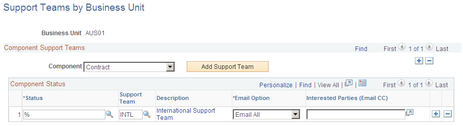

Support Teams by Business Unit Page
Use the Support Teams by Business Unit page (CA_EMAIL_BU) to define the support teams to be used for the workflow that you associate with the different activities within PeopleSoft Contracts.

This example illustrates the fields and controls on the Support Teams by Business Unit page. You can find definitions for the fields and controls later on this page.
