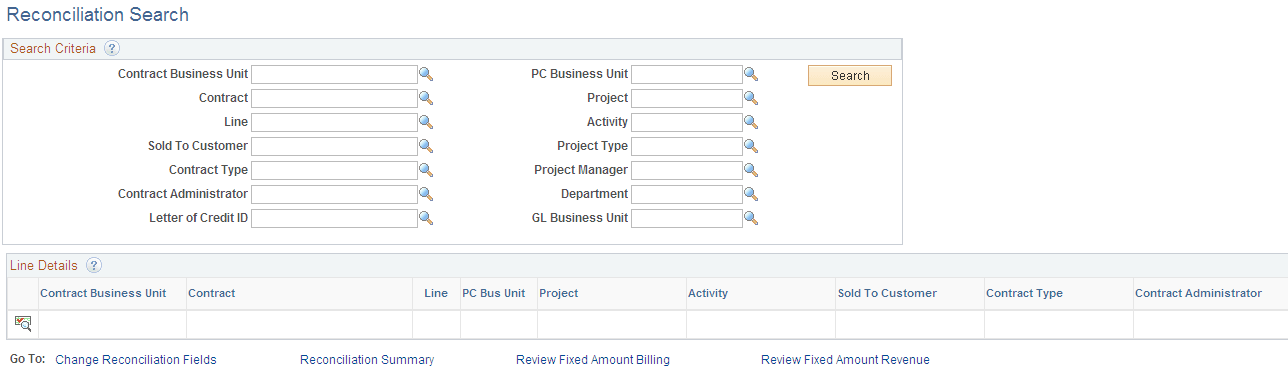

Reconciliation Search Page
Use the Reconciliation Search page (CA_RECON_SEARCH) to select a contract, contract line, project, or project/activity to reconcile.
The fields that appear on this page depend on the parameters that you specified on the Contracts Reconciliation Definition page. You can change these parameters by clicking the Change Reconciliation Fields link. You can search only for rate-based contract lines (value-based or as-incurred billing plans; as-incurred revenue recognition method).
Navigation:
Customer Contracts, and then Adjust Revenue and Billing, and then Reconcile Revenue to Billing
This example illustrates the fields and controls on the Reconciliation Search page. You can find definitions for the fields and controls later on this page.
Search Criteria
Use the fields in the Search Criteria group box to filter the list of contracts or projects for which the system will search. When you leave a field blank, the system runs the process for all values for that field. The search fields that appear on this page depend on the criteria that you specified on the Contracts Reconciliation Definition page.
Field or Control Description
GL Unit
Enter the GL business unit for which you want to search.
Note: If you are using interunit accounting, the reconciliation needs to be shown in one currency. Therefore, enter the GL business unit that you want to view on the Reconciliation Entry page.
For interunit accounting:
  • If you select the GL unit of the contract, you see revenue and interunit (I/U) payables that total all revenue for the entire contract, contract line, project, or project/activity.
  • If you select a GL unit that distributed only a portion of the revenue, you see revenue and the interunit (I/U) receivable sent to that particular GL unit.
Search
Click to initiate your search.

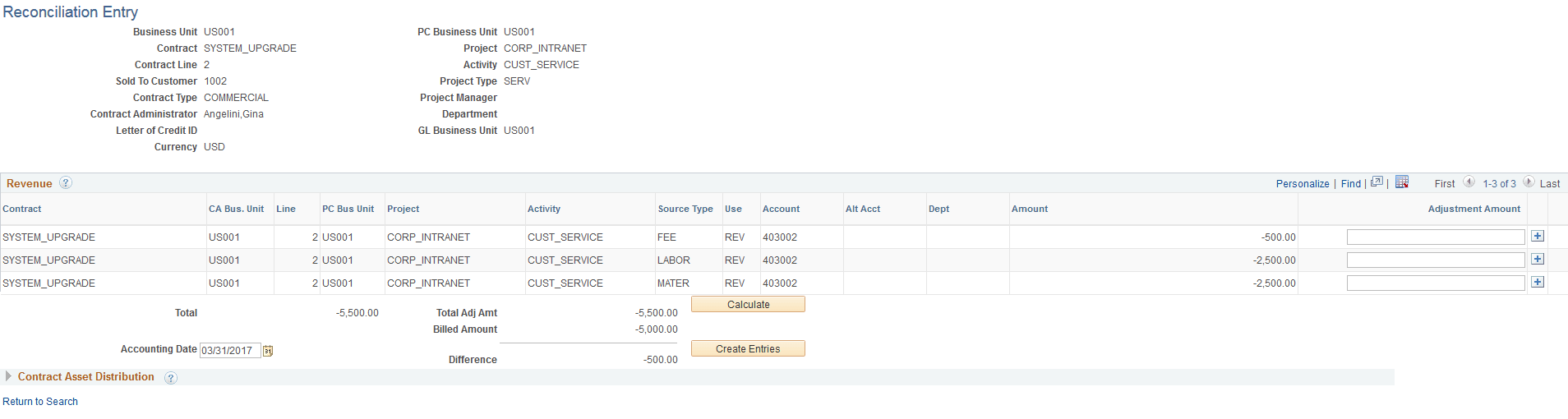

Reconciliation Entry Page
This section discusses how to redistribute revenue to an alternate account and offset the unbilled distribution.
Use the Reconciliation Entry page (CA_RECON_ENTRY) to redistribute revenue to an alternate account and offset your contract asset distribution.
You can book only to GL ChartFields that are included in the break on the Contracts Reconciliation Definition page. ChartFields that you do not break on do not appear on this page.
Navigation:
Click from the Reconciliation Search page.
This example illustrates the fields and controls on the Reconciliation Entry page. You can find definitions for the fields and controls later on this page.
The values that you searched on appear at the top of the page for the line that you selected. These values depend on the review by and break on criteria specified on the Defining Reconciliation Options page. The currency appears in the PeopleSoft General Ledger currency.
To make an adjustment:
  1. Enter the amount of the adjustment for your row.
  2. Click the Calculate button.
  3. Click the Create Entries button.
To redistribute revenue to an alternate account:
  1. Enter the positive amount (debit revenue) for the row that you want to adjust.
  2. Click the + button to add a new row.
  3. Enter the new account, department ID, and affiliate on this new row, in addition to a negative amount (credit for revenue).
  4. Click the Calculate button.
  5. Click the Create Entries button.
Because the total adjusted amount equals 0.00 when you redistribute revenue (because the two rows net out), no contract asset offset is created.

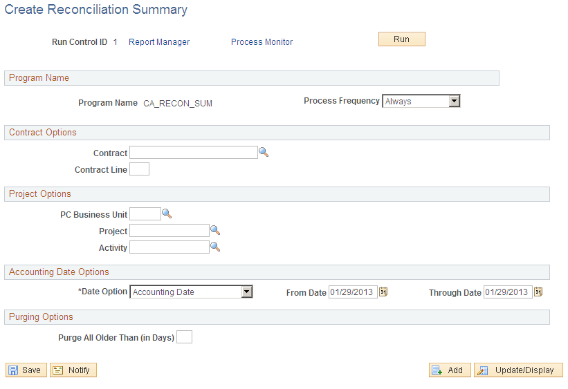

Create Reconciliation Summary Page
Use the Create Reconciliation Summary page (RUN_CA_RECON_SUM) to summarize your reconciliations by running the Reconciliation Summary process.
When the reconciliation process completes, it populates the CA_RECON_REV and CA_RECON_BI tables.
Navigation:
Customer Contracts, and then Adjust Revenue and Billing, and then Create Reconciliation Summary
This example illustrates the fields and controls on the Create Reconciliation Summary page. You can find definitions for the fields and controls later on this page.
When the Reconciliation Summary (CA_RECON_SUM) process completes, it updates the CA_RECON_REV, CA_RECON_BI, and CA_RECON_SUM tables.
Program Name
Process Frequency
Specifies how often the Reconciliation Summary process runs. Values are:
Always: Processes reconciliation every time the Reconciliation Summary process runs.
Don't: Will not initiate the program, even if you click the Run button.
Once: Runs reconciliation once; Don't appears in the Process Frequency field.
Contract Options
Use the fields in the Contract Options group box to filter the list of contracts on which this process runs. When you leave a field blank, the system runs the process for all values for that field.
Project Options
Use the fields in the Project Options group box to filter the list of contracts on which this process runs. When you leave a field blank, the system runs the process for all values for that field.
Accounting Date Options
Use the fields in the Accounting Date Options group box to retrieve and reconcile transactions that fall between the specified dates. Select Acct Dt (accounting date), All, or Trans Dt (transaction date) in the Date Option field.
Purging Options
Purge All Older Than
Enter a number if you want the system to delete all reconciliation records that are older than a specified number of days. If you leave this field blank, the system overwrites only the existing data for the contract for which you are currently running this process.

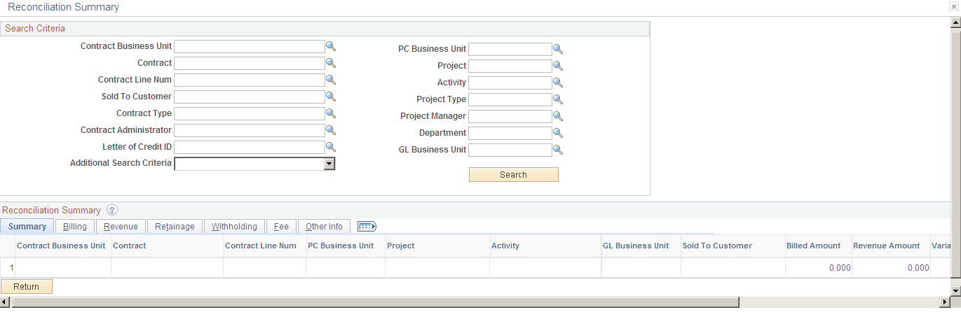

Use the Reconciliation Summary page (CA_RECON_SUM) to view the reconciliation summary results.
Navigation:
Click the Reconciliation Summary link from the Reconciliation Search page.
This example illustrates the fields and controls on the Reconciliation Summary page. You can find definitions for the fields and controls later on this page.
Use this page to view the results from the Reconciliation Summary (CA_RECON_SUM) process. This page provides the difference between billing and revenue at the detail level. Based on the information provided on this page, you can decide where to go to complete the remaining process or to make an adjustment.
