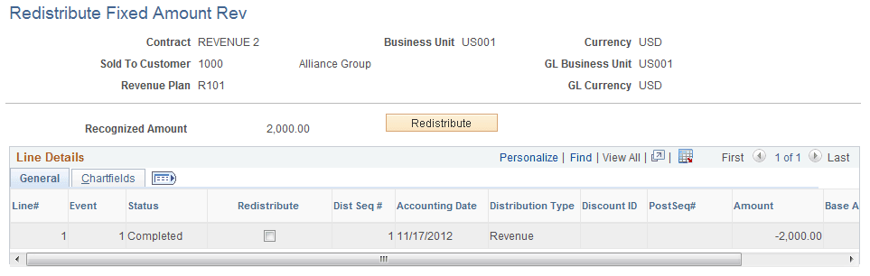

Redistribute Fixed Amount Rev Page
Use the Redistribute Fixed Amount Rev page (CA_AP_SUMMARY) to redistribute revenue accounting lines that the system has generated for a revenue plan event.
The system limits redistribution of revenue to redistributing revenue to different departments.
Navigation:
  • Customer Contracts, and then Adjust Revenue and Billing, and then Redistribute Fixed Amount Rev
  • Click the Redistribute link on the Review Revenue - Plans page.
This example illustrates the fields and controls on the Redistribute Fixed Fee page. You can find definitions for the fields and controls later on this page.
Redistribute Fixed Amount Rev Page: General Tab
Field or Control Description
Line # (line number)
Displays the contract line number that you associated with the revenue plan for this event. As accounting distributions are stored at the contract line level, you may have multiple contract lines associated with a single event number.
Event
Displays the revenue plan event number under which this revenue was booked.
Dist Seq # (distribution sequence number)
Displays the distribution sequence number. Each accounting distribution entry is identified by a unique distribution sequence number.
Amount
Displays the row amount in the transaction currency.
Base Amount
Displays the row amount in the base currency of the contract's General Ledger business unit.

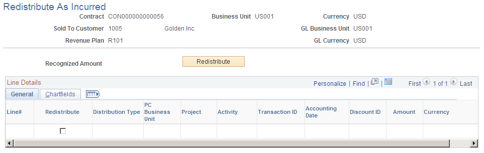

Redistribute As Incurred Page
Use the Redistribute As Incurred page (CA_AP_PC_SUMMARY) to redistribute revenue accounting lines that the system has generated for an as-incurred revenue plan.
The system limits redistribution of revenue to departments only.
Navigation:
Customer Contracts, and then Adjust Revenue and Billing, and then Redistribute As Incurred
This example illustrates the fields and controls on the Redistribute As Incurred page. You can find definitions for the fields and controls later on this page.
Redistribute As Incurred Page: General Tab
Line #
Displays the contract line number that you associated with the revenue plan.
PC Bus Unit (PeopleSoft Project Costing business unit)
Displays the PeopleSoft Project Costing business unit with which a contract line is associated. Each contract line is associated with only one PeopleSoft Project Costing business unit. Each contract line and projects business unit combination is reflected in as many rows as there are unique ChartField string combinations for the project ID, activity ID, and resource ID.
Project
Displays the ID with which this billing is associated. A single project ID can be associated with multiple contracts.
Activity ID
Displays the ID with which this billing is associated. Contract lines are linked to projects at the activity level—directly or indirectly. Each activity ID can be associated with only one rate-based contract line.
Transaction ID
Accounting Date
Displays the accounting date, which reflects the accounting period in which the entries were booked.
Amount
Displays the amount of revenue, in the PeopleSoft General Ledger business unit base currency, that was booked for this row.
