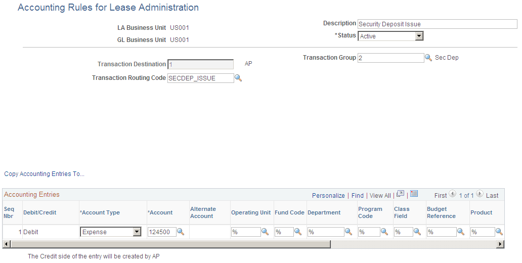

Accounting Rules for Lease Administration Page
CA_ACCT_RULES
Define the accounting rules to apply to PeopleSoft Lease Administration transactions.

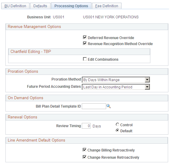

Contracts Definition - Processing Options page
Use the Contracts Definition - Processing Options page (BUS_UNIT_TBL_CA2) to define processing attributes to incorporate flexibility and automation in your PeopleSoft Contracts system when managing revenue, or performing billing and revenue credits and adjustments.
Navigation:
Set Up Financials/Supply Chain, and then Business Unit Related, and then Contracts, and then Contracts Definition, and then Processing Options
This example illustrates the fields and controls on the Contracts Definition - Processing Options page. You can find definitions for the fields and controls later on this page.
Proration Options
Field or Control Description
Proration Method
Values are:
  • By Days Within Range: The system divides the number of days in the schedule period by the number of days in range.
  • Evenly Using all Pds: The system divides the total amount by the total number of periods in the range. Billing and revenue are recognized in equal portions for each transaction created, regardless of the number of days in each schedule period.
Future Period Accounting Dates
Values are:
  • First Day in Accounting Period: Select this option to use the first day in the calendar month of the from date as the accounting date for the transactions created when PeopleSoft CRM sends a recurring transaction to the PeopleSoft Transaction Billing Processor.
  • Last Day in Accounting Period: Select this option to use the last day in the calendar month of the to date as the accounting date for the transactions created when PeopleSoft CRM sends a recurring transaction to the PeopleSoft Transaction Billing Processor.
Use this page when setting up recurring transactions from PeopleSoft CRM. This page is not used for one-time and on-demand transactions.
See Establishing PeopleSoft Contracts Business Units.

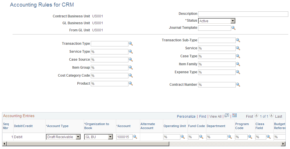

Accounting Rules for CRM Page
Use the Accounting Rules for CRM page (CA_ACCT_RULES) to define the accounting rules to apply to PeopleSoft CRM transactions.
Navigation:
Customer Contracts, and then Create and Amend, and then Define CRM Accounting Distrib
This example illustrates the fields and controls on the Accounting Rules for CRM page. You can find definitions for the fields and controls later on this page.
You can select or deselect combination editing for the Accounting Rules process (PSA_ACCTGGL) on the Contracts Definition - Processing Options page.
Wildcarding—use of the percent sign symbol to indicate any possibility (%)—is supported on this page. Partial wildcarding—the use of alphanumeric symbols in combination with the percent sign symbol—is not.
The fields and functionality of this page are similar to those on the Accounting Rules page in the PeopleSoft Project Costing documentation.
Contract Business Unit
Displays the PeopleSoft Contracts business unit.
Description
Enter a description for the accounting rules.
GL Business Unit (PeopleSoft General Ledger business unit)
Displays the PeopleSoft General Ledger business unit (GLBU) of the sending application. The GLBU defines where the accounting entry is booked. This field is display-only.
Status
Displays the status of the accounting rules. The user controls this status.
From GL Unit (from general ledger unit)
Displays the source PeopleSoft General Ledger business unit. With the exception of employee-related transactions (service orders), this value should always be the same as the value in the GL Business Unit field. This field is display-only.
This field applies to PeopleSoft FieldService and PeopleSoft Support only. This flexibility exists to enable cross-charging revenue to the PeopleSoft General Ledger business unit of the resource who performed the service.
Journal Template
Enter the journal template to attach to accounting entries when they are sent to the PeopleSoft General Ledger system.
Copy Accounting Entries to
Click to copy the accounting entries that you specify in the Accounting Entries group box for use with another set of header criteria.
Accounting Entries
Use this grid to define the accounting debits and credits to create for the specified PeopleSoft CRM transaction. There must be an equal number of debits and credits. When defining accounting rules for billable activity for one-time transactions, you must specify one Contract Liability) accounting distribution. This accounting distribution is stamped on the row when it is sent to PeopleSoft Billing. If you do not establish an Contract Asset, the system does not send the row to PeopleSoft Billing.
During the Accounting Rules process (PSA_ACCTGGL), all transactions are converted to currency based on the PeopleSoft General Ledger currency.
The As Incurred revenue recognition process (PSA_ACCTGGL) is only applicable to one-time transactions.
Seq Nbr (sequence number)
Displays the sequence in which these accounting lines are applied. The sequence number groups the debit and credit together and is used to determine whether interunit entries should be created.
Debit/Credit
Displays whether this accounting line is a debit or credit.
Account Type
Select the type of accounting entry.
Billing Business Unit
Enter a business unit that matches the business unit entered in the GL Business Unit field. This ensures that the receivables accounting entries are booked to the same PeopleSoft General Ledger business unit as the contract asset account.
This field appears only if the account type is Contract Asset.
Organization to Book
Values are:
  • GL BU: Select this value to have the accounting line booked to the PeopleSoft General Ledger business unit specified in the GL Business Unit field in the header area of this page.
  • From GL BU: Select this value to have the accounting line booked to the PeopleSoft General Ledger business unit specified in the From GL Unit field in the header area of this page. This field may represent the PeopleSoft General Ledger business unit of the resource who performed the service. By specifying From GL BU here, the system books the accounting to the resource's organization.
See PeopleSoft Project Costing: Defining Accounting Rules.
Use the Accounting Rules for Lease Administration page (CA_ACCT_RULES) to define the accounting rules to apply to PeopleSoft Lease Administration transactions.
Navigation:
Set Up Financials/Supply Chain, and then Product Related, and then Lease Administration, and then Accounting, and then LA Accounting Rules
This example illustrates the fields and controls on the Accounting Rules for Lease Administration page. You can find definitions for the fields and controls later on this page.
LA Business Unit
Displays the PeopleSoft Lease Administration business unit that was entered when creating the accounting rules.
Description
Status
Displays the status of the accounting rules. The user controls this status. Inactive rules are not used during rules matching.
Transaction Destination
Identifies where the system sends the transaction. If the value in the Transaction Destination field is BI (PeopleSoft Billing), then PeopleSoft Billing manages revenue for on-demand transactions. PeopleSoft Billing uses the accounting rule to retrieve the revenue credit side of the accounting entry that it needs to offset the Accounts Receivable side of the entry. If the value in the Transaction Destination field is AP (Accounts Payable manages expense) or GL (PeopleSoft General Ledger), during processing, PeopleSoft Lease Administration calls the accounting rules to populate specific accounting rule entries in the PeopleSoft Lease Administration tables. PeopleSoft Lease Administration then sends the accounting entries in this table to either Accounts Payable or PeopleSoft General Ledger.
Note: You select the transaction destination value when adding a new accounting rule prior to reaching the Accounting Rules for Lease Administration page. You cannot change this value.
This field is not enterable.
Transaction Group
Select a transaction group to indicate the type of PeopleSoft Lease Administration transaction. The system uses the value in this field to create journal entries. Possible field values include: Base Rent, Security Deposit, Straight-line Accounting, Operating Expense, Percent Rent, Miscellaneous Rent, and Manual Fee.
Transaction Routing Code
Select a transaction routing code. You can define unique accounting rules by specifying the transaction routing code for a specific transaction group.
Accounting Entries
Use this grid to define the accounting debits and credits to create for the specified PeopleSoft Lease Administration transaction. There must be an equal number of debits and credits.
Debit/Credit
Displays whether this accounting line is a debit or credit. This field corresponds with your Account Type field selection.
Note: For PeopleSoft Lease Administration, the system allows a credit entry only if the value in the Transaction Destination field is BI and a debit entry only if the value is AP.
Account Type
Account
Select the account for this transaction.
Alternate Account
Select the alternate account for this transaction.
Select optional ChartField values for additional fields on this page. The values that you select here override the values in the transaction record.

Contracts Definition - Processing Options Page
Navigation:
On Demand Options
Bill Plan Detail Template ID
Select a bill plan detail template ID to use to override the fields on the billing plan. If you select a template on this page, when the billing plan is created, the billing plan detail template overrides the corresponding fields on the billing plan.
This page is available for on-demand transactions only.
