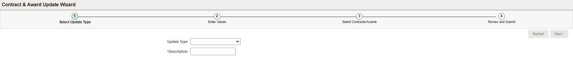

This example illustrates the fields and controls on the Contract & Award Update Wizard page.

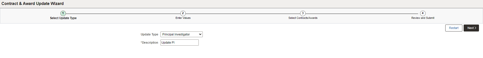

Select Update Type Page
Use the Select Update Type page (CA_UPDWIZ1_FL) to identify and select an update type from the available options.
Navigation:
Fluid Home page, and then Contract & Award Update Wizard
This example illustrates the fields and controls on the Select Update Type page. You can find definitions for the fields and controls later on this page.
Contract & Award Update Wizard - Select Update Type page
Field or Control Description
Update Type
Select the information to be updated. The available options are listed in alphabetical order. Options include:
  • Assistance Listing Number
  • Award Reporting Roles
  • Award Status
  • Billing Specialist
  • Contract Administrator
  • Post Award Administrator
  • Principal Investigator
Update Description
Describe the update to be processed.
Restart and Next
These buttons are enabled after you enter the update type.
  • Restart: Click to cancel the current update and begin a new one.
  • Next: Click to proceed to the next step.

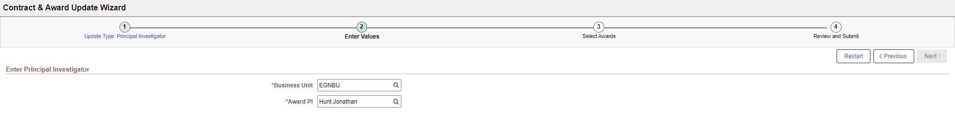

Enter Values Page
Use the Enter Values page (CA_UPDWIZ2_FL) to enter the new values to be used on the update. The display of the fields depends on the update type you selected in the previous step.
Navigation:
After entering the update type, click the Next button.
This example illustrates the fields and controls on the Enter Values page.
Contract & Award Update Wizard - Enter Values page
In this example, new Award PI information is entered.
After entering the new values, click the Next button to proceed to the Select Contracts/Awards step.

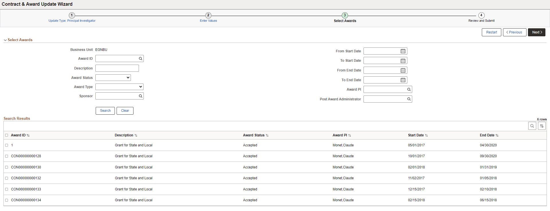

Select Contracts/Awards Page
Use the Select Contracts/Awards page (CA_UPDWIZ3_FL) to select contracts and awards to be updated. This page displays information based on the update type you selected in the first step. You might see separate search criteria allowing you to locate specific values for the update process.
Navigation:
After entering the new values in step 2, click the Next button.
This example illustrates the fields and controls on the Select Contracts/Awards page.
Contract & Award Update Wizard - Select ContractsAwards
You can search for contracts and awards by entering a variety of search criteria. Select the check boxes of the contracts or awards you want to update in the Search Results, then click Next to move on to the Review and Submit step.

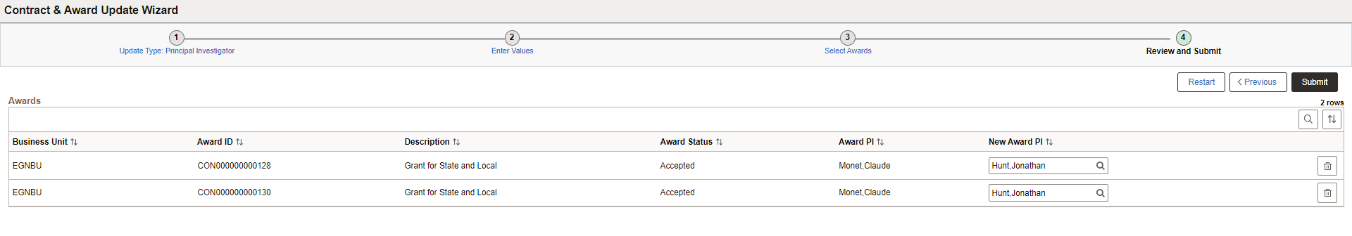

Review and Submit Page
Select the Review and Submit page (CA_UPDWIZ4_FL) to review your changes to the selected contracts or awards and submit the update. This page displays information based on the updated data. It displays all the fields being updated, in addition to other crucial information.
Navigation:
After selecting the required contracts or awards in the Select Contracts/Awards step, click the Next button.
This example illustrates the fields and controls on the Review and Submit page.
Contract & Award Update Wizard - Review and Submit
Select the Delete icon to remove a row from the update wizard.
The page displays both the current and new field values. You can make further changes to the new fields before submitting them. Then, click the Submit button.

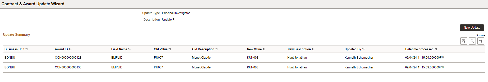

A confirmation page displays the contracts or awards are updated through the process.
This example illustrates the fields and controls on the Review and Submit - Confirmation page.
Contract & Award Update Wizard - Update Confirmation
Update Summary
Displays the updated status of each field.
New Update
Click this button to return to the Select Update Type step in the Project Update Wizard and begin a new update.
You can follow the same steps to update the other contracts or awards.
