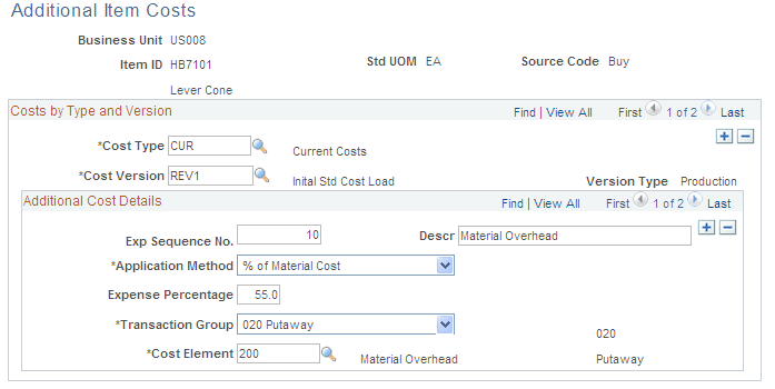

Use the Additional Item Costs page (CE_ITEMEXP) to add additional costs to purchased or makeable items.
Navigation:
Cost Accounting, and then Item Costs, and then Define Rates and Costs, and then Additional Item Costs, and then Additional Costs by Item
To define additional costs, use the Additional Costs by Item component (CE_ITEMEXP).
This example illustrates the fields and controls on the Additional Item Costs page. You can find definitions for the fields and controls later on this page.
You can add additional costs to the cost of a manufactured or purchased item by using the Additional Item Costs page. This enables the system to calculate and track the fully burdened cost of the item. Examples of additional costs are duty, freight, inspection, procurement expenses, and material handling. Based on the cost type and cost version combination that is defined for the business unit and item and entered on the Cost Rollup page, the system adds these additional costs, one cost at a time. These costs are applied after all labor, machine, material, and overhead costs are added.
When you use this page to add landed cost components to an item, you can track and analyze the total landed cost for that item. You can set up consigned items as landed cost items; if you do, the system transacts all accrued landed cost charges when the consigned item is consumed.
The Exp Sequence No (expense sequence number) determines the order in which the system applies costs; it is especially critical when it applies the rate to the total cost. The total cost base includes material, labor, machine, subcontracting, overhead costs, and any additional cost that was previously applied to that point.
