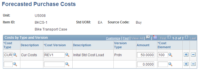

Forecasted Purchase Costs Page
To define forecasted purchased costs, use the Forecasted Purchase Cost (CE_FCST) component. Use the Forecasted Purchase Rates component interface to load data into the tables for this component.
Use the Forecasted Purchase Costs page (CE_FCST) to enter forecasted purchase costs.
Navigation:
Cost Accounting, and then Item Costs, and then Define Rates and Costs, and then Forecasted Purchase Costs, and then Forecasted Purchase Cost
This example illustrates the fields and controls on the Forecasted Purchase Costs page. You can find definitions for the fields and controls later on this page.
Use the Forecasted Purchase Costs page to use negotiated prices for the purchased components in the calculation of makeable items. This enables you to perform what-if scenarios or simulations by changing the material cost assumptions for each cost type and version combination. The amount that is entered should be the cost of the item only, exclusive of any freight, duty, or procurement expenses. The cost element that is selected must have a cost category of Material assign on the Cost Elements page.

Amount
Enter the cost of the item only, exclusive of any freight, duty, or procurement expenses.
Field or Control Description
Cost Element
Enter a cost element with a cost category of material assign on the Cost Elements page.
Be sure that the cost type that you enter designates forecasted purchase costs as the purchase cost that is used. If you use forecasted purchase costs, you must define a cost for every purchased item.
