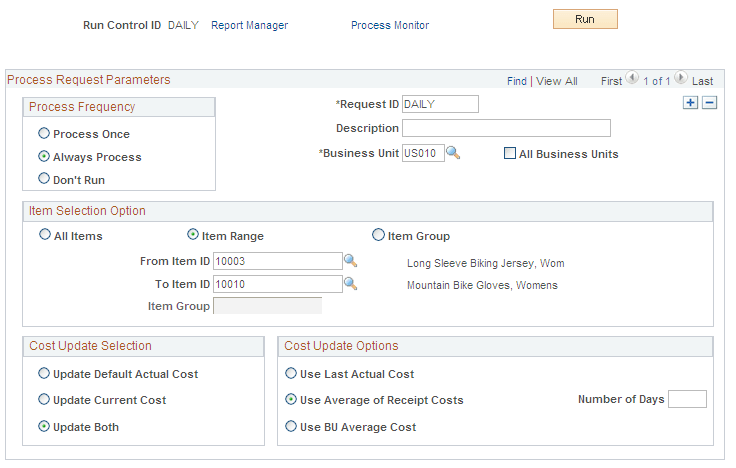

Update Default Actual Cost Page
Use the Update Default Actual Cost page (RUN_CM_DFLTCOST) to calculate the value to be stored in the Default Actual Cost field or the Current Purchase Cost field on the Define Business Unit Item - General: Common page.
Navigation:
Cost Accounting, and then Item Costs, and then Update Costs, and then Update Default Actual Cost
This example illustrates the fields and controls on the Update Default Actual Cost page. You can find definitions for the fields and controls later on this page.
Use the Update Default Actual Cost process to update the cost fields Default Actual Cost (DFLT_ACTUAL_COST) and Current Purchasing Cost (CURRENT_COST) in the Define Business Unit Item - General: Common page (BU_ITEMS_INV).
Field or Control Description
Business Unit
Enter the PeopleSoft Inventory business unit in which the process updates the cost fields for item IDs in that business unit. All items meeting the search criteria on this page are updated, regardless of the cost profile used.
All Business Units
Select all Inventory business units. The process updates the cost fields for the specified item IDs in all of the business units.
If row-level security is enabled, then the user must have security access to all of the Inventory business units for the process to run the cost calculations.
All Items
Select this option to include all items in the business units that meet the search criteria of this page.
Item Range
Select this option to define a range of item IDs to be processed.
Item Group
Select this option to define an item group ID to be processed.
From Item ID and To Item ID
Enter a range of item IDs to be processed. The system includes all items in the alphanumeric sequence. The Item Range option must be selected to enter values in these fields.
Item Group
Enter an item group ID to be processed. The Item Group option must be selected to enter a value in this field.
If the Item Group option is selected and the Item Group field is left blank, then the process includes only the items that do not have an item group assigned on the Define Item - General: Common page (MASTER_ITEM_TBL table).
Cost Update Selection
Select the cost fields to be updated by this process. The options are:
  • Update Default Actual Cost: Select to update the value in the Default Actual Cost field (DFLT_ACTUAL_COST) in the Define Business Unit Item - General: Common page (BU_ITEMS_INV).
  • Update Current Cost: Select to update the value in the Current Purchasing Cost field (CURRENT_COST) in the Define Business Unit Item - General: Common page (BU_ITEMS_INV).
  • Update Both: Select to update the values in the Default Actual Cost field and the Current Purchasing Cost field in the Define Business Unit Item - General: Common page. Both fields are updated with the same cost calculation.
Cost Update Options
Choose the method to update the cost fields. The options are:
  • Use Last Actual Cost: The value in the cost field is based on the last receipt cost in CM_ACTUAL_COSTB table for the selected item The process combines all of the cost elements in the last receipt. If the items included in your selection criteria do not have any receipts in the business unit, then the process cannot update the cost fields.
  • Use Average of Receipt Costs: The value in the cost field is base on a weighted average of receipt costs over the past number of days, starting with the current date. Enter the number of days in the Number of Days field in this group box. The Number of Days field is required when this option is selected. This calculation excludes any cancelled receipts and then averages all of the receipt costs. If the items included in your selection criteria do not have any receipts in the business unit, then the process cannot update the cost fields.
  • Use BU Average Cost: The value in the cost field is current value in the Average Purchase Price field (AVERAGE_COST) on the Define Business Unit Item - General: Common page (BU_ITEMS_INV).
Number of Days
Enter the past number of days' worth of receipts to be used to calculate the weight average for the transfer price. The field is required when the option Use Average of Receipt Costs is selected.
