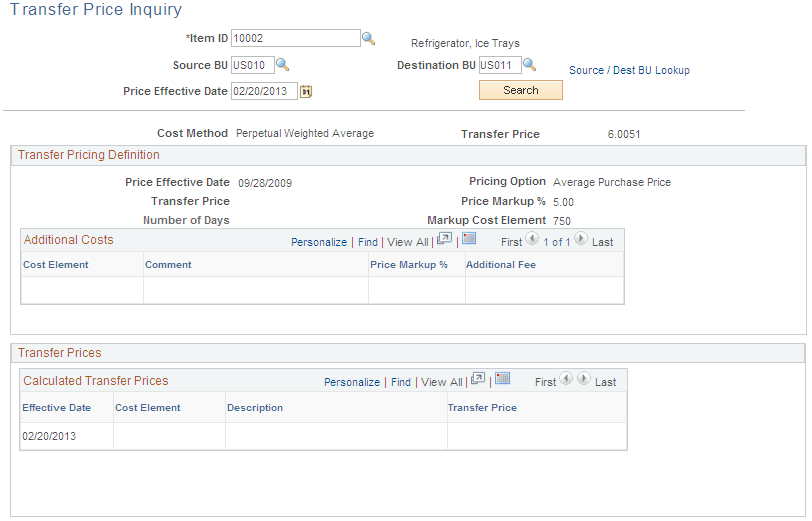

This example illustrates the fields and controls on the Transfer Price Inquiry page. You can find definitions for the fields and controls later on this page.
The Transfer Price Inquiry page displays the transfer pricing details for the combination of a specific item ID, source business unit, destination unit, and price effective date.

Click this button to search for transfer pricing data based on your entries in the Item ID, Source BU, Destination BU, and Price Effective Date fields.
Source / Dest BU Lookup
Click this link to access the Source / Dest BU Lookup page, where you can view the source and destination business unit pairs that were created for the item.
Cost Method
Displays the Deplete Cost Method from the Cost Profile used for this item ID in the source Inventory business unit.
Transfer Price
Displays the transfer price that would be used for this item. In some cases, the most current transfer price is determined by the Deplete On Hand Qty process; therefore, this price may be just an estimate.
The field is calculated at the time of display using the transfer pricing hierarchy defined in this topic.
See Applying Transfer Prices to a Material Stock Request.
Transfer Pricing Definition Group Box
This group box displays the values from the Transfer Pricing Definition component that apply to this item ID based on source unit, destination unit, and price effective date. The data displays any override values entered at the item ID or item group level as well as any additional cost data from the Additional Transfer Price page.
Transfer Prices Group Box
This group box displays values from the Transfer Pricing table. This table is optional and is populated by the Calculate Transfer Price process.
