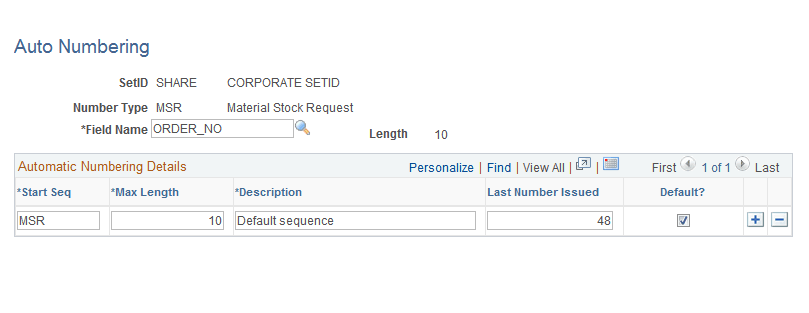

Auto Numbering Page
Use the Auto Numbering page (AUTO_NUM_PNL) to define a numbering scheme to create group schedule IDs.
The numbering scheme is defined by SetID and the number type Schedule Group ID. You cannot create groups until you establish a numbering sequence.
Navigation:
Set Up Financials/Supply Chain, and then Common Definitions, and then Codes and Auto Numbering, and then Auto Numbering, and then Automatic Numbering
This example illustrates the fields and controls on the Auto Numbering page. You can find definitions for the fields and controls later on this page.
Auto Numbering page
Field or Control Description
Number Type
Enter Schedule Group ID to set up automatic numbering for schedule groups.
Field Name
Select the value CE_GRP_PID_ID for automatic numbering. This automatic numbering field is 10 characters long.
Start Seq (start sequence)
Enter a prefix using three characters. One or more prefixes can help identify the type of schedule group. For example, you may want to use a unique prefix of ALT for production schedules in the Atlanta plant and LDN for production schedules in the London plant.
Max Length (maximum length)
Enter maximum length of the schedule group ID. 10 or less characters can be entered.
Last Number Issued
Enter a numeric value to start the automatic numbering. The system starts by increasing in increments of one the last number that is issued.
Note: This field cannot be zero or blank. You must enter a value.
Default
If you create more than one numbering sequence for this number type, indicate the default sequence.

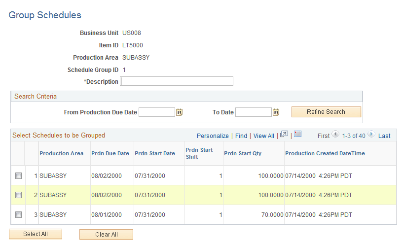

Group Schedules Page
Use the Group Schedules page (CE_GROUP_PID) to group one or more production schedules into a schedule group for costing actual and average costs make items.
Navigation:
Cost Accounting, and then Item Costs, and then Update Costs, and then Group Schedules for Costing
This example illustrates the fields and controls on the Group Schedules page. You can find definitions for the fields and controls later on this page.
To cost make items using actual or average costing, you must place production schedules in a group. Use this page to add one or more production schedules to a new or existing schedule group ID. When you enter this page, the system displays all available production schedules based on the business unit, item ID, and production area. You can refine the search to include the due dates from and to production. The search results only display production schedules that are not currently attached to a group. Select the production schedules to add to the schedule group ID, enter a Description (required), and save the page.

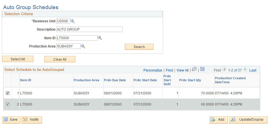

Auto Group Schedules Page
Use the Auto Group Schedules page (CE_AUTOGRP_PID) to group one production schedule into one schedule group for costing actual and average cost make items.
Navigation:
Cost Accounting, and then Item Costs, and then Update Cost, and then Auto Group Schedules
This example illustrates the fields and controls on the Auto Group Schedules page. You can find definitions for the fields and controls later on this page.
To cost make items using actual or average costing, you must place production schedules in a group. Use this page to add one production schedule to one schedule group ID. You can create multiple schedule groups at one time by selecting one or more production schedules. The system creates one group ID for each separate production schedule when you save this page.

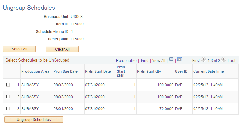

Ungroup Schedules Page
Use the Ungroup Schedules page (CE_UNGROUP_PID) to remove production schedules from a schedule group.
Production schedules cannot be removed after the Transaction Costing process (within the Cost Accounting Creation process) is run.
Navigation:
Cost Accounting, and then Item Costs, and then Update Cost, and then Ungroup Schedules
This example illustrates the fields and controls on the Ungroup Schedules page. You can find definitions for the fields and controls later on this page.
Use this page to remove production schedules from a schedule group ID. This can only be done before the Transaction Costing process (within the Cost Accounting Creation process) is run for this schedule group ID or any transaction included in this group.
If a schedule group ID is created with certain production schedules and then later you remove all the production schedules from the group, then the schedule group ID cannot be used again for a different set of production schedules.
