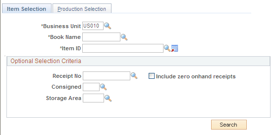

Adjust Actual Cost - Item Selection Page
Use the Adjust Actual Cost - Item Selection page (CM_COSTADJ_PARM) to specify the item information to adjust an actual cost item.
Navigation:
Cost Accounting, and then Item Costs, and then Update Costs, and then Adjust Actual Cost, and then Item Selection
This example illustrates the fields and controls on the Adjust Actual Cost-Item Selection page. You can find definitions for the fields and controls later on this page.
Use this page to search for the receipt to be adjusted. You can find the receipt by:
  1. (required) Entering the business unit, cost book name, and item ID for which you want to update the actual cost.
    You can select only those items that are actual costed in at least one business unit book.
  2. (optional) Refining the search by selecting a specific Receipt No (receipt number).
    You can include or exclude consigned receipts by selecting B (include both), N (exclude consigned items), or Y (include consigned items). You can also specify a receipt to a specific storage area.
  3. Click the Search button after you make selections.
    The system automatically displays the results of the search on the Adjustment Detail page.

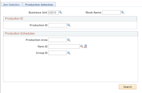

Adjust Actual Cost - Production Selection Page
Use the Adjust Actual Cost - Production Selection page (CM_ACTC_INQUIRY) to specify the manufacturing information to adjust an actual cost item.
Navigation:
Cost Accounting, and then Item Costs, and then Update Costs, and then Adjust Actual Cost, and then Production Selection
This example illustrates the fields and controls on the Adjust Actual Cost-Production Selection page. You can find definitions for the fields and controls later on this page.
Use this page to search for the receipt that is to be adjusted for production information. You can find the receipt by:
  1. (required) Entering the business unit, and cost book name.
  2. (required) Entering either a production ID or production area and item ID.
  3. (optional) Entering a group ID for production schedules.
  4. Click the Search button after you make the selections.
