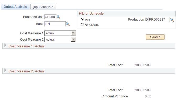

This example illustrates the fields and controls on the Compare Cost Measures - Output Analysis page. You can find definitions for the fields and controls later on this page.
Review and compare the cost calculations for a production ID at various stages of production. Enter the business unit, cost book, production ID or production schedule for the production costs that you want to review.
Field or Control Description
Cost Measure 1 and Cost Measure 2
Enter the two cost measures to compare for this production ID or production schedule. Cost measures represent the current costs at various stages of production. Cost measures include:
  • Actual: The current actual costs of this production ID or production schedule.
  • As Planned: Cost captured before while the production ID still reflected the planned production and before changes in the production process. These costs are captured by sequence number by using the Proactive Production Cost - PID Cost.
  • As Produced: Costs captured after the production ID is released to production and altered to better suit the current production environment. These costs are captured by sequence number by using the Proactive Production Cost - PID Cost.
  • Frozen Standard: The frozen standard costs that are used for this production ID or production schedule.
  • Other: Cost captured (by sequence number) using the Proactive Production Cost - PID Cost for costs that are not identified as planned or produced.
Seq Nbr (sequence number)
Enter the sequence number that uniquely identifies the captured costs that use the Cost Measure of As Planned, As Produced, or Other.
Search
Select to display the costs for Cost Measure 1 and Cost Measure 2.
