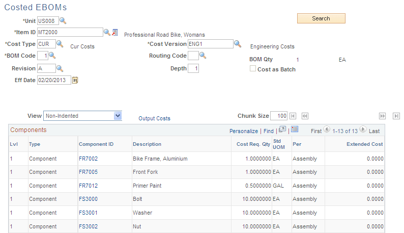

Costed BOM Page
Use the Costed BOM page (EN_BOM_INQ_COSTED) to displays component costs based on the item's manufacturing BOM or engineering BOM.
You must run the Cost Rollup process for the BOM code and routing code combination to display the costs on this page.
Navigation:
  • Manufacturing Definitions, and then BOMs and Revisions, and then Review BOM Information, and then Costed BOMs, and then Costed BOM
  • Engineering, and then BOMs and Revisions, and then Review EBOM Information, and then Costed EBOM, and then Costed EBOM
This example illustrates the fields and controls on the Costed BOM inquiry page. You can find definitions for the fields and controls later on this page.
Another method of viewing a manufactured or engineering item's cost is to use the Costed BOM page or the Costed EBOM page. You can display the costs of an assembly, its components, and outputs according to cost type and cost version. This is especially useful for determining the costing impact of manufacturing BOM changes on an assembly. Use cost types for costing simulations, to perform what-if analyses, or to calculate new standard costs prior to updating. Cost versions are iterations of a particular cost calculation for a cost type. You can have multiple versions for each type. You cannot use these inquiry pages for configured items.

Cost as Batch
If the output is one single item ID, then select this check box to view the costs and quantities for the entire batch instead of a single unit of the item. If the item has co-products, then the costs and quantities of the batch appear. In addition, for each of the components, the check box controls whether the per unit costs are multiplied by the BOM quantity to get a batch cost instead of a per unit cost.
Depth
Enter the number of levels of the BOM to include. To ensure the costs include all changes at the lower levels and choose the maximum depth of a BOM. This is important for revision-controlled BOMs.
Output Costs
Click this link to access the Output Costs page, where you can view all lower-level costing details for each output product based on the costing percentage split. Also, the Output Items link on the Output Costs page enables you to view these costs by cost element.
Co-Products
Click this link to access the Output List page, where you can view any co-products associated with the component. This link is only available if co-products are present.
Component ID
Click this link to access the Component Detailed Costs page, where you can view the detailed costs of the component according to cost element.
Due to rounding differences, it is possible you could see a small variance (+ or − 0.0003) between the cost version costs and the inquiry costs in this inquiry. This occurs when the system displays the costed BOM results for an item that is either a batch item or has batch assembly items at lower levels.
