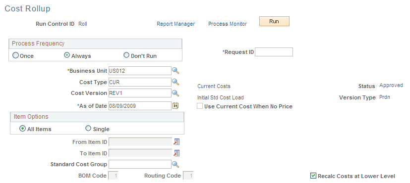

Cost Rollup Page
Use the Cost Rollup page (CE_ROLLUP_REQ) to run this process to calculate the standard cost for makeable items.
Based on the cost type and version, you can rollup any combination of BOM and routing for production, configured, engineering, simulations. The process calculates the cost of co-products and by-products.
Navigation:
Cost Accounting, and then Item Costs, and then Update Costs, and then Cost Rollup, and then Cost Rollup
This example illustrates the fields and controls on the Cost Rollup page. You can find definitions for the fields and controls later on this page.
Cost Rollup page
Use the Cost Rollup page to perform a cost rollup for a single item, a range of items, a group of items, or all items for any BOM and routing combination within a business unit, as well as for any cost type and cost version.

Field or Control Description
Cost Type and Cost Version
Select the combination that you want to calculate. The cost type and version determine the set of labor, machine, and overhead rates or costs, plus the purchase costs and additional costs PeopleSoft Cost Management uses in the cost calculation.
Version Type
On the Cost Versions page, you select a version type. The version type that you select has a direct impact on the Cost Rollup page. If the version type is Prdn (production), the system changes to the primary BOM and Routing Codes for all levels and the BOM Code and Routing Code fields appear. If the version type is Eng (engineering) or Sim (simulation), then select any combination of BOM and routing codes and the system rolls up the cost for reporting and comparison only.
As of Date
Determines which of the assembly's components to include on the item's bill when the system calculates the item's material and lower-level costs. The rollup includes any component that is effective on the bill as of the date specified. The as of date also refers, in a multiple output scenario, to by-product effectivity dates. Configured items do not use the as of date but use the components that are on the component list.
Use Current Cost When No Price
Select to ensure that all purchased items have a cost. If the method of calculating the cost of purchased items results in zero or a nonexistent price, then zero is replaced with the current purchase price.
Recalc Costs at Lower Level (recalculate costs at lower level)
Select to recalculate all lower-level costs of any subassemblies. This recalculated cost is rolled up into the standard cost of the manufactured item. If you do not select this check box, then the Cost Rollup process uses the current cost for the lower level items based on the cost type and cost version combination.
If a lower level subassembly is included in the list of items to be rolled up, then the lower level subassembly's new value is used even though this check box has not been selected.
Recalc Config Items & Levels (recalculate configured items and levels)
If PeopleSoft Product Configurator is installed, select to rollup costs for configured items that use configured costing. If multiple production IDs, and therefore, multiple component and operation lists exist for the same item ID and configuration code combination, then the system uses the latest production ID to determine the cost.
