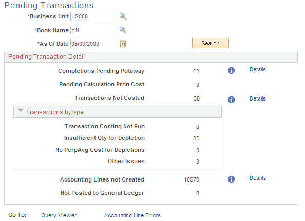

  • The Pending Transactions page identifies the number of transactions at each stage of the costing flow.

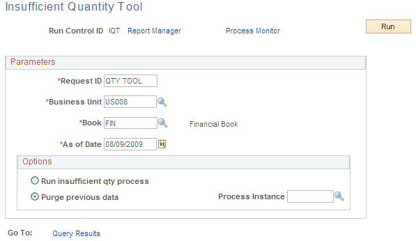

  • The Insufficient Qty Tool (insufficient quantity tool) page identifies depletion transactions (in environments using the negative inventory feature) where accounting entries are not created due to insufficient quantity.

Pending Transactions Page
CM_NPOSTED
View inventory accounting transactions that have not yet been posted to PeopleSoft General Ledger. This inquiry page enables you to monitor transactions before and after the Transaction Costing and Accounting Line Creation processes. Click the Details links to view current transaction information generated by predefined queries. This page also provides links to the Accounting Line Errors page and the Query Viewer.
Insufficient Qty Tool (insufficient quantity tool) Page
RUN_CM_NEG_INV
This PeopleSoft Application Engine program, (CM_NEG_INV), provides you with a query of the accounting line entries that would be generated for those transactions held back in CM_DEPLETIONS due to insufficient quantities.

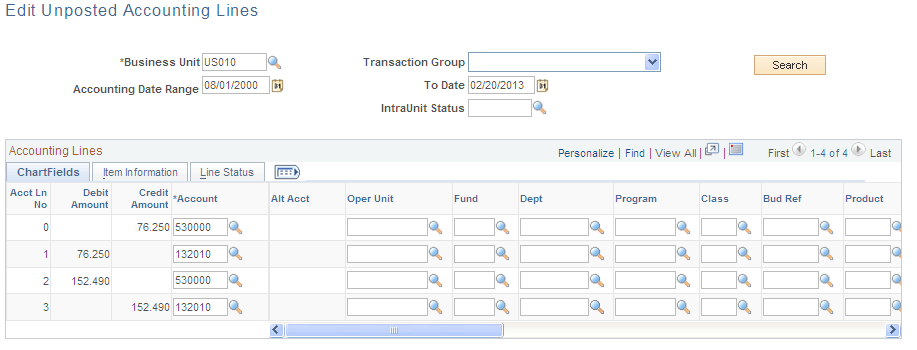

Edit Unposted Accounting Lines Page
CM_ACCTG_LN_UNPOST
After you run the Accounting Line Creation process, use this page to review and make changes to the accounting entry line information for a transaction prior to generating journal entries. For any transaction, you can correct the ChartFields and also change the accounting date. For example, you can adjust or redirect charges to other accounts, change the budget period for the transaction, or redirect the entry to a prior accounting period.
Change Accounting Date Page
CM_ACCTG_UNPST_TRX
Enables you to redirect an accounting entry to an earlier accounting period by changing the accounting date of the transaction before it is sent to the general ledger system. The system displays all the debit and credit lines for the selected accounting entry. Enter the new date in the Accounting Date field and click the OK button to change the accounting date for this transaction. If commitment control is enabled, you cannot change the transaction if any line has passed budget checking.

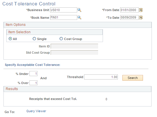

Cost Tolerance Control Page
Use the Cost Tolerance Control page (CM_CTC_INQ) to review costed inventory transactions for possible costing errors based on user-defined tolerance levels.
To be viewed on this inquiry, the transactions must have successfully completed the Transaction Costing process of the Cost Accounting Creation process.
Navigation:
Cost Accounting, and then Item Costs, and then Review Costs, and then Cost Tolerance Control
This example illustrates the fields and controls on the Cost Tolerance Control page. You can find definitions for the fields and controls later on this page.
PeopleSoft Cost Management receives transactions from a variety of sources. The Cost Tolerance Control page helps you to monitor transactions flowing into your cost management system and identifies possible cost errors from any of the sources of incoming inventory. Use the inquiry page to view costed inventory transactions that exceed your cost tolerance parameters. The inquiry results can be viewed on screen or downloaded into a spreadsheet such as Microsoft Excel for further analysis.
In order to be evaluated by this inquiry, an inventory transaction must have successfully completed the Transaction Costing process of the Cost Accounting Creation process.
Search Criteria
Enter your search criteria to select the inventory transactions to be examined for cost tolerance exceptions. Your search criteria determine the sample population to be used.
Field or Control Description
Business Unit
(Required) Enter the PeopleSoft Inventory business unit.
Book Name
(Required) Enter the name of the cost book used.
From Date and To Date
(Required) Enter a date range for the transaction date. The default range is from 01/01/1900 to the current system date.
All Items
Select to include all items within the business unit and cost book.
Single Item
Select to run this inquiry only for transactions with the item identified in the Item ID field.
Standard Cost Group
Select to run this inquiry only for a specific standard cost group defined in the Std Cost Group field. Standard cost groups, or cost groups, enable you to group together a set of items using the Define Business Unit Item -General: Common page. Inventory transactions with items included in the defined cost group are included in this search.
Cost Tolerances and Searching
To qualify as an exception, a transaction must exceed either the % Under or % Over tolerance and also exceed the Threshold tolerance. Cost tolerances are:
% Under
Enter a percentage of the average cost. If an individual transaction is less than this percentage of the average cost of the sample then it is tagged as a possible exception.
For example, if the average cost in the sample for business unit US008/cost book FIN/item ID 10001 is 100 USD and the % Under value is 10 percent, then any transaction with an item cost of less than 90 USD is a possible exception.
This field must be less than 100 percent. The default value is zero percent.
% Over
Enter a percentage of the average cost. If an individual transaction is greater than this percentage of the average cost of the sample then it is tagged as a possible exception.
For example, if the average cost in the sample for business unit US008/cost book FIN/item ID 10001 is 100 USD and the % Over value is 15 percent, then any transaction with an item cost of greater than 115 USD is a possible exception.
The default value is 100 percent.
Threshold
Enter the amount that the costed inventory transaction must fluctuate from the average cost. If any individual transaction differs from the average cost of the sample by more or less than this amount, then the transaction is a possible exception.
For example, if the average cost in the sample for business unit US008/cost book FIN/item ID 10001 is 100 USD and the Threshold value is 25 USD, then any transaction with an item cost of greater than 125 USD or less than 75 USD is a possible exception. This cost tolerance is useful if you wish to prevent small value items from appearing as exceptions.
The default value for this field is zero.

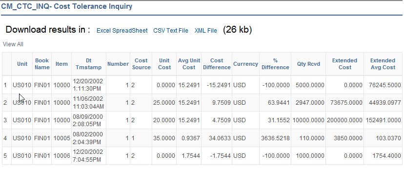

Click the Search button to identify transactions that exceed your cost tolerance parameters. The exception transactions are based on the following calculation:
  1. Based on the business unit, book, date range, and item selection entered on this page, the system finds all costed inventory transactions that meet these parameters and creates a sample population.
  2. An average cost is calculated for each business unit/cost book/item ID combination based on the sample population.
    This average cost could differ from the average cost used in PeopleSoft Cost Management transactions since the search criteria on this page could limit the number of transactions used.
  3. Each individual transaction in the sample population is then compared to the average cost of the sample for the business unit/cost book/item combination using the cost tolerances to find exceptions. Remember, to qualify as an exception, a transaction must exceed either the % Under or % Over tolerance and also exceed the Threshold tolerance.
Viewing Search Results
Receipts that exceed Cost Tol
Identifies the number of rows found by the search that exceed the defined cost tolerances. If too many or too few inventory transactions are found, the user can change the search criteria and cost tolerances then launch another search.

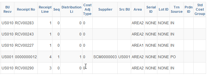

Details
Select this link to access the results of the query. This link becomes available only when search results are found.
Query Viewer
Use this link to access the Query Viewer where you can run queries or schedule them to run at a later time.
Click the Details link to access the query results:
This example illustrates the fields and controls on the Viewing results online (part 1 of 2). You can find definitions for the fields and controls later on this page.
This example illustrates the fields and controls on the Viewing results online (part 2 of 2). You can find definitions for the fields and controls later on this page.
Values displayed include:
Unit Cost
The unit cost of the individual transaction that has exceeded the cost tolerance parameters.
Avg Unit Cost
The average unit cost of the sample population.
Cost Difference
"Unit Cost" – "Avg Unit Cost"
% Difference
("Unit Cost" - "Avg Unit Cost") / "Avg Unit Cost" * 100
Extended Cost
"Unit Cost" * "Qty Rcvd"
Extended Avg Cost
"Avg Unit Cost" * "Qty Rcvd"
Costs are viewed with four decimal places; however, the intermediate calculations and comparisons utilize the full precision values available.
Use the Pending Transactions page (CM_NPOSTED) to view inventory accounting transactions that have not yet been posted to PeopleSoft General Ledger.
Navigation:
Cost Accounting, and then Inventory and Mfg Accounting, and then Analyze Inventory Accounting, and then View Pending Cost Transactions
This example illustrates the fields and controls on the Pending Transactions page. You can find definitions for the fields and controls later on this page.
Use this inquiry page to review inventory accounting transactions that have not yet been posted to the PeopleSoft General Ledger. This inquiry enables you to monitor pending transactions in these stages of the costing flow:
  • Before production completions from PeopleSoft Manufacturing have been putaway into PeopleSoft Inventory.
  • Before production completions from PeopleSoft Manufacturing have been costed.
  • Before the Transaction Costing process.
  • Before the Accounting Line Creation process.
  • Before the Journal Generator process.
Click the Details links to view current transaction information generated by predefined queries for each of these three stages: (TRANSACTION_INV, CM_PENDING_COSTING, CM_PENDING_ACCTG_LINE, and CM_PENDING_GL_DISTRIB). This page also provides a link to the Query Viewer, where you can run queries or schedule them to run at a later time.
Search
Select after entering the business unit, book name, and as of date for the inventory transactions that you want to review. The system displays the number of transactions at each stage of the accounting flow.
Completions Pending Putaway
Displays the number of WIP completions and scrap from PeopleSoft Manufacturing that have been partially putaway or not yet been putaway into an inventory storage locationË™. This query is especially useful when using actual or average costing for make items.
Pending Calculation Prdn Cost
Displays the number of production completions from PeopleSoft Manufacturing that have been putaway into inventory but not yet costed by the Transaction Costing process. There are a number of reasons why the Transaction Costing process would not have costed these transactions; for a complete list, see the Generating Costs for Transaction Records section of this topic.
See Generating Costs for Transaction Records.
Transactions Not Costed
Displays the number of inventory transactions, other than production completions, that have not been processed by the Transaction Costing process. This number is further broken down into three sections in the Transactions by Type group box.
Transaction Costing Not Run
Displays the number of inventory transactions that have not been costed, because the Transaction Costing process has not been run to include them.
Insufficient Qty for Depletion (insufficient quantity for depletion)
Displays the number of inventory transactions that did not complete the Transaction Costing process successfully, because the inventory business unit did not have a sufficient on-hand quantity to satisfy the depletion. The stock quantity of an item may physically exist in inventory however the quantity is not yet recorded in PeopleSoft Inventory due to timing issues or entry errors. The negative inventory feature enables you to move or ship the stock that sends the item's quantity balance into negative numbers within the PeopleSoft system. You can record a negative quantity within PeopleSoft Inventory, however, you could choose not to cost a transaction based on a negative quantity. If you choose not to cost negative inventory transactions, then the Transaction Costing process holds costing the depletion transaction. Each time the Transaction Costing process is run, the depletion transactions on hold are examined to determine if there is sufficient quantity available to satisfy the depletion. Once sufficient quantity exists, the transaction is costed.
Note: The negative inventory feature is activated by selecting the Allow Negative Inventory check box on the Inventory Definition-Business Unit Options page. The Insufficient Qty Cost Option on the Cost Profiles page determines how the Transaction Costing process applies costing to negative inventory transactions.
Other Issues
Displays the number of inventory transactions that did not successfully complete the Transaction Costing process due to other issues besides insufficient depletion quantity. Other issues include:
  • Transactions where a cost did not exist.
  • Transactions waiting for voucher costs (landed costs) from PeopleSoft Payables.
  • Transactions that error in the process due to the detection of corrupt or invalid data coming from an interfacing system.
  • Transactions that will not be picked up until you run the Transaction Costing process in the regular Cost Mode.
Accounting Lines Not Created
Displays the number of inventory transactions that have completed the Transaction Costing process successfully, but have not yet been processed by the Accounting Line Creation job. The costed transactions may not have completed the Accounting Line Creation job simply because you have not run the process for the business unit, book name, and as of date combination. Also, these costed transactions may not have completed the Accounting Line Creation process successfully, because the transactions are missing an accounting rule. Click the Accounting Line Errors link at the bottom of this page to view costed transactions without accounting rules. Accounting rules must be added before you can create accounting entries for costed transactions.
Not Posted to General Ledger
Displays the number of inventory transactions that have completed both the Transaction Costing process and the Accounting Line Creation job successfully, but have not yet been picked up by the Journal Generator process and posted to the general ledger. There are several reasons why the accounting entries may not have been picked up and posted as journal entries:
  • The Journal Generator process may not yet have been run against these accounting lines.
  • If you are using commitment control, the accounting lines may not have passed budget checking. The accounting line's budget status must be V (valid) to be processed. Click the Details link to the right of this field to run the CM_PENDING_GL_DISTRIB query which displays the budget status for the header and line of each accounting entry.
  • If you are using intraunit ChartField balancing, the interunit balancing process may not have been run. Select the Acquire IntraUnit Entries check box on the Accounting Line Creation job to run the Acquire IntraUnit Entries process.
  • The journal template may not have been defined for these accounting entries. Accounting lines are not picked up by the Journal Generator process if the journal template is not present. Click the Details link to the right of this field to run the CM_PENDING_GL_DISTRIB query, which displays the journal template for each accounting line.
  • The general ledger period for these transactions may be closed. Click the Details link to the right of this field to run the CM_PENDING_GL_DISTRIB query, which displays the ledger and ledger group. Verify that you are processing to an open period.
Use the Insufficient Qty Tool (insufficient quantity tool) page (RUN_CM_NEG_INV) to this PeopleSoft Application Engine program, (CM_NEG_INV), provides you with a query of the accounting line entries that would be generated for those transactions held back in CM_DEPLETIONS due to insufficient quantities.
Navigation:
Cost Accounting, and then Inventory and Mfg Accounting, and then Analyze Inventory Accounting, and then Identify Insufficient Quantity
This example illustrates the fields and controls on the Insufficient Quantity Tool page. You can find definitions for the fields and controls later on this page.
This PeopleSoft Application Engine program (CM_NEG_INV) provides you with a query of the accounting line entries that would be generated for those transactions held in CM_DEPLETIONS_VW due to insufficient quantities.
The negative inventory feature is activated by selecting the Allow Negative Inventory check box on the Inventory Definition-Business Unit Options page. Use the Insufficient Qty Cost Option on the Cost Profile page to specify how the negative inventory feature should be applied; select Hold to delay costing the entire depletion transaction that drives the item quantity to a negative balance until sufficient stock is putaway to cover the depletion transaction, or select Partial to split the depletion transaction that drives the item quantity to a negative balance and costs part of the depletion transaction up to the currently available stock quantity. The remaining depletion transaction is held until sufficient stock is putaway.
By Business Unit, Book, and As of Date this process collects the rows in CM_DEPLETIONS that are held back due to insufficient quantities and creates a query displaying the accounting entries that would be generated. The system saves the information into CM_NEG_SNP2_TBL where it is keyed by process instance, business unit, transaction group, accounting date, and line number. It includes the field, CM_ERROR_CODE, to identify rows where an accounting entry could not be determined, because a transaction accounting rule was not found.
After you run this process click the Query Results link to view the results. Using the query, the results can be exported to a Microsoft Excel spreadsheet or a CSV text file.
Run insufficient qty process
Select to run the CM_NEG_INV PeopleSoft Application Engine process to populate the CM_NEG_SNP2_TBL record with entries based on the business unit, cost book, and as of date entered on this page.
Purge previous data
Select to purge rows from the CM_NEG_SNP2_TBL record based on the business unit, cost book, and as of date entered on this page.
Use the Edit Unposted Accounting Lines page (CM_ACCTG_LN_UNPOST) to after you run the Accounting Line Creation process, use this page to review and make changes to the accounting entry line information for a transaction prior to generating journal entries.
Navigation:
Cost Accounting, and then Inventory and Mfg Accounting, and then Create Accounting Entries, and then Edit Unposted Accounting Lines
This example illustrates the fields and controls on the Edit Unposted Accounting Lines page. You can find definitions for the fields and controls later on this page.
After you run the Accounting Line Creation process, use this page to review and make changes to the accounting entry line information for a transaction prior to generating journal entries. For any transaction, you can correct the ChartFields and also change the accounting date. For example, you can adjust or redirect charges to other accounts, change the budget period for the transaction, or redirect the entry to a previous accounting period.
Budget Check Details
Click the Budget Check Details button to view the budget details for the current accounting line. This button displays when commitment control is selected for PeopleSoft Inventory on the Installation Options-Products page.
ChartFields
Click to access the Change Accounting Date page where you can enter a new accounting date for the transaction before the Journal Generator process picks up the transaction. If commitment control is enabled, you cannot change the transaction, if any line has passed budget checking.
Line Status
Select the Line Status tab.
Budget Status
Displays the transaction's budget checking status.
IntraUnit Status
If you are using intraunit accounting, the transaction's ChartField balancing status appears.
IU Balancing Entry (intraunit balancing entry)
If you are using intraunit accounting, this check box is selected if the line is an intraunit receivable or intraunit payable that balances the transaction. These lines are added by the ChartField balancing process.
GL Dist Status (general ledger distribution status)
Indicates whether or not the accounting entry has been passed to the general ledger system.
PC Status (project costing status)
Indicates whether or not the accounting entry has been passed to PeopleSoft Project Costing. Only entries coded for project costing are passed.
To view and change unposted lines:
  1. Enter the business unit, transaction group, and accounting date range.
    If you do not enter a date range, all unposted transactions relating to the transaction group appear. If you do not enter a transaction group, all transaction groups appear related to the business unit that you entered.
  2. (Commitment control only) Enter the budget status.
    Values are: E (error in budget check), N (not budget checked), and V (valid budget check).
  3. (ChartField balancing only) Enter the IU status (intraunit ChartField balancing status).
    Values are: B (balanced), E (error), I (ignore. The line is not an intraunit transaction), N (not balanced), H (hold for other business unit affiliates), P (in process), S (staged), and X (balancing not required).
  4. Click the Search button to populate the account line information on the lower portion of the page.
  5. To alter the accounting date of a transaction, click the Change Accounting DT button to access the Change Accounting Date page, where you can enter a new accounting date for accounting entry. If commitment control is enabled, you cannot change the transaction if any line has passed budget checking. Accounting date is determined by the transaction date, open periods, and lag days. If the transaction date is greater than the last open date, then the accounting date is set to the first date in the next open period. If the transaction date is less than the first open date it will be set to the first open date.
  6. Select the ChartFields tab or Line Status tab to display information for any accounting line.
    Change any incorrect data in the editable fields.
  7. Click the Budget Check Details button, if available, at the beginning of the account line to access the Commitment Control page for that line.
    For any line in error, changing information on the line resets the budget status. Rerun the GL Dist Status and the Accounting Line Creation process. Balancing ChartFields will not be available in balanced rows; therefore, you cannot make changes for those ChartFields.
