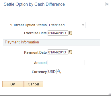

Settle Option by Cash Difference Page
TRX_OPT_EXRCS_CASH
Exercise an option or update or change the exercise status for an option.

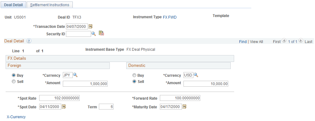

  • Enter foreign exchange (FX) deal physical details.

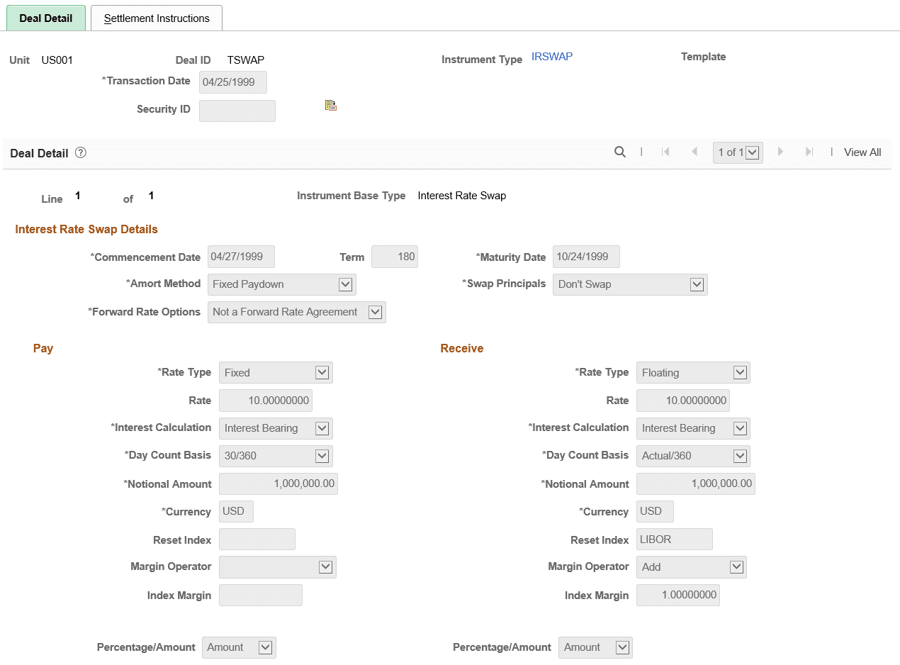

  • Specify IRP deal details.
  • Define IR swap deal details.

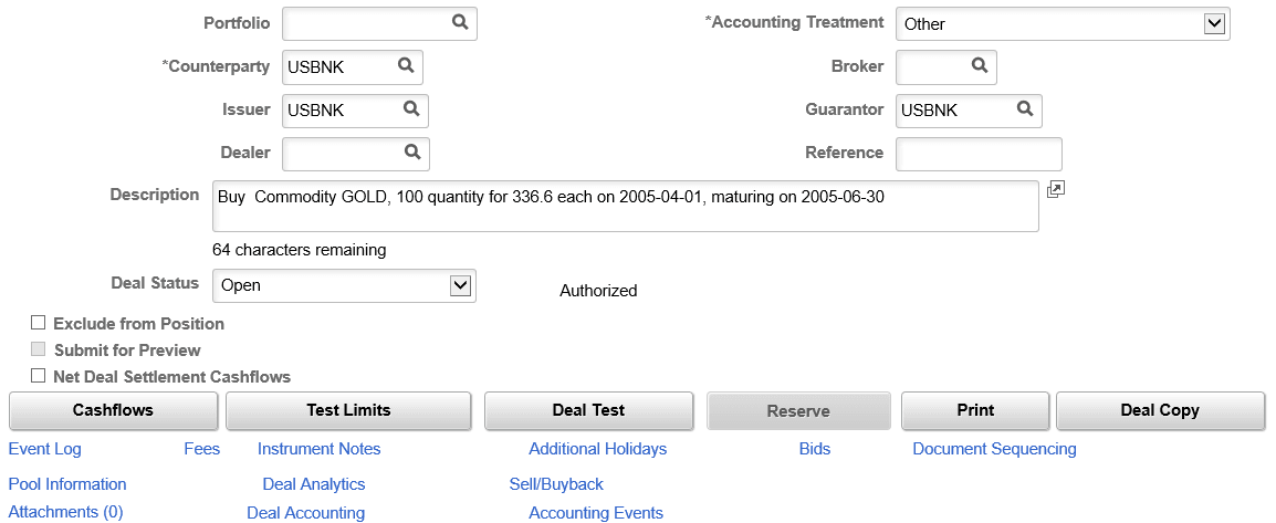

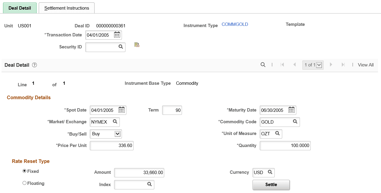

Entering Commodity Deal Details
Use the Deal Detail page (TRX_DETAIL_TR) to enter commodity deal details.
Navigation:
Deal Management, and then Capture Deals, and then Deals, and then Deal Detail
This example illustrates the fields and controls on the Deal Detail page for commodity deals (1 of 2). You can find definitions for the fields and controls later on this page.
This example illustrates the fields and controls on the Deal Detail page for commodity deals (2 of 2). You can find definitions for the fields and controls later on this page.
Field or Control Description
Spot Date
The spot date is typically two working days after the current trading date. Certain currencies (Canadian dollar, Mexican peso, Hong Kong dollar, and Japanese yen) may clear one working day after the trade date. Holidays affect the spot date in various ways:
  • If a holiday occurs on the first working day after the transaction date in any of the currencies that are involved in the transaction, then the spot date is moved forward.
    However, a holiday on the first working day after the transaction date in a transaction that involves the U.S. dollar has no effect on the spot date.
  • A holiday or nontrading day that occurs in any currency that is involved in the transaction on the second working day after the transaction date moves the spot date forward to the next working day.
Settle
Click to access the Commodities Settlement page to define commodity settlement information.

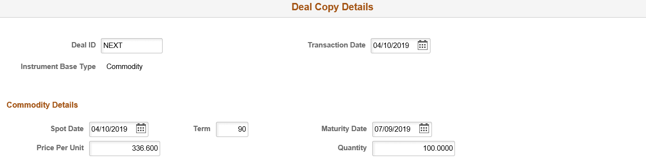

Deal Copy
Click to copy the existing deal by changing the date, amount and rate field values with the required new values. The Deal Copy Details secondary page displays fields based on the Instrument Type of the original deal.
This example illustrates the fields and controls on the Deal Copy Details page.
Deal Copy Details Page

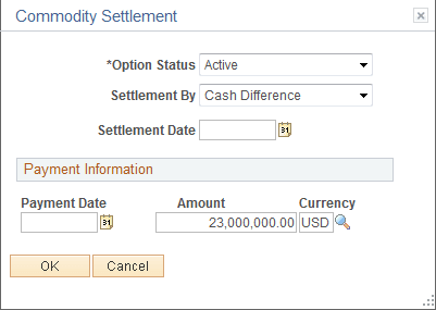

Commodity Settlement Page
Use the Commodities Settlement page (TRX_COMO_STL) to set up the settlement of commodities.
Navigation:
Click the Settle button on the Deal Detail page for a commodity instrument deal.
This example illustrates the fields and controls on the Commodity Settlement page. You can find definitions for the fields and controls later on this page.
Current Status
Select the current status of the option. Values are:
  • Active
  • Exercised
  • Expired
  • Inactive
Settlement by
Values are:
  • Cash Difference: Settle difference using cash.
  • Delivery of Payoff: Settle difference using the commodity.

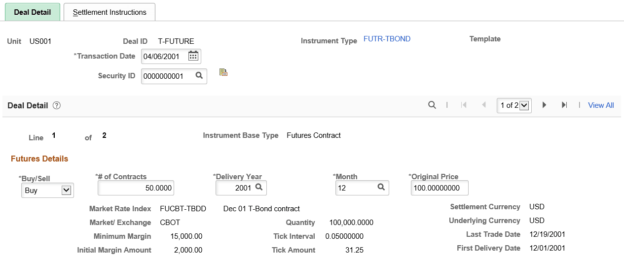

Defining Futures Deal Details
Use the Deal Detail page (TRX_DETAIL_TR) to enter futures contract deal details.
Navigation:
This example illustrates the fields and controls on the Deal Detail page for futures deals (1 of 2). You can find definitions for the fields and controls later on this page.
This example illustrates the fields and controls on the Deal Detail page for futures deals (2 of 2). You can find definitions for the fields and controls later on this page.

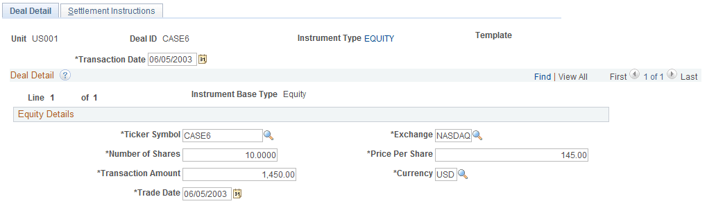

Entering Equity Deal Details
Use the Deal Detail page (TRX_DETAIL_TR) to enter equity instrument deal details.
Navigation:
This example illustrates the fields and controls on the Deal Detail page for equity deals. You can find definitions for the fields and controls later on this page.
Deal Detail page for equity deals (1 of 2)
Use this page to record a stock purchase transaction. For deals that involve selling stocks, use the Sale Details page that is accessible from the Sell link on the Equity Definition page.
You must define the equity on the Equity Definition page before you can use it in a deal.
See Equity Definition Page.
Ticker Symbol
Enter the stock exchange symbol that is used in trading the particular shares or the corporation.
Exchange
Enter the market exchange with which the corporation is listed.
Number of Shares
Enter the number of shares that are being traded.
Price per Share
Enter the price of a single share of stock.
Transaction Amount
Enter the monetary total of the transaction based on the number of shares that are being sold multiplied by the price per share.
Currency
Select the currency that is used by the country that is associated with the market exchange, entered in the Exchange field, on which the equity is traded.
Trade Date
Enter the date of stock purchase.

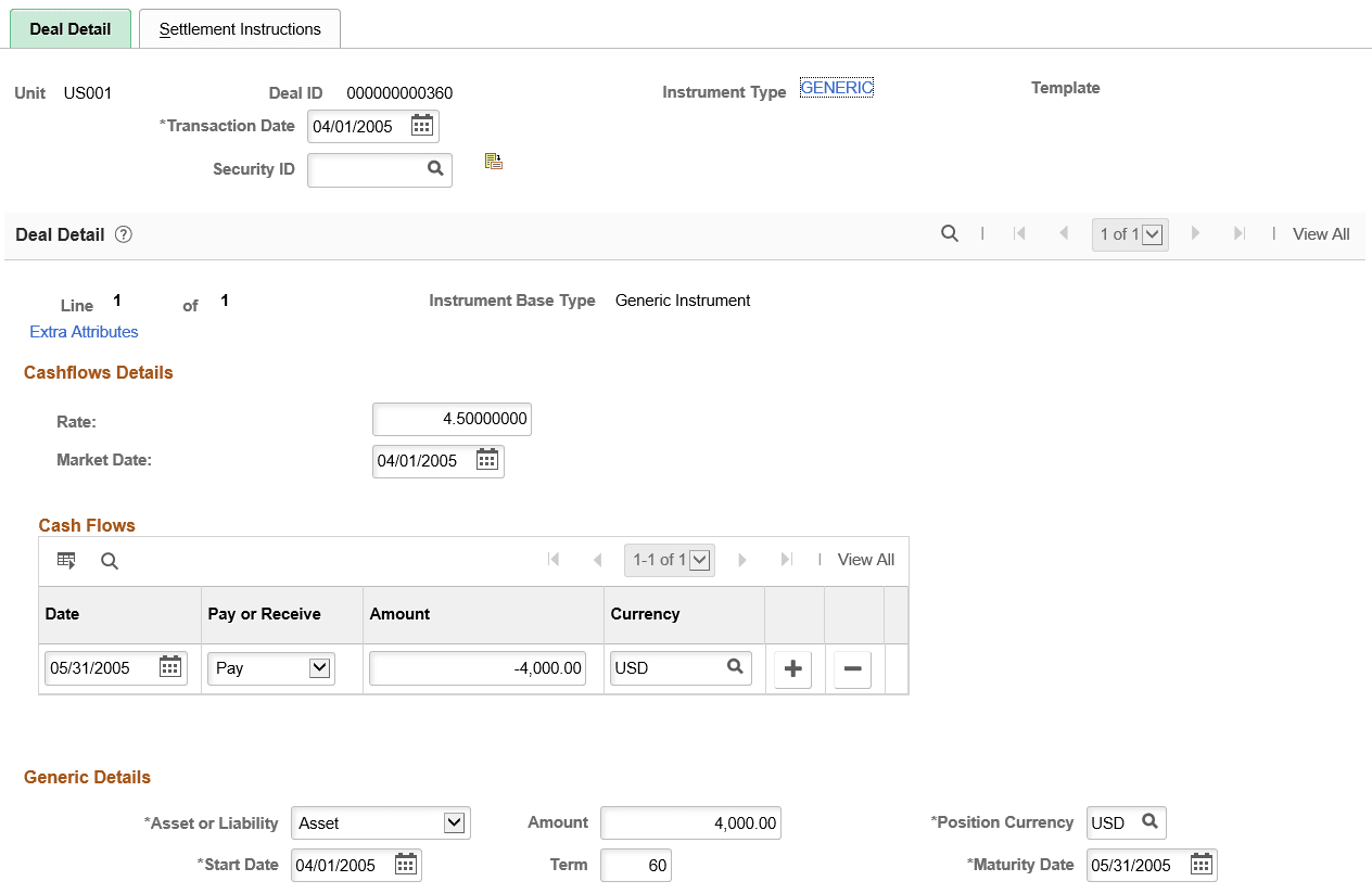

Use the Deal Detail page (TRX_DETAIL_TR) to enter generic deal details.
Navigation:
This example illustrates the fields and controls on the Deal Detail page for generic deals (1 of 2). You can find definitions for the fields and controls later on this page.
This example illustrates the fields and controls on the Deal Detail page for generic deals (2 of 2). You can find definitions for the fields and controls later on this page.
Pay or Receive
Specify whether the cash-flow line value is to be paid or received.
Asset or Liability
Indicate whether you are capturing data on an asset or liability.
Term
The term is the number of days between the specified start and maturity dates. If you enter a start date and term, the system calculates the maturity date. If you enter a start date and maturity date, the system calculates the term.

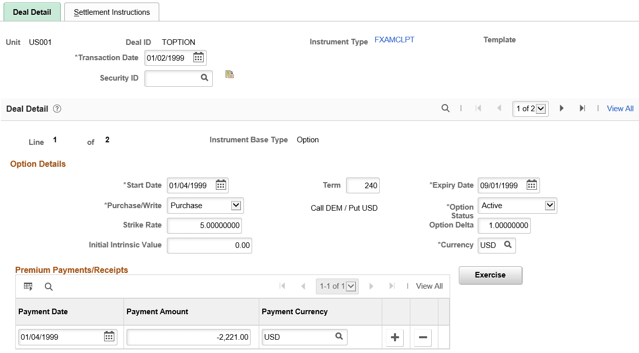

Defining Option and Option - Binary Payoff Deal Details
Use the Deal Detail page (TRX_DETAIL_TR) to enter option and option - binary payoff deal details.
Navigation:
This example illustrates the fields and controls on the Deal Detail page for an option (1 of 2). You can find definitions for the fields and controls later on this page.
This example illustrates the fields and controls on the Deal Detail page for an option (2 of 2). You can find definitions for the fields and controls later on this page.

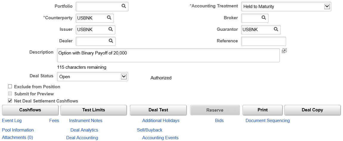

This example illustrates the fields and controls on the Deal Detail page for options with binary payoff (1 of 2). You can find definitions for the fields and controls later on this page.
This example illustrates the fields and controls on the Deal Detail page for options with binary payoff (2 of 2). You can find definitions for the fields and controls later on this page.
This section discusses deal details for both options and options - binary payoff. The application pages for these deals are identical, exception for the second line of Option Details. In the preceding example, Details Line 1 of 2 is an option, and line 2 of 2 is an option - binary payoff.

Interest Date Rule
Purchase/Write
Values are:
Purchase: Select if you are purchasing the option; this means that you pay premiums.
Write: Select if you are selling the option; this means that you receive premiums.
Option Status
Select the status of the options. Values are:
Inactive: The option is ineligible for exercise due to an Up and Out or Down and Out option barrier breach or cancellation. Options with Down and In or Up and In barriers start with Inactive selected in the Option Status field. If the option breaches the barrier, then the current option status becomes Active.
Active: The option is eligible for exercise. Options with Down and Out or Up and Out barriers start with Active selected in the Current Option Status field. If the option breaches the barrier, then the current option status becomes Inactive.
Exercised: The option is exercised.
Expired: The option exceeded its expiry date and is no longer eligible for exercise.
See Defining Option and Option - Binary Payoff Deal Details.
Strike Rate
Enter the rate at which the stock or commodity that underlies a put or call option can be purchased (call) or sold (put) over the period that is specified by the start and expiry dates.
Option Delta
Enter the absolute value, a number between 0.00 and 1.00, of the option delta. Do not enter a negative value for a put option.
Initial Intrinsic Value
Enter the difference between the strike price of an option and the market value of the underlying security. A purchased option that is in the money has a nonzero, positive intrinsic value. A written option that is in the money has a nonzero, negative intrinsic value. An option that is purchased (or written) that is out of the money has zero intrinsic value.
Start Date
Enter the first date that an option is eligible for exercise (for American or Bermudan options), and the first date on which accrual on the option premium begins.
Expiry Date
Enter the last day that an option is eligible for exercise or conversion into the underlying common stock. You can enter a value, or the system calculates the expiry date based on the term that you enter.
Term
Enter a value to establish the contractual period for the option agreement.
Exercise Dates
This link is available if the exercise type on the Instrument Detail page is Bermudan, or if the Strike Rate Varies Over Time check box is selected on the Instrument Detail page.
If the option has a European exercise type, then the option can be exercised only on the expiry date.
If the option has an American exercise type, then the option exercise can occur on any date between the start and expiry dates.
Enter the appropriate period start and expiry dates and a valid value in the Strike Rate field. To enter a one-day period, set the period end date equal to the period start date.
Premium Payment/Receipts
Payment Date
Enter a date for the premium payment.
Payment Amount
Enter an amount for the premium payment.
Use the Settle Option by Cash Difference page (TRX_OPT_EXRCS_CASH) to exercise an option or update or change the exercise status for an option.
Navigation:
Click the Exercise button on the Deal Detail page for an options deal.
This example illustrates the fields and controls on the Settle Option by Cash Difference page. You can find definitions for the fields and controls later on this page.
Select the status of the option. Values are:
Expired: The option exceeded its expiry date. It is no longer eligible for exercise.
Entering FX Deal Physical Details
Use the Deal Detail page (TRX_DETAIL_TR) to enter deal details for foreign exchange physical deals.
Navigation:
This example illustrates the fields and controls on the Deal Detail page for FX physical deals. You can find definitions for the fields and controls later on this page.
Deal Detail page for FX physical deals (1 of 2)
An FX physical deal has a buy side and sell side. When you select the Buy or Sell option for one currency, the system selects the corresponding value for the other currency. If you are entering a cross-currency deal, change the domestic currency field to a foreign currency. The system changes the label for that region to Foreign. Enter the monetary amount of the traded currency. When you enter the amount and rate for one currency, the system calculates the other amount and rate.
Spot Rate
Enter the spot rate for the deal.
Spot Date
Enter the spot date. The default value is two working days after the current date, but you can override this value.
Term
Enter the term of the deal. If you enter a spot date and a maturity date, the system calculates the value in this field. If you enter a value in this field, then the system calculates the maturity date by adding the term to the spot date.
Forward Rate
Specify the contracted forward rate for this deal. You can enter the quoted rate, or the system calculates the rate based on the data that you enter in the Amount fields.
Swap Cash
Click to access the Roll Specific Details - Swap FX page to specify information that is required to swap this foreign exchange forward or backward.

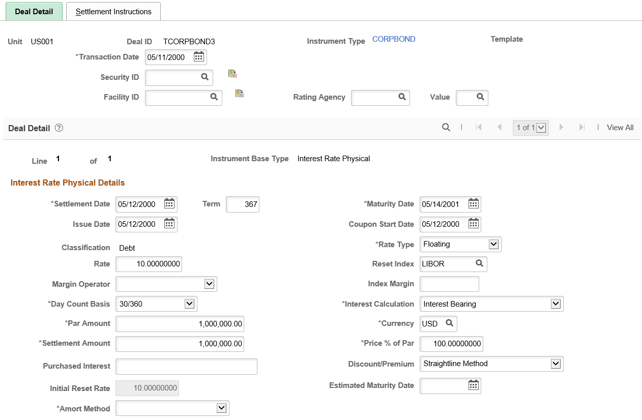

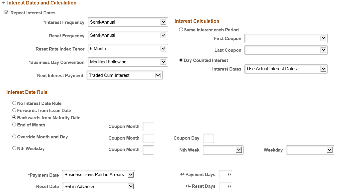

Specifying IRP Deal Details
Use the Deal Detail page (TRX_DETAIL_TR) to specify IRP deal details.
Navigation:
This example illustrates the fields and controls on the Deal Detail page for IRP deals (1 of 3). You can find definitions for the fields and controls later on this page.
This example illustrates the fields and controls on the Deal Detail page for IRP deals (2 of 3). You can find definitions for the fields and controls later on this page.
This example illustrates the fields and controls on the Deal Detail page for IRP deals (3 of 3). You can find definitions for the fields and controls later on this page.
Many of the deals that you enter into are IRP deals—for example, loans, bonds, and deposits—that represent actual payments of principal and interest that occur in generally predictable amounts at fixed points in time.
Settlement Date
The system populates this field with a date after the specified transaction date. The value in the Time to Settlement field on the instrument determines the number of days after the transaction date. You can edit this field.
Issue Date
Displays the first day that an IRP deal begins accruing interest. The value of this field by default becomes the settlement date for both investments and debt. This value can be overwritten for investments.
Classification
Identifies whether the instrument is for Debt raising or an Investment. This is determined on the Instrument Detail page.
If you select Investment, you can complete the Issuer and Guarantor fields on the Deal Detail page.
These fields are active only if the following conditions are met:
  • The selected instrument base type is Interest Rate Physical.
  • The value in the Classification field (on the Deal Detail page) is Investment.
Par Amount
This is the amount that is paid or received when the IRP matures. For Debt, the settlement amount is the amount that is borrowed on the settlement date. For Investment, the settlement amount is the amount that is invested on the settlement date.
If the amount of the deal is amortized, the amortization conditions must be defined.
See Defining Amortization Functionality for IRP and IR Swap Deals.
Price % (percent) of Par
The system uses the values in the Par Amount and Settlement Amount fields to calculate the displayed value.
Settlement Amount
If this deal is a Debt, the settlement amount is the amount that is borrowed on the settlement date. If this deal is an Investment, the settlement amount is the amount that is invested on the settlement date.
Purchased Interest
Displays the accrued interest as calculated from the interest-period start date to the maturity date.
Discount/Premium
This field is available when the Interest Calculation field is set to Interest Bearing. It dictates how to account for and treat any discount or premium that is associated with an interest rate physical. Select whether you use a straightline or constant yield method to amortize the bond's discount (or premium). This also affects the calculation method for calculating interest accruals. Values are:
None (blank): The discount amount is added to the interest amount (or the premium is deducted), and that total is accounted for by using the Treasury accounting event Interest Accrual.
Constant Yield Method: The discount (or premium) amount is separately amortized (accounted for) using the Discount Accrual accounting event. The discount amount (or premium) that is amortized in each period is set so that the sum of the amortization amount plus the interest that is accrued provides a constant rate of interest (yield) when applied to the amount outstanding at the beginning of a period.
Straightline Method: The discount (or premium) amount is separately amortized (accounted for) using the Discount Accrual accounting event. The discount amount (or premium) that is amortized in each period is set so that the total amortized portion equals the total amount of the discount (or premium) divided by the total life of the deal (term) in days, multiplied by the number of days that the deal is outstanding (by using 30/360-day counts if appropriate).
See PeopleSoft Cash Management: Accounting Events.
Yield
Enter the annual rate of return on the investment, expressed as a percentage. This field is calculated for interest bearing IRPs.
Initial Reset Rate
This field appears only for floating-rate deals. When you enter a rate in the Rate field the system updates the Initial Reset Rate value, inclusive of the index margin, after you run cash flows. The system stores and displays it here for the life of the deal. You cannot edit this field.
Estimated Maturity Date
This field appears only for interest-bearing debt instruments.
Use this field to amortize the discount or premium to a different schedule based on an estimated maturity date. For fixed-rate deals that use the straightline discount or premium method, enter the estimated maturity date and click the Cash Flows button.
The system builds a table containing two sets of information. The first set is the payment schedule and contains information regarding cash flows, positions, and accounting events data for both the maturity date and estimated maturity date. The second set contains information that is segregated by source code.
When the accounting module calculates discount accrual for an estimated maturity date, it uses information from the estimated maturity date side of the table.
Next Interest Payment
Specify whether the next interest payment is:
  • Traded Cum-Interest: Payment includes interest.
  • Traded Ex-Interest: Payment does not include interest.

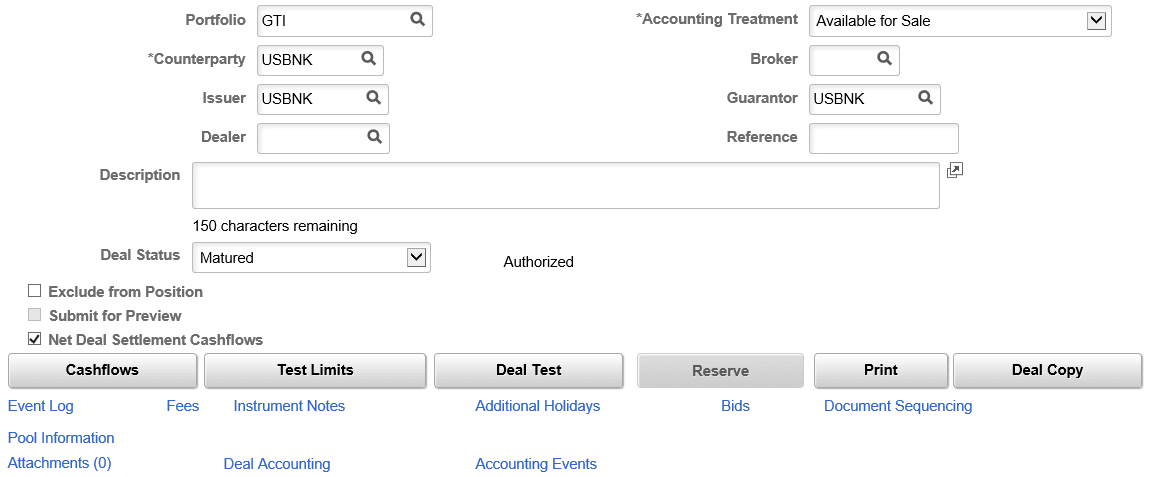

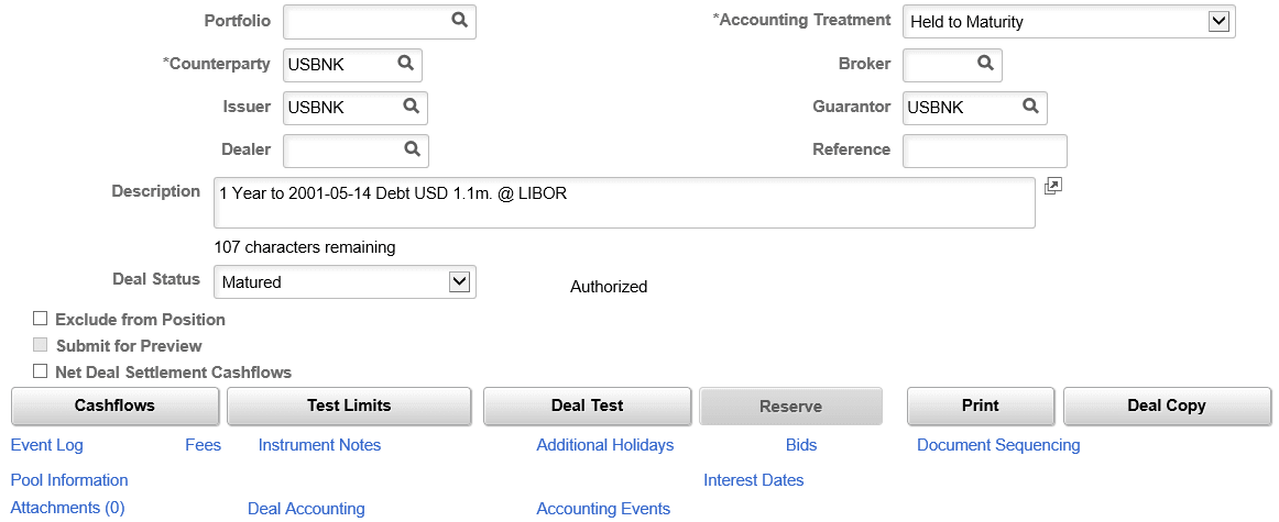

Deal Copy

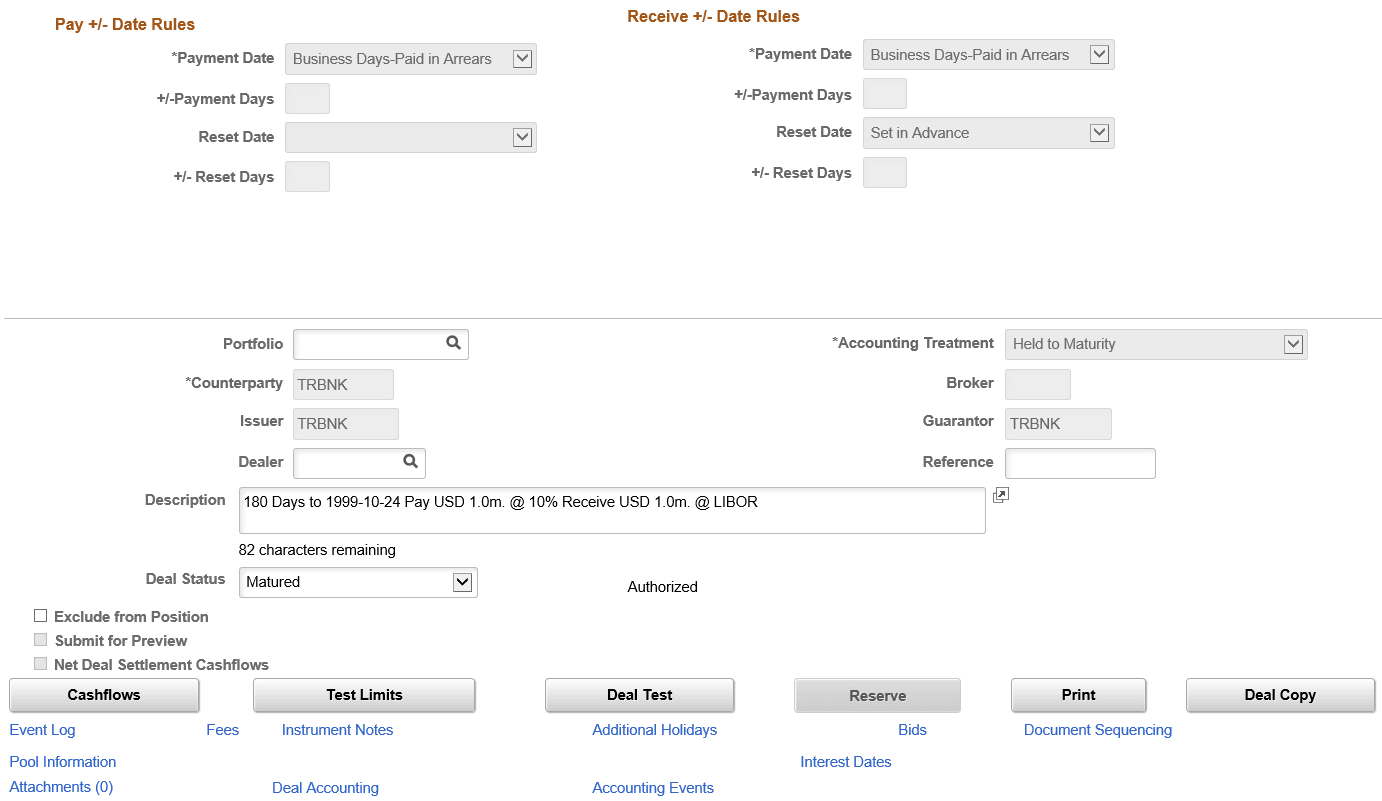

Defining IR Swap Deal Details
Use the Deal Detail page (TRX_DETAIL_TR) to define IR swap deal details.
Navigation:
This example illustrates the fields and controls on the Deal Detail page for IR swap deals (1 of 3). You can find definitions for the fields and controls later on this page.
This example illustrates the fields and controls on the Deal Detail page for IR swap deals (2 of 3). You can find definitions for the fields and controls later on this page.
This example illustrates the fields and controls on the Deal Detail page for IR swap deals (3 of 3). You can find definitions for the fields and controls later on this page.
In addition to all other IR swap instruments that you define, you should define two instruments to handle IR swap, cash-flow, and processing scenarios. Associate each instrument with its respective preconfigured accounting template.
Also, IR swap fields exist for both the Pay and Receive regions, but they are described only once in this section. The PeopleSoft system requires data entry for both sets of fields.
