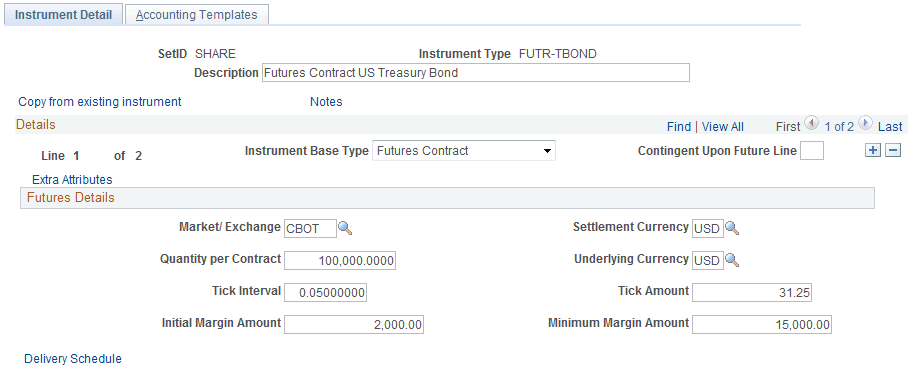

Defining Instrument Details
Pages Used to Define Instruments

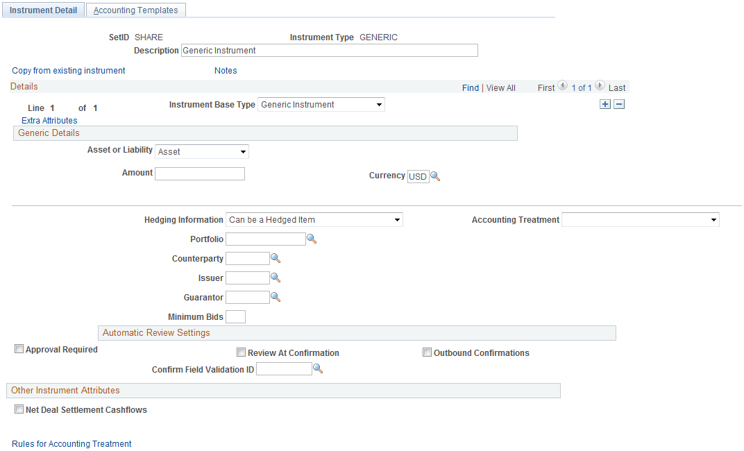

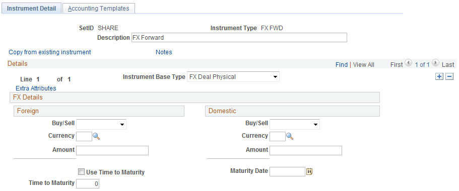

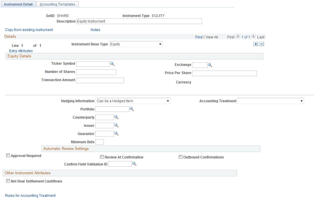

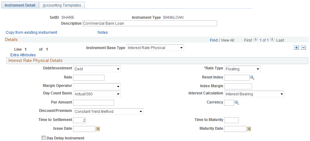

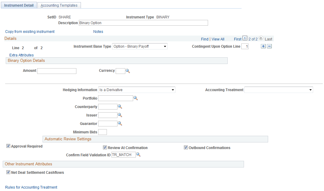

Instrument Detail Page
INSTR_DETAIL_TR
Enter the specifics for an instrument. This page differs for each instrument base type.

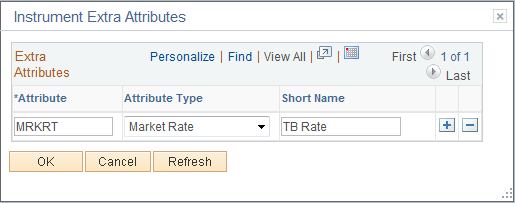

Instrument Extra Attributes Page
INSTR_ADHOC_ATR
Assign extra notational attributes to your instrument.
Notes
INSTR_NOTES_PNL
Enter detailed notes to describe the function of the instrument being created.
See the Instrument Detail Page for more information.

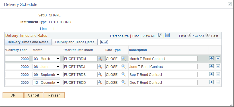

Delivery Schedule Page
INSTR_FUTURE_SP
Capture data that is specific to a particular futures contract.

Common Elements Used to Define Instruments
Field or Control Description

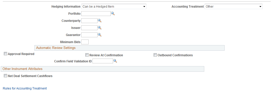

Accounting Treatment
Select a default accounting treatment for deals created from this instrument. You can modify this setting at the deal level. Values are:
  • Available for Sale: Select if the deal can be sold before its maturity date.
  • Held to Maturity: Select if the deal is held until its maturity date.
  • Loans and Receivables: Select if the instrument is a loan granted by the enterprise's treasury.
  • Other: Select if the deal requires an alternative accounting treatment, such as IAS 39 or FAS 133 hedge accounting or other nonstandard accounting.
  • Trading: Select if the deal is actively trading and is likely to be sold before its maturity date.
This field is primarily for audit purposes—the specified value does not affect the processing. The system processes accounting for an accounting treatment using templates assigned to events on the Accounting Templates page. This means that if you assign the same templates to accounting events on different accounting treatments, the system processes the treatments exactly alike.
See PeopleSoft Risk Management: Accounting Treatments for Complying with IAS 39.

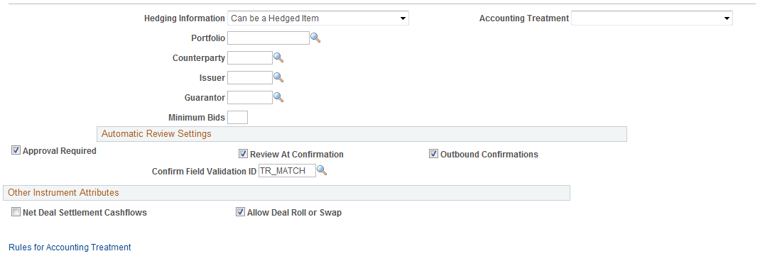

Allow Deal Roll or Swap
Select to indicate that deals that you create using this instrument can be rolled forward or used in a swap.

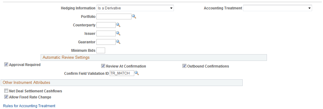

Allow Fixed Rate Change
If selected, fixed rate deals that you create using this instrument can have the rate modified.
In addition, if you create an interest rate swap instrument and leave this check box deselected, the Reset Rate Set check box on the Reset Rates page is disabled for any deals created from this instrument. You cannot change the established fixed rate for these swap deals.
See Processing Reset Rates.

Approval Required
Select if this instrument requires management approval before contract closure with the counterparty.

Confirm Field Validation ID
If you intend to use automated inbound confirmations, enter the confirmation field validation.

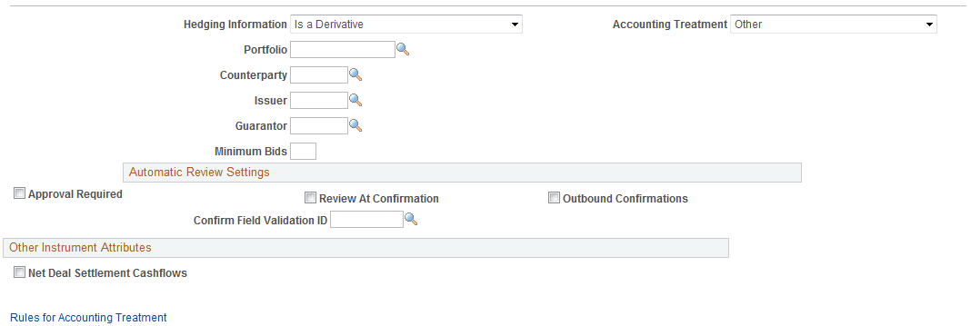

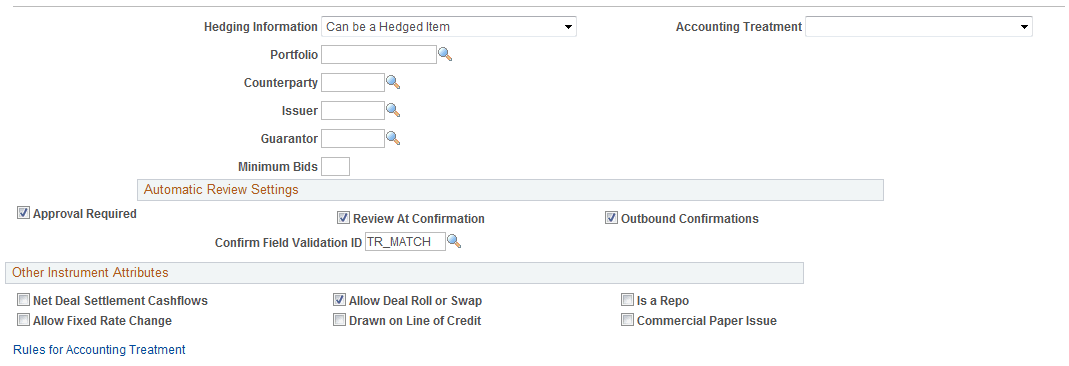

Hedging Information
Select from the options listed below if you use your instrument in a hedge accounting relationship:
  • Can be a Hedged item
  • Contains Embedded Derivative
  • Is a Derivative
  • Nonderivative Foreign Currency

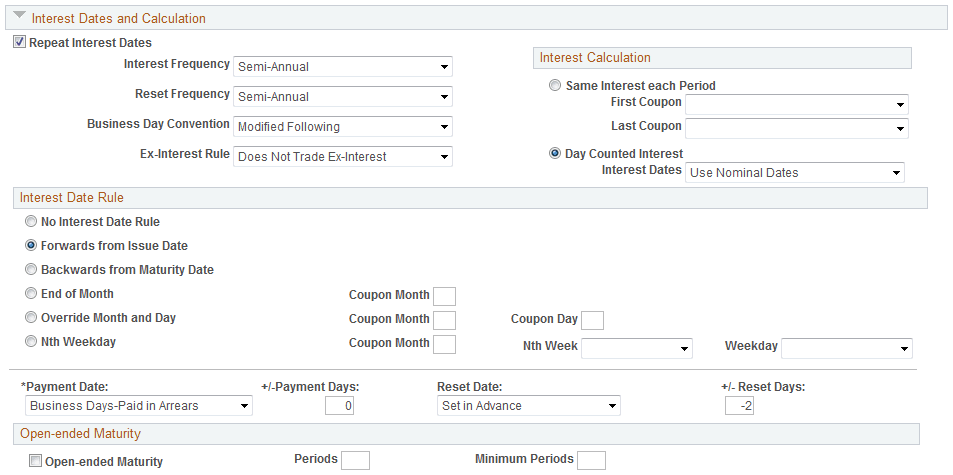

Index Margin
For interest calculations, the index margin is the value added to the reset index, or the value by which the reset index is multiplied. Use the Margin Operator field to specify whether the interest calculation involves adding or multiplication of the index margin value.

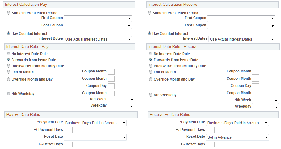

Interest Calculation
Select an interest calculation from the Interest Date and Calculations region:
Same Interest each Period: The system uses a fixed amount to calculate interest payments, regardless of the number of days between interest dates. Select options from the First Coupon and Last Coupon fields.
Day Counted Interest: The system uses the actual number of days between interest dates to calculate interest payments. Select an option from the Interest Dates field.
Select the method in the IRP or IR Swap Details region to use to calculate interest:
Discount to Yield: Refers to discount securities that are quoted using a money market yield. This method uses the rate to derive the settlement amount. The difference between the settlement amount and the par amount is the interest.
Interest Bearing: Refers to interest-bearing instruments. This method calculates interest for each period and pays interest on each period end date.
Straight Discount: Refers to money market instruments that are quoted on a straight discount or discount rate basis. This method uses the rate to calculate a discount amount, and then subtracts this amount from the par amount to obtain the purchase price or settlement amount.
Interest Date Rule
Select an interest date rule used to define how interest is calculated and when payments will be paid. Depending on the values that you select in this list, complete the related fields. Values are:
  • No Interest Date Rule: No predefined calculation for determining interest.
  • Backwards from Maturity Date: Interest is calculated starting from the maturity date backwards toward the issue date. Used for instruments such as treasury bonds that have a final maturity date after which no further interest is accrued.
  • End of Month:
    Select to indicate that interest payments will be paid at the end of each month. Enter a numeric equivalent in the Coupon Month field for the first month that interest will be paid.
  • Forwards from Issue Date: Interest is calculated beginning from the issue date and going forward to the maturity date.
  • Nth Weekday: Enter a week and day for which the interest period will end. For example, select Nth Weekday, Third in the Nth Week field, and Friday in the Weekday field to designate that the end of the interest period will always fall on the third Friday of every month.
  • Override Month and Day: Select this value and enter a month and day to designate when the interest period ends. For example, enter 10 in the Coupon Month field and 23 in the Coupon Day field to indicate that the interest period ends on the 23rd day of every month beginning with the month of October.
Interest Dates
Select from these values:
Use Actual Interest Dates: The actual interest dates (the interest dates after adjusting for nonbusiness days and weekends) determine the amount of the interest payment.
Use Nominal Dates: The nominal interest dates (the interest dates before adjusting for nonbusiness days and weekends) determine the amount of the interest payment.
Interest Frequency
Select an interval that reflects the cash flow frequency for the deal. Values are Annual, At Maturity, Every 28 Days, Every 35 Days, Every 49 Days, Monthly, Quarterly, Semi-Annual, and Weekly.
In the Compounds field, define how frequently this interest interval compounds. Values are Annual, At Maturity, Every 28 Days, Every 35 Days, Every 49 Days, Monthly, Quarterly, Semi-Annual, and Weekly.
Is a Commercial Paper Issue
Select if the instrument is a commercial paper facility.
See Establishing a Commercial Paper Facility.
Is a Repo (repurchase)
Select to indicate that deals created using this instrument are available for use in a repurchase agreement.
Issuer and Guarantor
Enter the issuer of the security and the entity that backs up the issued security.

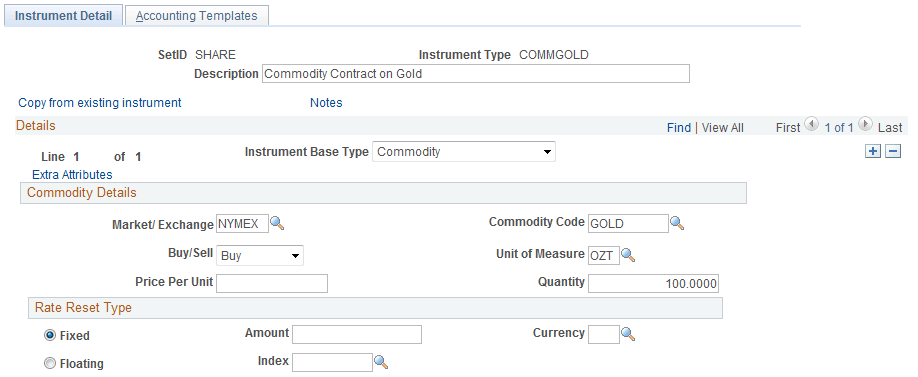

Market/Exchange
Enter the exchange where the commodity or equity is traded.

Net Deal Settlement Cash Flows
Select this check box if your instrument has more than one instrument base type or contains an interest rate swap, and you require that cash flow from one instrument base type or swap leg net with cash flow from another instrument base type or swap leg.

Outbound Confirmations
Select to designate that these instrument deals be selected in the automated outbound confirmations procedure and forwarded to the counterparty for review.

Reset Index
Enter a reset index for this instrument, for example, LIBOR (London Interbank Offer Rate).
Review At Confirmation
Select if you want to require your confirmation staff to review these instrument deals.
Select to have the system use a fixed amount to calculate interest payments, regardless of the number of days between interest dates.

  2. (Optional) Click the Extra Attributes link to add extra attribute information for the deal.

Entering Commodity Instrument Details
Use the Instrument Detail page (INSTR_DETAIL_TR) to enter the specifics for commodities deals.
Navigation:
Deal Management, and then Administer Deals, and then Define Instruments
This example illustrates the fields and controls on the Instrument Detail page – for commodities deals (1 of 2). You can find definitions for the fields and controls later on this page.
Instrument Detail page for a Commodity (1 of 2)
This example illustrates the fields and controls on the Instrument Detail page – for commodities deals (2 of 2). You can find definitions for the fields and controls later on this page.
Instrument Detail page for a Commodity (2 of 2)
Instrument Base Type
Select Commodity.
Commodity Details
Commodity Code
Enter the exchange code for the commodity being traded.
Buy/Sell
Specify whether the instrument being created is for deals that will buy or sell a commodity.
Unit of Measure
Specify a unit of measure most commonly used for trading the specified commodity.
Price Per Unit
Enter a price per unit of measure for the commodity.
Quantity
Enter the quantity of the commodity being traded.
Rate Reset Type
Fixed
Select to specify a fixed rate of return on the commodity investment—entered in the Amount field.
Amount
Enter the monetary value based on the price per unit multiplied by the quantity of the commodity.
Floating
Select for deals that will be based on a floating rate of interest.
Index
Select the market for which thee floating rate index is based.
Entering Equity Instrument Details
Use the Instrument Detail page (INSTR_DETAIL_TR) to enter the specifics for an equity deal.
Navigation:
This example illustrates the fields and controls on the Instrument Detail page – for an equity deal. You can find definitions for the fields and controls later on this page.
Instrument Detail page for an Equity
Ticker Symbol
Enter the stock exchange symbol that is used in trading the particular corporation's shares.
Exchange
Enter the stock exchange with which the corporation is listed.
Number of Shares
Enter the number of shares being traded.
Price per Share
Enter the price of a single share of stock.
Transaction Amount
Enter the monetary total of the transaction based on the number of shares being sold multiplied by the price per share.
Entering FX Deal Physical Instrument Details
Use the Instrument Detail page (INSTR_DETAIL_TR) to enter the specifics for a foreign exchange deal physical.
Navigation:
This example illustrates the fields and controls on the Instrument Detail page – for foreign exchange deal physicals (1 of 2). You can find definitions for the fields and controls later on this page.
Instrument Detail page for an FX Deal Physical (1 of 2)
This example illustrates the fields and controls on the Instrument Detail page – for foreign exchange deal physicals (2 of 2). You can find definitions for the fields and controls later on this page.
Instrument Detail page for an FX Deal Physical (2 of 2)
Select FX Deal Physical.
Buy/Sell
A FX deal physical instrument has a buy side and a sell side. Once you select Buy or Sell in the field for one region, the system makes the corresponding selection for the other region when you save the instrument.
Use the following fields to automatically assign a value for the Maturity Date field on the Deal Detail page when you use an FX deal physical.
Use Time to Maturity
Select to use the Time to Maturity field. If the check box is selected, the system uses the Time to Maturity value to calculate the deal maturity date, based on these scenarios:
  • If time to maturity is a positive number (greater than zero), then the deal maturity date is the specified number of calendar days added to the deal spot date.
  • If time to maturity is a negative number (less than zero), then the deal maturity date is the specified number of business days subtracted from the deal spot date.
If the deal maturity date has no default value, leave the field blank.
Maturity Date
Enter the date the deal matures and ends.
Enter data for both the buy and sell side of the FX deal physical, whether both regions are Foreign, or one region is Foreign and the other Domestic.
Entering Futures Contract Instrument Details
Use the Instrument Detail page (INSTR_DETAIL_TR) to enter the specifics for a futures contract.
Navigation:
This example illustrates the fields and controls on the Instrument Detail page – for a futures contract (1 of 2). You can find definitions for the fields and controls later on this page.
Instrument Detail page for a Futures Contract (1 of 2)
This example illustrates the fields and controls on the Instrument Detail page – for a futures contract (2 of 2). You can find definitions for the fields and controls later on this page.
Instrument Detail page for a Futures Contract (2 of 2)
Select Futures Contract.
Settlement Currency
Enter the final settlement currency of the futures contract.
Quantity per Contract
Enter quantity of the commodity being traded.
Underlying Currency
Enter the currency of the underlying deal on which the futures contract is built.
Tick Interval
Enter the smallest allowable increment of price movement for a futures contract, expressed as a decimal.
Tick Amount
Enter the smallest allowable increment of price movement for a futures contract, expressed as a monetary amount.
Initial Margin Amount
Enter the initial margin amount paid for this futures contract.
Minimum Margin Amount
Enter the minimum margin amount required by the broker.
Delivery Schedule
Click this link to enter contract details.
Use the Delivery Schedule page (INSTR_FUTURE_SP) to capture data that is specific to a particular futures contract.
Navigation:
Click the Delivery Schedulelink on an Instrument Detail page for a futures contract.
This example illustrates the fields and controls on the Delivery Schedule page. You can find definitions for the fields and controls later on this page.
Delivery Times and Rates
Delivery Year and Month
Enter the month and year that the contracts are delivered and can no longer be traded.
Market Rate Index
Select the market rate index referenced when the contract is delivered.
Rate Type
Select the type of rate that, combined with the market rate index, determines the price of the delivered contract.
Delivery and Trade Dates
First Trade Date and Last Trade Date
Enter the first and last allowable trading dates of the futures contract.
First Delivery Date and Last Delivery Date
Enter the actual first and last dates the futures contracts transactions are completed.
Entering Generic Instrument Details
Access the Instrument Detail page for a generic instrument (Deal Management, and then Administer Deals, and then Define Instruments, and then Instrument Detail).
This example illustrates the fields and controls on the Instrument Detail page – for a generic deal. You can find definitions for the fields and controls later on this page.
Instrument Detail page for a Generic deal
Select Generic Instrument.
Asset or Liability
Select whether the deal is for an asset or a liability.
Amount
Enter a monetary amount for the deal.
Entering Interest Rate Physical Instrument Details
Access the Instrument Detail page for an interest rate physical instrument (Deal Management, and then Administer Deals, and then Define Instruments).
This example illustrates the fields and controls on the Instrument Detail page – for an interest rate physical deal (1 of 3). You can find definitions for the fields and controls later on this page.
Instrument Detail page for an Interest Rate Physical deal (1 of 3)
This example illustrates the fields and controls on the Instrument Detail page – for an interest rate physical deal (2 of 3). You can find definitions for the fields and controls later on this page.
Instrument Detail page for an Interest Rate Physical deal (2 of 3)
This example illustrates the fields and controls on the Instrument Detail page – for an interest rate physical deal (3 of 3). You can find definitions for the fields and controls later on this page.
Instrument Detail page for an Interest Rate Physical deal (3 of 3)
Select Interest Rate Physical.
Interest Rate Physical Details
Debt/Investment
Specify whether the instrument is for debt raising or is an investment. Values are Debt or Investment.
(Optional) Select Investment to fill in the Issuer and Guarantor fields on the Instrument Detail page.
Par Amount
Enter the nominal monetary amount for the security.
Discount/Premium
This field is available for entry when you select Interest Bearing in the Interest Calculation field. It determines how to account for and treat the discount or premium that is associated with an interest rate physical. Discount to Yield and Straight Discount are values only if you deselect the Repeat Interest Dates check box or if the instrument's interest rate is Floating. Select whether you amortize by straightline or constant yield to amortize the bond's discount (or premium). This also affects the calculation method for calculating interest accruals. Select from these values:
  • (none): The discount amount is added to the interest amount (or the premium is deducted) and that total is accounted for using the interest accrual accounting event.
  • Constant Yield Method: The discount (or premium) amount is amortized (accounted for) separately using the discount accrual accounting event. The amount of the discount (or premium) that is amortized in each period is set so that the sum of the amortization amount, plus the interest accrued, gives a constant rate of interest (yield) when it is applied to the amount that is outstanding at the beginning of any specified period.
  • Straightline Method: The discount (or premium) amount is amortized (accounted for) separately using the discount accrual accounting event. The amount of the discount (or premium) amortized in each period is set so that the total amortized portion is equal to the total amount of the discount (or premium) divided by the total life of the deal (term) in days, multiplied by the number of days that the deal has been outstanding (using 30/360 day counts, if appropriate).
Time to Settlement
Enter the number of business days between the deal transaction date and the deal settlement date.
Time to Maturity
Enter the number of calendar days between the deal settlement date and the deal maturity date.
Issue Date
Enter the date that the instrument is issued.
Maturity Date
Enter the date that the deal matures.
Day Delay Instrument
Select to indicate that deals using this instrument are processed using day delay accounting. The system logs deals on the trade date (transaction date on Deal Header page) but does not settle them until the settlement date (settlement date on the Dates Detail page).
Interest Dates and Calculation
Select the check box if the interest rate physical transaction has multiple interest payments.
Open-Ended Maturity
Open-Ended Maturity
Select this check box if the instrument has no maturity date. For deals using this instrument type, the system builds out cash flow dates (to a maximum of three months) and accrues the amount on a daily basis. Enter the number of future periods to build. In the Minimum Periods field, enter the minimum number of rows remaining before the system builds more rows. For example, if the period is 12, and the minimum periods are 3, then when 10 period rows are filled with data, 12 more rows are built.
Periods
Enter the total number of interest periods to be built at one time for this instrument.
Minimum Periods
Enter the minimum number of interest periods that must pass before new periods can be built for this instrument.

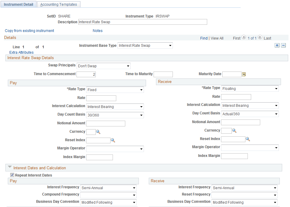

Entering Interest Rate Swap Instrument Details
Access the Instrument Detail page for an interest rate swap (Deal Management, and then Administer Deals, and then Define Instruments).
This example illustrates the fields and controls on the Instrument Detail page – for an interest rate swap (1 of 3). You can find definitions for the fields and controls later on this page.
Instrument Detail page for an Interest Rate Swap (1 of 3)
This example illustrates the fields and controls on the Instrument Detail page – for an interest rate swap (2 of 3). You can find definitions for the fields and controls later on this page.
Instrument Detail page for an Interest Rate Swap (2 of 3)
This example illustrates the fields and controls on the Instrument Detail page – for an interest rate swap (3 of 3). You can find definitions for the fields and controls later on this page.
Instrument Detail page for an Interest Rate Swap (3 of 3)
Select Interest Rate Swap.
Important:
In configuring forward rate agreement instruments, do not select Discount to Yield from the Interest Calculation field drop-down menu, as these are not discount instrument types.
Selecting this check box causes calculation errors in any deals created from this instrument.
Interest Rate Swap Details
Swap Principals
Select when to swap principals. Certain field values require a corresponding accounting template to ensure correct cash flow processing. Values are:
  • At Commencement
  • At Commencement & Maturity
    If you select At Commencement & Maturity, you must also specify the IRSPS-PERPMT-L2 accounting template.
  • At Maturity
  • Don't Swap
    If you select Don't Swap, also select the IRSPS-PERPMT-L1 accounting template.
See Understanding Interest Rate Swap Cash Flows and Accounting Templates.
Time to Commencement
Enter the number of actual days or number of business days from the trade date to the effective date of the swap.
Time to Maturity
Enter the number of actual days from the commencement date (or trade date) to the maturity date of the swap.
Maturity Date
Enter the date of termination for the underlying swap transaction.
Interest Dates and Calculations
Select if the interest rate swap has multiple interest cash flows (a swap). Deselect if the interest rate swap has a single interest cash flow (for example, a forward rate agreement).
Pay/Receive
Fields for interest rate swaps exist for both the Pay and Receive regions, but they are discussed only once in this section. Data entry for both sets of fields is required.
Notional Amount
Enter the specified monetary amount for this instrument. This amount is the principal amount on which the exchanged interest payment calculations are based for an interest rate swap.
Compound Frequency
Define at what interval the interest compounds.

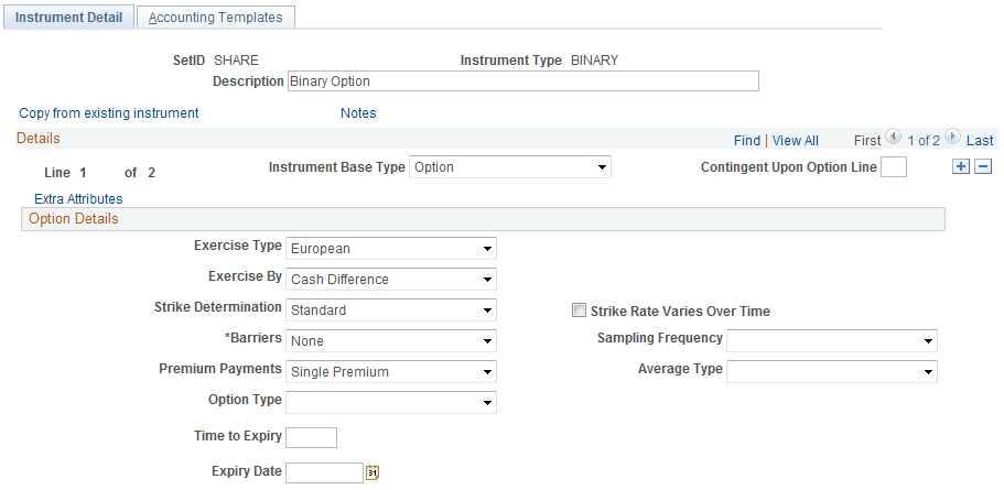

Entering Option and Option - Binary Payoff Instrument Details
Access the Instrument Detail page for an option or an option - binary payoff (Deal Management, and then Administer Deals, and then Define Instruments).
This example illustrates the fields and controls on the Instrument Detail page – for options - binary payoff (1 of 2). You can find definitions for the fields and controls later on this page.
Instrument Detail page for a Binary Option (Line 1 of 2)
This example illustrates the fields and controls on the Instrument Detail page – for options - binary payoff (2 of 2). You can find definitions for the fields and controls later on this page.
Instrument Detail page for a Binary Option (Line 2 of 2)
This section discusses instrument details for both options and options - binary payoff. Use the options - binary payoff instrument base type in conjunction with the option instrument base type to enter binary options (also called digital options). The application pages for these instruments are identical with the exception of the additional Binary Option Details section. In the example above, Details Line 1 of 2 is an option, and line 2 of 2 is an option - binary payoff.
Option Details
Select Option.
Contingent Upon Option Line
Use to associate an option with its underlying payoff transactions. Enter the line number of the option detail line of each payoff transaction or the detail line that is contingent upon the exercise of the option.
For example, suppose that line 2 is contingent on line 1, you enter 1 in the Contingent Upon Option Line field for line 3.
Exercise Type
Select an exercise type. Values are:
American: Can be exercised on any date between the start date and expiry date.
European: Can be exercised only on the expiry date.
Bermudan: Can be exercised on a predefined range of dates.
Exercise by
Select from the following values:
Cash Difference: Settles the option by the cash difference.
Delivery of Payoff: The payoff transaction is dealt at the specified payoff transaction rate.
Strike Determination
Select the price determinant to apply to the payment that is due. Some options require sampled historical prices or rates to determine their payoffs. For example, an Asian option with monthly sampling uses monthly data point to determine the average underlying price.
The options are:
Asian - Average Price: Pays the difference between the average underlying price over a specified period and the strike price. This option requires sampled historical prices or rates to determine the payoff. Enter values for Sampling Frequency and Average Type.
Asian - Average Strike: Pays the difference between the underlying price and an average strike price over a specified period. This option requires sampled historical prices or rates to determine the payoff. Enter values for Sampling Frequency and Average Type.
Hindsight: Pays the holder the best payoff between the spot price, sampled over time, and the fixed strike price. This option requires sampled historical prices or rates to determine the payoff. Enter a value for Sampling Frequency.
Lookback: Pays the holder of a call the difference between the spot price at maturity and the lowest spot price over an observation period. The payoff for a put is the highest spot price observed, less the spot price at maturity. This option requires sampled historical prices or rates to determine the payoff. Enter a value for Sampling Frequency.
Standard: Provides the holder the right to purchase or sell the underlying asset at a specific price on or before a specified date.
Strike Rate Varies Over Time
Select to enable the Strike Rate field on the Deal Detail page during deal capture. The Strike Rate Varies Over Time check box is available only for American or Bermudan exercise types.
Barriers
If you select Single, the Barriers button becomes enabled at deal capture, and a single Barrier row appears; if you select Double, two barrier rows appear at deal capture.
Sampling Frequency
Define the time interval between taking your first sample price and taking your second sample price. To compute an average for this field, select from the following values:
Continuous: Assumes that prices are being averaged on a continuous, real-time basis.
Daily: Assumes that price sampling is being performed on a daily basis.
Monthly: Assumes that prices are being taken on a monthly basis.
Weekly: Assumes that price sampling occurs every seven days.
Premium Payments
Select Single Premium to enable a premium payment row at deal capture. Select Multiple Premiums to enable multiple premium payment rows at deal capture.
Average Type
If the value of the Strike Determination field is Asian - Average Price or Asian - Average Strike, then select the average type to determine what method to employ for calculating an average for the selected sampling frequency. Values are:
Arithmetic: Assumes that a price is sampled at finite points in time.
Geometric: Assumes that a price is sampled on a continuous basis.
Option Type
If the payoff transaction (the Instrument Detail line that has this option in the Contingent Upon Option Line field) is an interest rate swap, then specify the type for this option. Select Cap/Floor or Swaption to determine how the option affects the swap:
Cap/Floor: Applies the option individually to each interest period. Upon exercise, exercise only the current interest period, and the option remains static for the remaining periods.
Swaption: Applies the option to the entire swap. Upon exercise, the option expires, and the swap becomes active.
Time to Expiry
Enter the number of days until the option expires.
Expiry Date
Enter the last day that the option can be exercised. The date that you enter here is automatically assigned the to the same field on the Deal Detail page for a deal with an instrument base type of option.
Amount
Enter the amount of the payoff.
Use the Instrument Extra Attributes page (INSTR_ADHOC_ATR) to assign extra notational attributes to your instrument.
Navigation:
Click the Extra Attributes link on the Instrument Detail page.
This example illustrates the fields and controls on the Instrument Extra Attributes page. You can find definitions for the fields and controls later on this page.
If the delivered instrument component does not contain all the data fields that you require, you can define extra fields to capture this data. These extra attribute fields appear on the Deal Capture component and are memo-only fields that are not used in any deal processing.
Attribute
Enter a five-character, alphanumeric code for the attribute.
Attribute Type
Specify a value: Date, Market Rate, Small Integer, or Small Character.
Short Name
Enter a name for the attribute.
