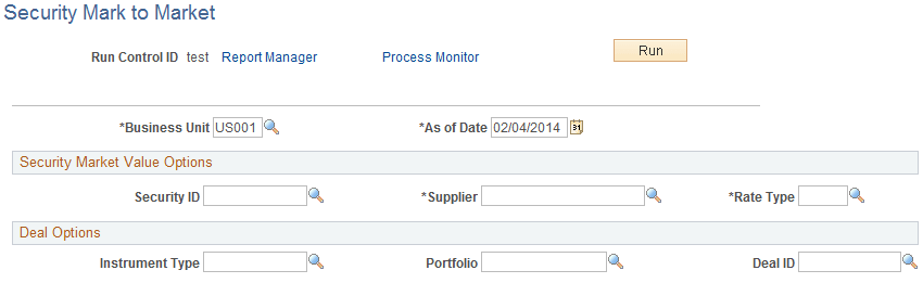

Security Mark to Market Page
Use the Security Mark to Market page (TR_SEC_MTM_RUNCNTL) to run the Security Mark-to-Market Application Engine process (TR_SEC_MTM) to generate reevaluated rates and update the current market value and book value of securities involved in your current deals.
Navigation:
Deal Management, and then Process Deals, and then Security Mark to Market
This example illustrates the fields and controls on the Security Mark to Market page.
