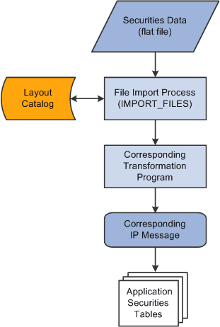

This diagram illustrates the securities data import process.
This diagram illustrates the steps in the securities data import process, which is described in detail following the diagram
Securities data import process
The securities data import process involves the following steps:
  1. An administrator enters information pertaining to a securities data file in comma-separated value (.csv), flat-file format.
    This initiates the File Import Application Engine process (IMPORT_FILES), which functions as an interface or shell to define the necessary commands for the system to import the securities data files.
  2. The File Import Application Engine reads the file's layout definition data (which is stored in the Layout Catalog) and calls the corresponding transformation process.
    The layout for importing securities definition data is SECURITY and the corresponding transformation process called is TRX_SECD_XFM. For importing security market value, the SEC_MARKET layout is used with the TRX_SECM_XFM transformation process.
  3. The transformation Application Engine loads the data into the securities application tables using the TRX_SEC_HDR IP message for securities definition data or the TRX_SEC_MKTVAL IP message for security market values.

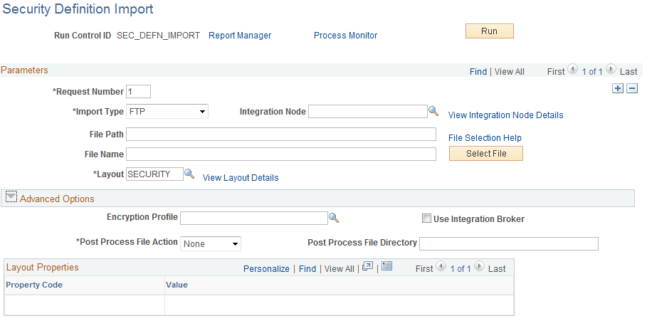

This example illustrates the fields and controls on the Security Definition Import page. You can find definitions for the fields and controls later on this page.
The field descriptions provided here are the same for both the Security Definition Import page and Security Market Values Import page.
Field or Control Description
Import Type
Select the method to import the bank statement data. Options are:
  • FTP: Select if you are importing the file by using file transfer protocol, and enter a node through which to transfer the data.
  • File: Select if you are importing a file, and complete the File Path and File Name fields.
  • HTTP: Select if you are importing a file using a URL that is included as part of the node configuration. No file path or file name is required.
Integration Node
Enter the integration node to use to transfer the data. This field appears only if FTP or HTTP is selected in the Import Type field.
See PeopleTools: Integration Broker, "Building Message Schemas."
See PeopleTools: Integration Broker Administration, "Using Listening Connectors and Target Connectors," Working With the AS2 Connectors.
See PeopleSoft Financial Gateway: Defining Integration Broker Settings for Bank Statements and Payment Acknowledgments.
View Integration Node Details
Click to access the Integration Node Details page and review property details of the selected node. This link appears only if FTP or HTTP is selected in the Import Type field.
File Location
Appears when using the File import type only. Displays the file location entered on the configuration page by a bank integration administrator. Users have access only to the folders below the base path displayed in the File Location field.
For more information, see PeopleSoft Banks Setup and Processing: Managing Import File Locations.
File Path
Enter a file path according to the import type selected:
  • File Import Type: Leave this field blank to select a file in the base path shown in the File Location field, or enter a folder name with trailing backslash below the base path, for example, /Bank02/.
    Wildcard characters are not supported when using the File import type.
  • FTP Import Type: Enter the complete file path location. To select files by using the Select File button, you must include a trailing backslash (\) in the file path.
    You can you can also load all files in a given directory by using the *.* notation or search for files of a specific type by entering an asterisk and the extension suffix. For example, to search all files with an .xxx suffix, enter \*.xxx.
  • HTTP Import Type: Does not require a file path and the field is unavailable.
Note:Be sure that the application server and the Process Scheduler have access to the directory, FTP node, or HTTP node where the files are staged for import.
File Selection Help
Click to view help information about specifying file paths and file names.
File Name
Enter the specific file to import or click the Select File button to search for a file. If you want to import multiple files based on extension for the FTP import type, leave this field blank.
Layout
Select the file layout for the type of security data being imported.
  • SECURITY: For importing securities definition data.
  • SEC_MARKET: For importing security market values data.
Advanced Options
Encryption Profile
Select an encryption profile to decrypt bank statements. Encryption profiles contain both encryption and decryption information.
Use Integration Broker
Select to lay out the files and publish the formatted document to PeopleSoft Integration Broker. Integration Broker then processes the formatted file accordingly.
You select this option if you want to use the financial sanctions information as a trigger to Integration Broker to perform other processes, or to integrate with other systems.
Post Process File Action
Select what action, if any, to perform on the bank statement files after the data has been processed. The options are:
  • Copy: Copy the file to the directory that is entered in the Post Process File Directory field.
  • Delete: Delete the file after the data in it is processed.
  • Move: Move the file to the directory that is entered in the Post Process File Directory field.
  • None: Take no action.
Enter a file path to the directory to which the file will be moved or copied if either option is selected as the post process file action.
Layout Properties
Value
Property codes and values appear by default from values that are defined on the selected layout ID.
If you configure unique code mappings for a layout (on the Code Mappings page), you need to modify the displayed CODE_MAP_GROUP value with the appropriate unique map value.
See PeopleSoft Financial Gateway: Code Mappings Page.
