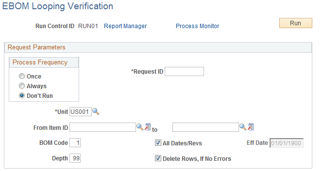

EBOM Looping Verification Page
Use the EBOM Looping Verification page (EN_BOM_VERIFY_REQ) to check EBOMs for unwanted loops.
Navigation:
Engineering, and then BOMs and Revisions, and then Identify Looping EBOMs, and then EBOM Looping Verification
This example illustrates the fields and controls on the EBOM Looping Verification page. You can find definitions for the fields and controls later on this page.
Field or Control Description
BOM Code
Enter the code for the BOM that you want to verify.
Depth
Determine how many levels to verify.
Delete Rows, If No Errors
Select to delete BOM explosion table records. The verification request process adds a series of records to the BOM Explosion table. These records take up space and are useless, if there are no looping BOMs. You can also use the Delete Verification Details page to save space.
The EBOM verification COBOL SQL process (ENPBEXPV) checks for loops within EBOM structures only. Once you copy the EBOM to manufacturing, run the BOM verification within PeopleSoft Manufacturing to verify the BOM within manufacturing.
Instead of running this process, you can use Online BOM Verification to check for loops. You set the Online BOM Verification option at the manufacturing business unit level with the MFG Business Unit Options page. However, to improve BOM maintenance performance when BOMs are complex and deep, use the scheduled verification process and set Online BOM Verification to Never Verify Online.
EBOM Looping Verification looks at just the primary EBOM and routing, when exploding at levels greater than 1. If there is more than one way to make a specific co-product output, tell the system which EBOM is the primary way to make that co-product and, therefore, which EBOM to verify for that co-product. To tell the system which EBOM to verify, select an associated primary BOM on the Define Business Unit Item - Manufacturing: General page.
Both MBOMs and EBOMs use the same associated primary; there isn't one specific to MBOMs.

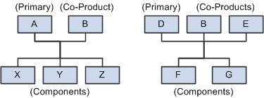

Output Example
The following diagram illustrates how two different processes could have the same output. In this example, B is an output on two different processes:
BOM Output Example
BOM Output Example
Consider the two structures:
  • In the first structure, A is the primary (item), with B as the co-product, and X, Y, and Z are components.
  • In the second structure, D is the primary, and B and E are co-products, with F and G as the components.
Because there are two ways to make the same product (B), you need to decide which structure to use when exploding to lower levels. Therefore, you need to signify a primary structure associated with each item that may exist as a co-product, but not as a primary. To do this, assign an associated primary EBOM.
When exploding to lower levels, the system checks whether there is an associated primary defined for this item. If there is an associated primary item, the system uses it to explode to lower levels.
If exploding EBOM code 2 for the co-product, and an associated primary was defined, then the system uses EBOM code 2 for the associated primary, also.
For instance, if the system is exploding B (in the diagram) for EBOM code 2, and A is the associated primary, then the system looks for an item with an EBOM code 2 to explode. If EBOM code 2 doesn't exist for A, then the explosion stops for this item, and the system generates an error. This same logic is used for BOM verification, inquiries, and costing.

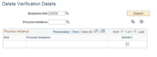

Delete Verification Details Page
Use the Delete Verification Details page (EN_BOM_VERIF_DEL) to delete records created by the EBOM Verification Request process (ENPBEXPV) by process instance.
Navigation:
Engineering, and then BOMs and Revisions, and then Identify Looping EBOMs, and then Delete BOM Verification Detail
This example illustrates the fields and controls on the Delete Verification Details page. You can find definitions for the fields and controls later on this page.
The verification request process adds a series of records to the BOM Explosion table. These records take up space and are useless if there are no looping BOMs. You can use this page to delete these records by process instance.

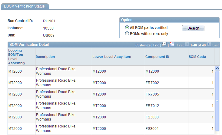

EBOM Verification Status Page
Use the EBOM Verification Status page (EN_BOM_VERIFY_STAT) to view, on a summary level, a list of all verified EBOMs or a list of all looping EBOMs discovered as a result of running the Verification Request page.
Navigation:
Engineering, and then BOMs and Revisions, and then Identify Looping EBOMs, and then EBOM Verification Status
This example illustrates the fields and controls on the EBOM Verification Status page. You can find definitions for the fields and controls later on this page.
All BOM paths verified
Select to enable the system to display all verified BOMs by top-level assembly.
BOMs with errors only
Select to enable the system to display all looping BOMs, along with the specific looping lower-level assembly and component items.
Search
Click to check for looping BOMs. If the system does not detect any loops, a message appears. If the system detects any looping BOMs, they appear at the bottom of this page.
Details
Click for any top-level assembly with errors to access the BOM Verification Detail page.
