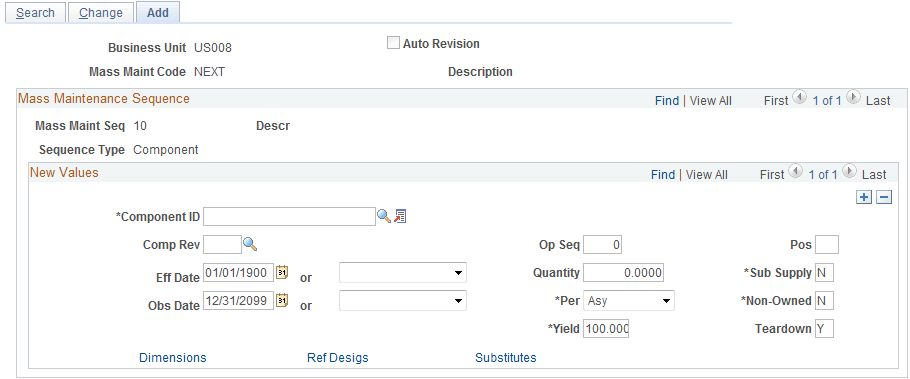

BOM Mass Maintenance Codes - Add Page
EN_BOM_MMC_ADD
Add components or outputs to assemblies. The system adds these components or outputs to each BOM identified by the values that you entered on the Search page. Use the Process BOM Mass Maintenance pages to designate, at a later time, the assemblies to be affected by these changes.

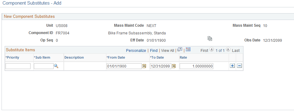

Component Substitutes - Add Page
EN_BOM_MMC_SUB3_SP
Add a substitute everywhere that it is required.

  3. Add the new component information on the BOM Mass Maintenance Codes - Add page, including required information, such as operation sequence and effective date for the new component.
  4. Add additional component information with the dimensions, reference designator, or substitutes links, as required.

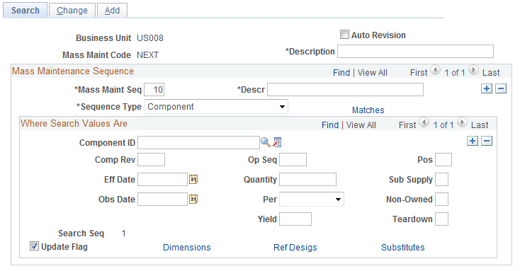

BOM Mass Maintenance Codes - Search Page
Use the BOM Mass Maintenance Codes - Search page (EN_BOM_MMC_SRCH) to identify outputs or components, and therefore BOMs, to change.
Navigation:
Engineering, and then BOMs and Revisions, and then EBOM Mass Changes, and then BOM Mass Maintenance Codes, and then Search
This example illustrates the fields and controls on the BOM Mass Maintenance Codes - Search page. You can find definitions for the fields and controls later on this page.
Before you associate changes or additions to an MMC, identify the outputs, components, or component revisions (and, therefore, BOMs) to change. When adding components, use this page to further identify the BOMs to which the new component should be added. For example, you may want to add component ID LT5001 only to BOMs that already have a component ID called LT5000 and a 12/31/97 obsolete date, or perhaps where you already have component ID LT5000 and LT5001 defined. Similarly, you can use this page to further identify the BOMs to which the new output should be added.
In this component, the fields that you see vary depending on your selection in the Sequence Type field. The page examples in this section are based on selecting Component in the Sequence Type field. If you select Output, the system doesn't display the Component ID, Component Rev (component revision), Quantity, Yield, Pos (position), Sub Supply (supplied by subcontractor), Non-Owned, and Teardown fields. It also doesn't display the Dimensions, Ref Desigs (reference designators), and Substitutes links. Instead, it displays the Output Item, Output Type, Output Qty (output quantity), Res % (resource allocation percentage), and Cost % (cost allocation percentage) fields.
You may want to universally change the status of or add a new substitute item. You can search for substitutes by item or substitute. You can also search by item and substitute. To search for an item or substitute only, enter the original or substitute item in the Component ID field.
To search by both original and substitute, enter the original item in the Component ID field and click the Substitutes link.
Field or Control Description
Auto Revision
Select to apply, for this mass maintenance code, schemes that automatically update revisions when a change event occurs. You generate the automatic revisions when you run the mass maintenance functionality, either by using mass maintenance by ECO or BOM Mass Maintenance by MMC process. When selecting this check box and then specifying the MMC on the ECO and item, you indicate that a revision will be created for the ECO item. You cannot override the Rev Up check box on the ECO.
Mass Maint Seq (mass maintenance sequence) and Descr (description)
Enter a mass maintenance sequence number and its description. The mass maintenance sequence number enables you to set up more than one set of changes for a single MMC.
Note: The maximum number of sequence numbers that you can enter for an MMC is 20.
You can use sequence numbers to set up or conditions. For example, to change BOM components where the current component ID is LT5000 or LT5001, create one sequence where the component ID is LT5000 and a second sequence where the component ID is LT5001. The system applies designated changes in the sequence number order.
Note: Each change sequence applies to the original BOM, not to the BOM as it would look after previous sequences have been applied.
Sequence Type
Select Component or Output.
If you select Component, enter the component search values. This optionally includes standard BOM fields, such as Component ID, Comp Rev (component revision), operation sequence, effective and obsolete dates, and quantity per. The system searches for values that meet all the criteria that you enter.
Note: The effective date and obsolete date that you enter indicate the precise date on which the component becomes effective or obsolete on the BOM.
If you select Output as your sequence type, then you can select the output item and output type. You can also enter an output quantity, resource percentage, and cost allocation percentage.
If you don't want to change a component, then leave the Component ID field blank, and select criteria based on the other fields. If you leave any field on this page blank, the system searches for BOM components without considering the blank search field. For example, if you leave Component ID blank and enter a yield of 50, then all components with a yield of 50 are selected.
To search for multiple components or outputs within a sequence, use the Where Search Values Area group box to enter and searches for more than one component or output on a BOM.
Update Flag
While searching for BOMs that contain multiple components or outputs, you may want to make changes only to a subset of all components or outputs. Select this check box to indicate which components or outputs that you want updated by the mass maintenance process.

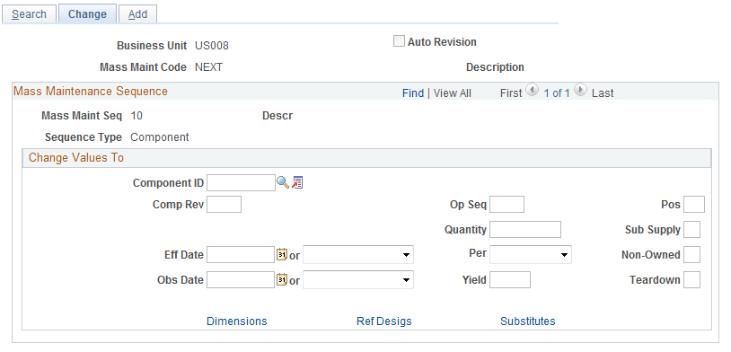

BOM Mass Maintenance Codes - Change Page
Use the BOM Mass Maintenance Codes - Change page (EN_BOM_MMC_NEW) to specify new component values, after you have selected the set of components that you want to change using the Search page.
Navigation:
Engineering, and then BOMs and Revisions, and then EBOM Mass Changes, and then BOM Mass Maintenance Codes, and then Change
This example illustrates the fields and controls on the BOM Mass Maintenance Codes - Change page. You can find definitions for the fields and controls later on this page.
Component ID
Enter a new value if you intend to change the component ID field.
Note: This is typically done for correcting BOMs. To keep history of a component change, do not enter a value here.
Output Item and Output Type
If you selected Output, enter the required output change-to data on this page. The effectivity dates operate the same as they do for a component sequence type.

Component Dimensions - Change Page
Use the Component Dimensions - Change page (EN_BOM_MMC_DIM2_SP) to make mass changes to component dimensions.
Navigation:
Click the Dimensions link on the BOM Mass Maintenance Codes - Change page.
Enter the existing dimension on the Component Dimensions - Search page (optional), and then enter a new value on the Component Dimensions - Change page. Entering the existing dimension on the Component Dimensions - Search page is necessary only when it must be part of the search criteria. For example, to change the weight for all occurrences of component LT5000 to 10, then enter 10 on the Component Dimensions - Change page. If this value should be changed only where its current weight is 9, then enter 9 on the Component Dimensions - Search page and 10 on the Component Dimensions - Change page.
Use the BOM Mass Maintenance Codes - Add page (EN_BOM_MMC_ADD) to add components or outputs to assemblies.
Navigation:
Engineering, and then BOMs and Revisions, and then EBOM Mass Changes, and then BOM Mass Maintenance Codes, and then Add
This example illustrates the fields and controls on the BOM Mass Maintenance Codes - Add page. You can find definitions for the fields and controls later on this page.
Automatic revision is operative only for items that are defined as using automatic revisions on the Define Business Unit Item - Manufacturing: General page. The system uses the ECO schedule date to create revisions when mass maintenance is used in conjunction with an ECO. It uses the run date of the mass maintenance process to create revisions when mass maintenance is run as a standalone.
Component ID
You must select a component if you selected a sequence type of Component on the BOM Mass Maintenance Codes - Search page.
Enter associated values that you want to add to the selected BOMs that meet the search criteria specified on the BOM Mass Maintenance Codes - Search page.
You can add multiple components per MMC.
You can also add a placeholder item as a component. If the MMC is later applied to manufacturing BOMs that don't allow placeholders, then the process flags that BOM change as an exception, and the BOM won't be changed.
If you selected a sequence type of Output on the BOM Mass Maintenance - Search page, enter values and any additional required output data.
The values that you select on these pages are subject to the same validation checks that apply to any engineering BOM or manufacturing BOM component or output values. Some of these checks occur when you create the MMC, and the remaining validation checks occur at the time that the MMC is applied.
Use the Component Substitutes - Add page (EN_BOM_MMC_SUB3_SP) to add a substitute everywhere that it is required.
Navigation:
Click the Substitutes link on the BOM Mass Maintenance Codes - Add page.
This example illustrates the fields and controls on the Component Substitutes - Add page. You can find definitions for the fields and controls later on this page.
Copy Substitute button
Click the Copy Substitute button to display all valid substitute items for the business unit.
OK
Click this button to add all valid substitute items for the business unit.
If you don't want to add all valid substitute items for the business unit, enter each individual substitute item that you want to add, as well as the priority, from date, to date, and conversion rate for each substitute.
Substitute items must be unique for the item. You cannot enter the same item twice as a substitute with different dates. For example, substitute A with effective dates from 01/01/99 to 02/01/99 and substitute A with effective dates from 02/01/00 to 08/30/00 couldn't be substitutes for the same item. In this case, define a different substitute for the second set of effective dates.
