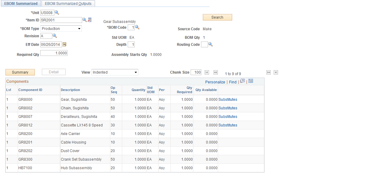

This example illustrates the fields and controls on the EBOM Summarized page. You can find definitions for the fields and controls later on this page.

Unit, Item ID, BOM Type, BOM Code, Eff Date, and Revision
Select information to specify the BOM that you want to display.
Search
Click to display the summarized BOM.
Required Qty (required quantity)
To determine the total number of each component required at all levels to produce a particular quantity of the assembly item, enter the required quantity for the assembly item. The system multiplies each component's quantity per assembly by this required quantity to determine the component required quantity displayed on the lower half of the page.
Click the Search button again to display the calculated required quantities.
To view a summarized BOM, enter a required quantity of 1.
Depth
Enter the BOM depth. If you select a depth of 1, this page displays only the top level of the BOM.
Note: You can select any valid BOM code, but regardless of the depth that you enter, the system calculates all lower levels based on the primary BOM code (1).
Routing Code
Select the appropriate routing for the item.
Assembly Starts Qty
Displays the beginning quantity required based on the required quantity. This amount accounts for any operation yield loss during the production process.
Summary
This button lists only the component ID, description, and quantity required, and summarizes the total required quantity for the component across all levels. The quantity required accounts for both component yield and operation yield. The current quantity available from business items attributes also appears.
Detail
This button provides data for all fields and enables the View field. You can view summary data either Indented or Non-Indented. The indented option provides an indented (tree) BOM structure for the selected depth.
You can toggle back and forth between summary and detail information.
The system sorts the summary alphanumerically by component ID for level 1 items and summarizes the displayed data by quantity, regardless of where the component occurs in the product structure.
When substitute items or multiple outputs exist for a component, those links appear following the Qty Available field.
