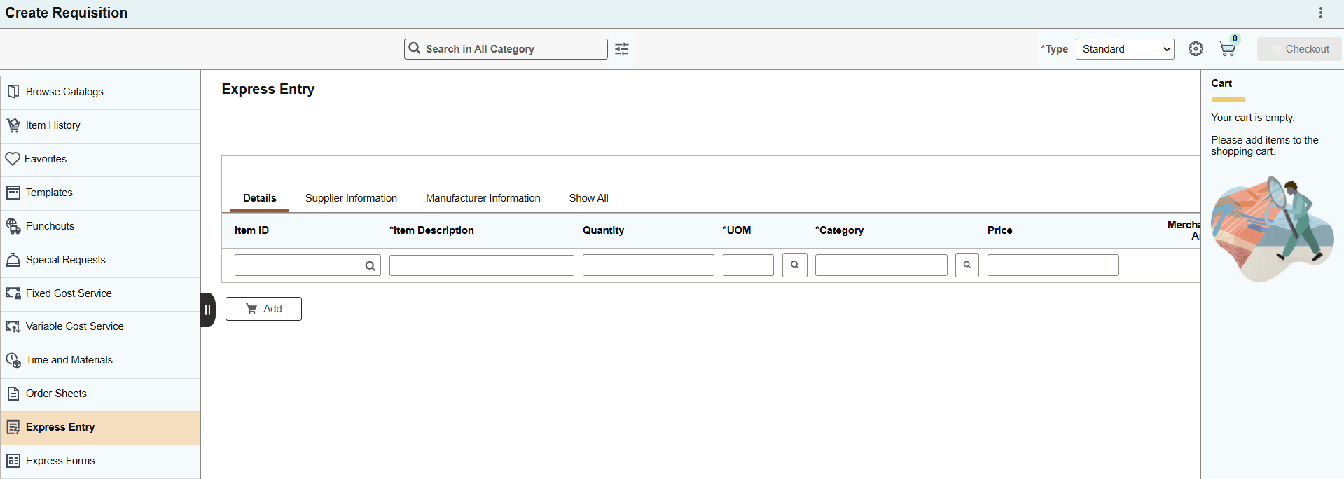

Select Express Entry.
This example illustrates the fields and controls on the Express Entry Page.
Express Entry
Field or Control Description
Details tab
Displays the Item ID, Item Description, Quantity, UOM, Category, Price, Merchandise Amount, and Currency fields. As you enter or select an item ID, the other details such as Item Description, Quantity, and UOM fields populates the default values defined. You can modify the quantity and UOM fields if required.
Note: If a category is configured as Amount Only, upon selecting that category for the Express Entry line, the quantity value is set to 1 and becomes display only for that line. For Amount Only lines, the Item ID field is also not available.
